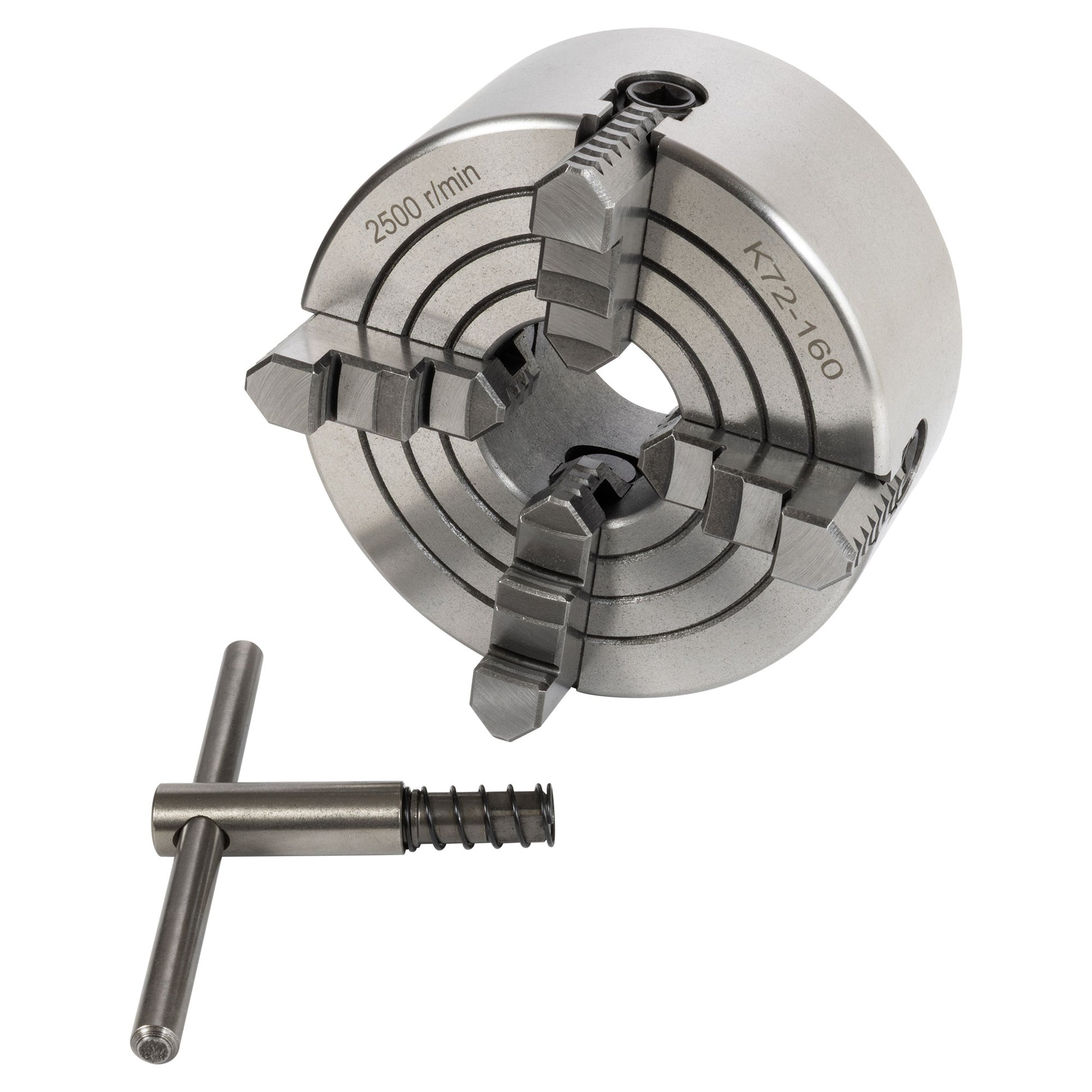

  • 4-jaw lathe chuck
  • 6" (160 mm) diameter
  • Each jaw is independently adjustable and reversible

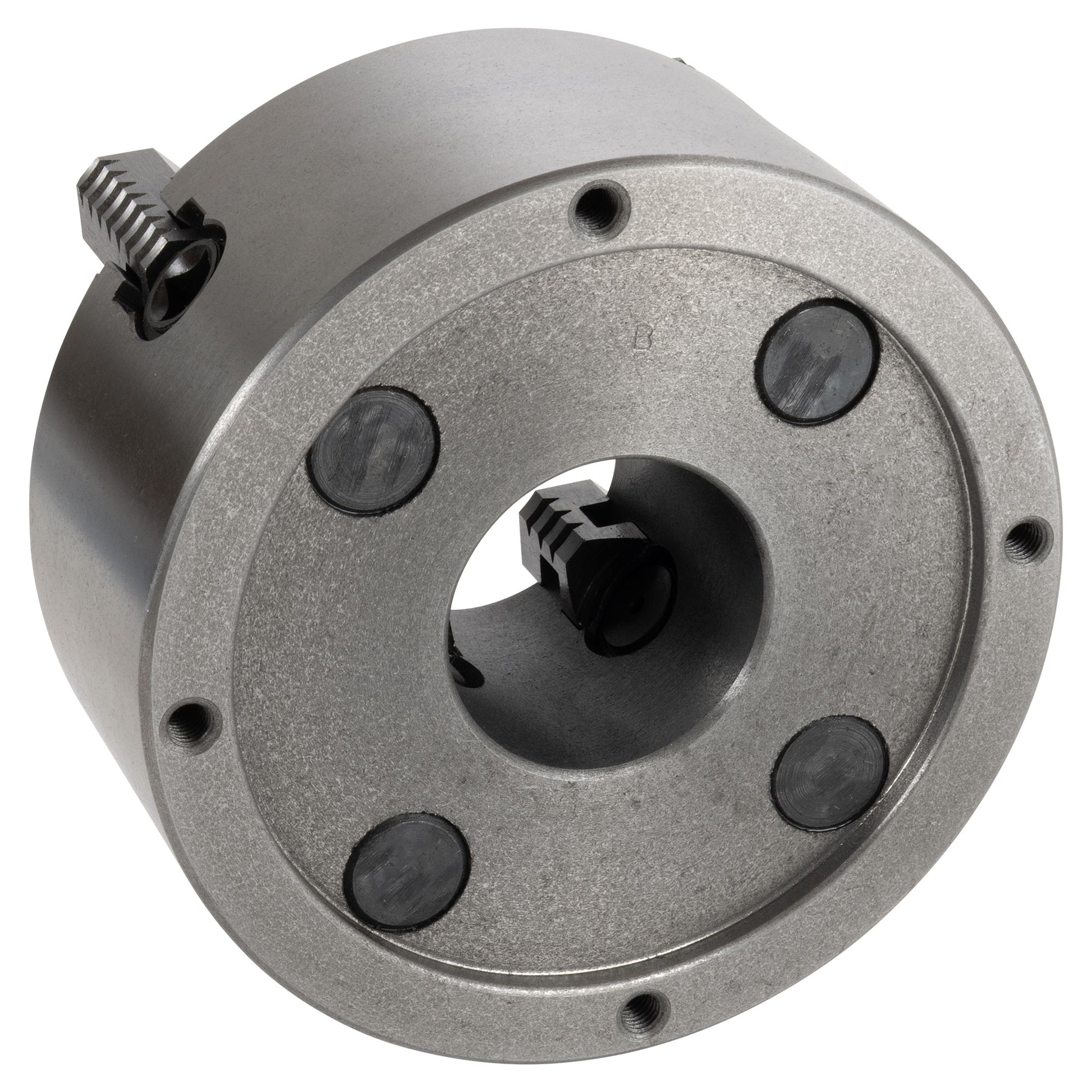

  • Plain back mounting, 4-hole mounting pattern
  • High quality steel, hardened and ground

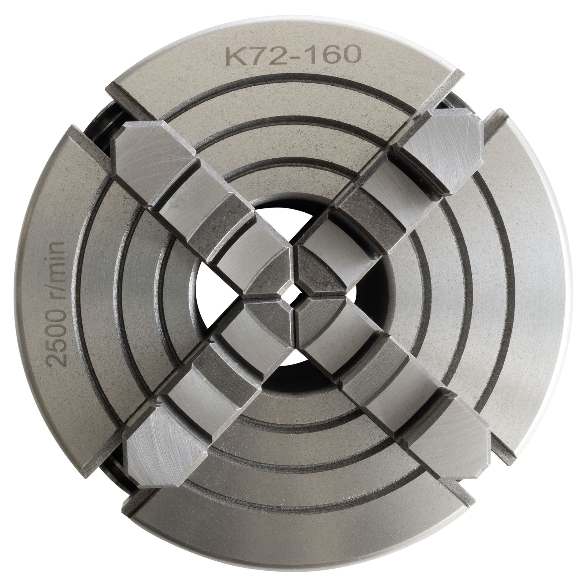

6 inch, 4-Jaw independent lathe chuck.
Each jaw is independently adjustable and reversible.
This chuck has a 1.77" (45.0 mm) through hole. The chuck can hold work up to 6.30" (160 mm) in diameter.

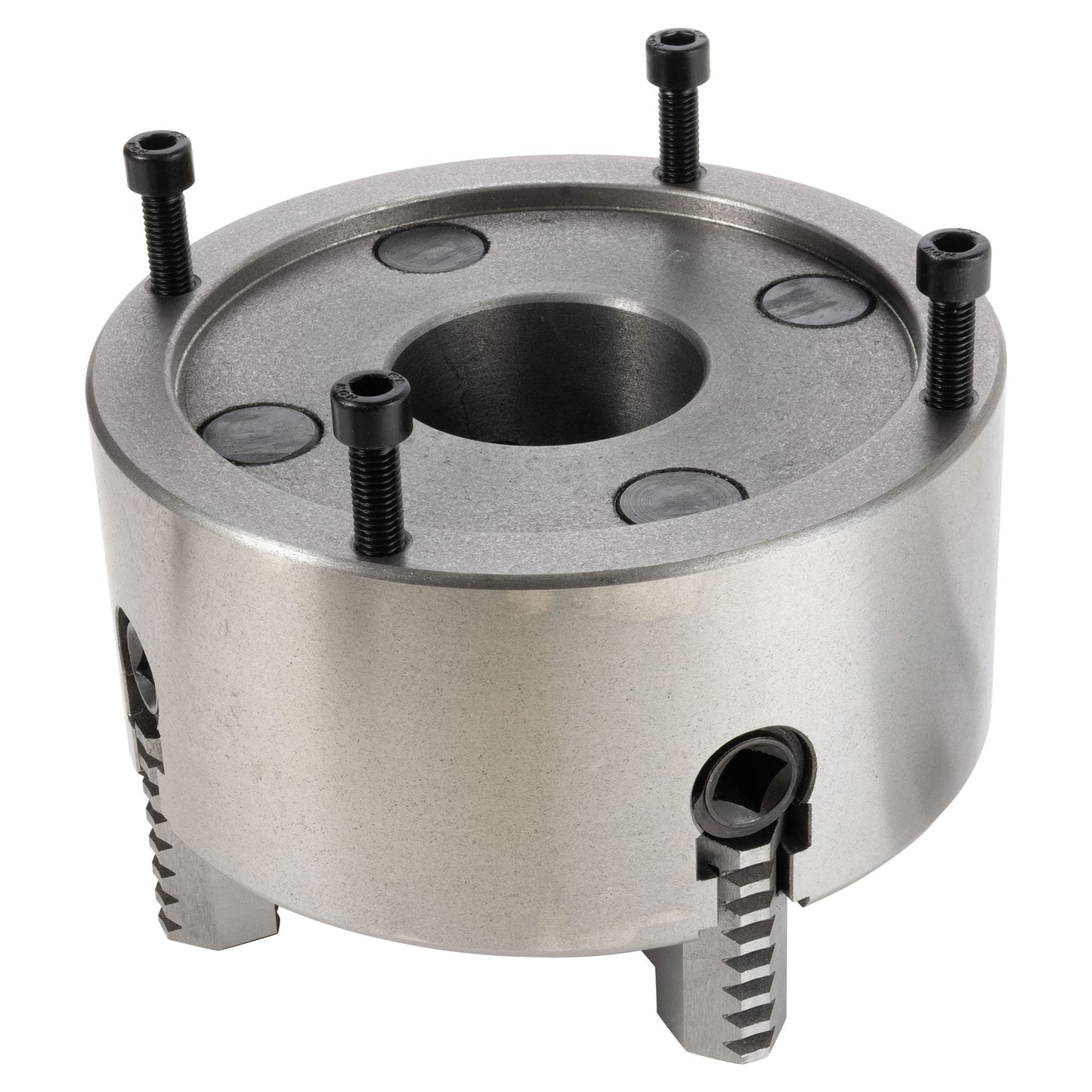

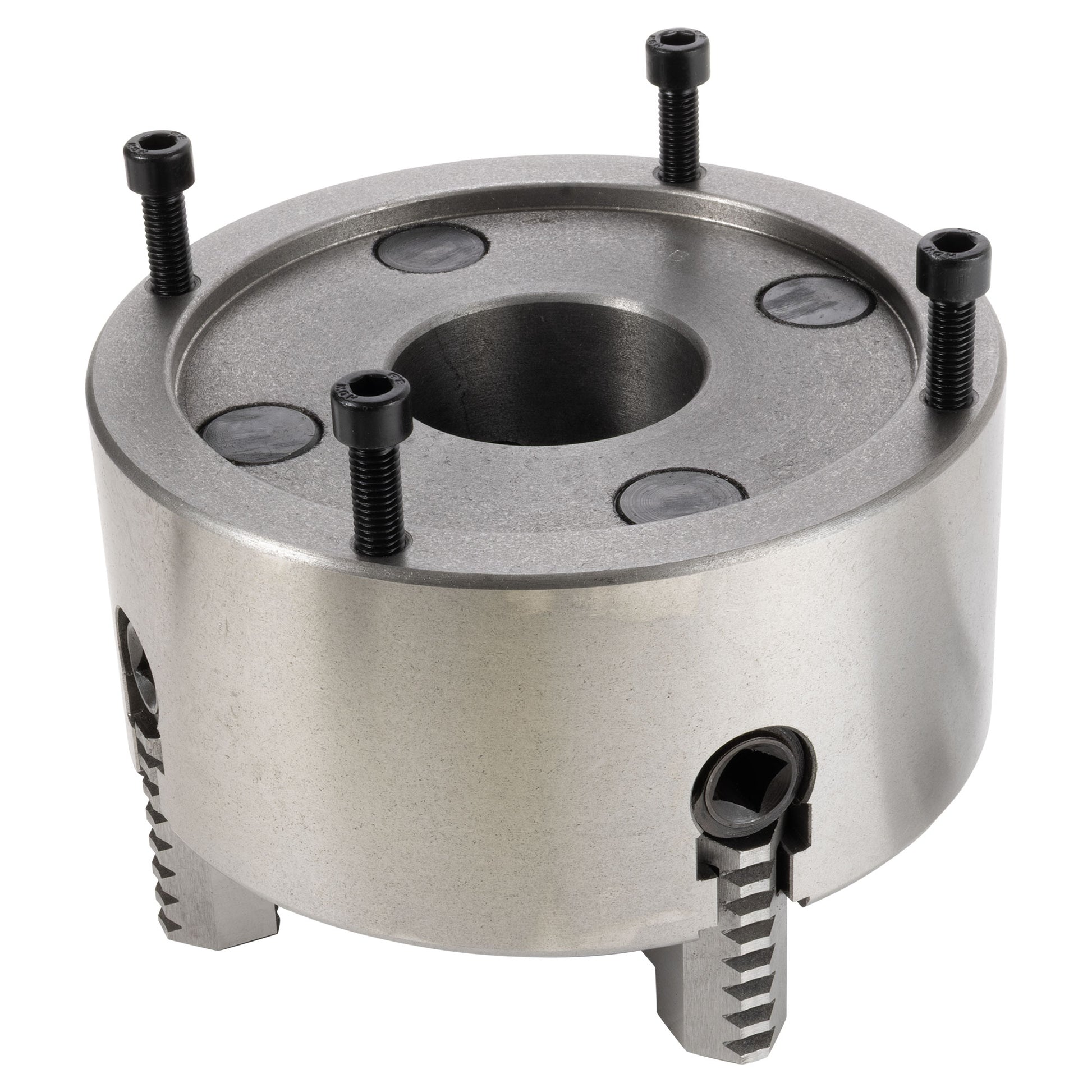

This is a plain back chuck and requires a backplate adapter to mount it.
*NOTE: * Note Don't forget to purchase a set of Studs & Nuts to accommodate changes in chuck or adapter configurations.
Mount this chuck on a mini lathe with one of our chuck adapters. Or purchase a chuck with an adapter already mounted.
