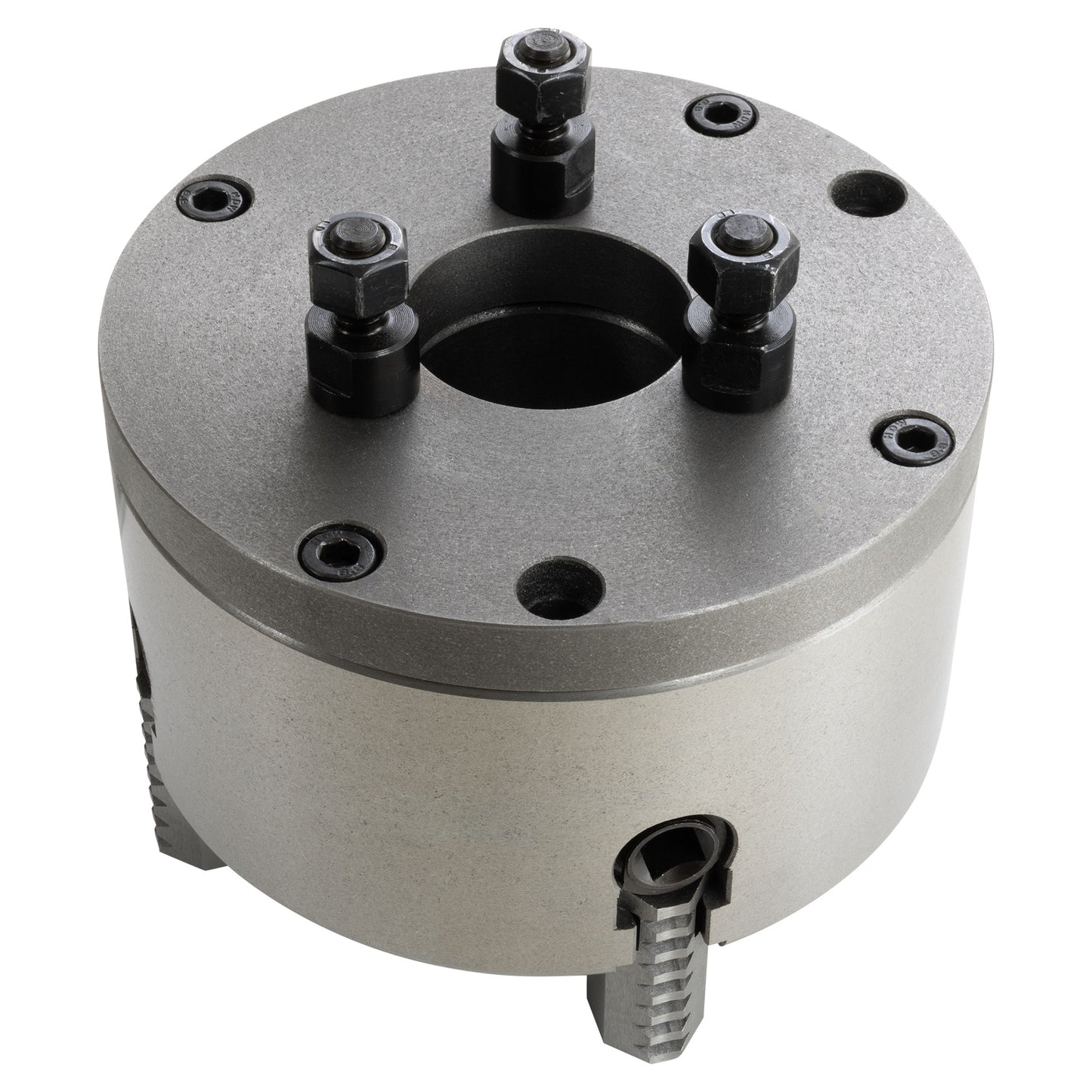

6", 3-jaw lathe chuck (2028) with adapter (4912) designed exclusively for the HiTorque 9x20 bench lathes models 7600 and 7650. Three mounting studs and nuts included.
Here is a chart that provides lathe chuck capacities and mounting dimensions.
Rated Capacity, Inside Jaws: 0.118" - 2.165" (3 mm - 55 mm)
Rated Capacity, Jamming Range: 1.969" - 6.299" (50 mm - 160 mm)
Rated Capacity, Outside Jaws: 2.165" - 5.709" (55 mm - 145 mm)
Runout (Max): ≤ 0.003" (0.081mm)
Diameter, Overall: 6.299" (160 mm)
Registration Recess Diameter: 5.118" (130 mm)
Registration Recess Depth: 0.197" (5 mm)
Bolt Circle Diameter: 5.591" (142 mm)
Center Hole Diameter: 1.575" (40 mm)
Height: 2.559" (65 mm)
Jaw Height Above Face: 1.181" (30 mm)
Height with Jaws: 3.740" (95 mm)
Number and Size of Bolts: 3 M8
Chuck Key: 0.374" (9.5 mm)
Max RPM: 2500 RPM
Chuck Designation: K11-160
