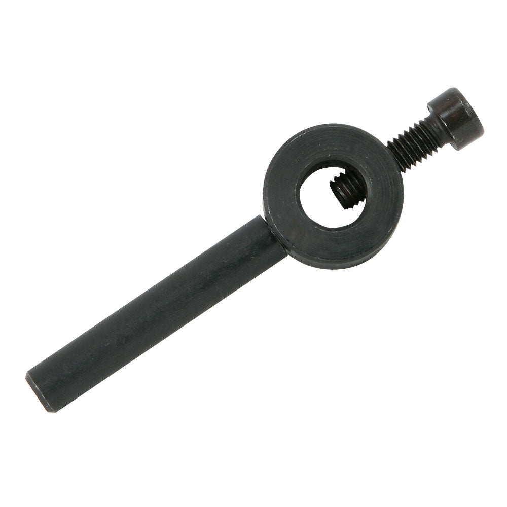

  • Straight tail lathe dog
  • 10 mm (0.39") workpiece capacity
  • Secure lathe dog rotation with lathe dog driver
Lathe dog for the mini lathe.
Use a lathe dog to drive the work when you are turning between centers.
This lathe dog has a workpiece capacity of 10 mm (0.39").
The photo shows how to use a lathe dog and drive pin with the mini lathe.
