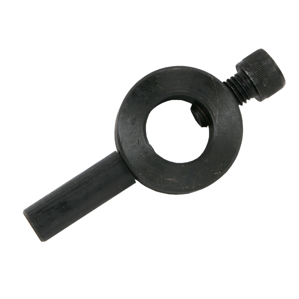

  • Straight tail lathe dog
  • 20 mm (0.79") workpiece capacity
  • Secure lathe dog rotation with lathe dog driver
Lathe dog for the mini lathe.
Use a lathe dog to drive the work when you are turning between centers.
This lathe dog has a workpiece capacity of 20 mm (0.79").
Secure lathe dog rotation with lathe dog driver.
The photo shows how to use a lathe dog and drive pin with the mini lathe.
