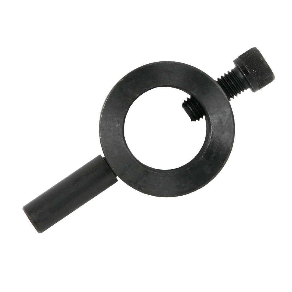

  • Straight tail lathe dog
  • 30 mm (1.18") workpiece capacity
  • Secure lathe dog rotation with lathe dog driver
Lathe dog for the mini lathe.
Use a lathe dog to drive the work when you are turning between centers.
This lathe dog has a workpiece capacity of 30 mm (1.18").
Secure lathe dog rotation with lathe dog driver.

The photo shows how to use a lathe dog and drive pin with the mini lathe.
Lathe Dog Use
Lathe dogs are the perfect solution for turning between centers. (That's where you mount a dead center in the headstock and another center -- usually a live center -- in the tailstock. You then mount the workpiece, which has a small divot machined into each end, between the centers.) To drive the workpiece, you place a lathe dog on it; the lathe dog is pushed around by a driver pin screwed in to a faceplate or the spindle, as shown above.
