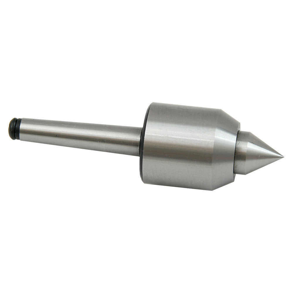

- Point is a 60º included angle
- Standard 1 Morse taper
- 1.39" diameter body
- Works with lathes with a 1 Morse taper tailstock taper
Live Center, 1 Morse taper shank.
This center is made from hardened steel and ground for accuracy. It has precision high quality bearings. The point is a 60º included angle.
The maximum diameter of the point is 0.71". The OD of the body is 1.39". The distance from the tip to the front of the body is 0.71".
The rated radial load is 66 lbs. The maximum speed is 4000 RPM. The runout is 0.0003".
