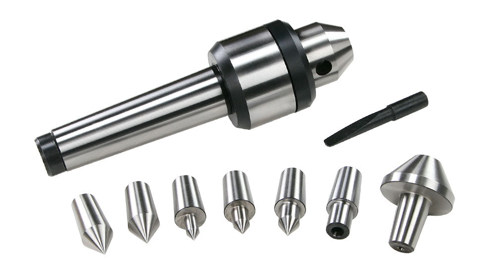

  • 7 live center points
  • Precision needle and thrust bearings
  • Bull nose and conical tips
This live center set gives you lots of options to support large and small parts. There are five 60 degree live center tips of four different diameters. There are two of the largest "standard" center.
- The 60 degree centers range in diameter from 0.22 to 0.53" (5.5 to 13.5 mm).
- The 60 degree conical center is for pointed work pieces.
- The "bull nose" center is 1.22" (31 mm) in diameter.
- 1 Pipe Center and 1 Female Center
- There is a tapered pin to pop the tips out of the live center.
Body is constructed from hardened and ground steel. Assembled with three bearings. Eccentricity between .005 - .010 μ. Comes in a fitted case.
