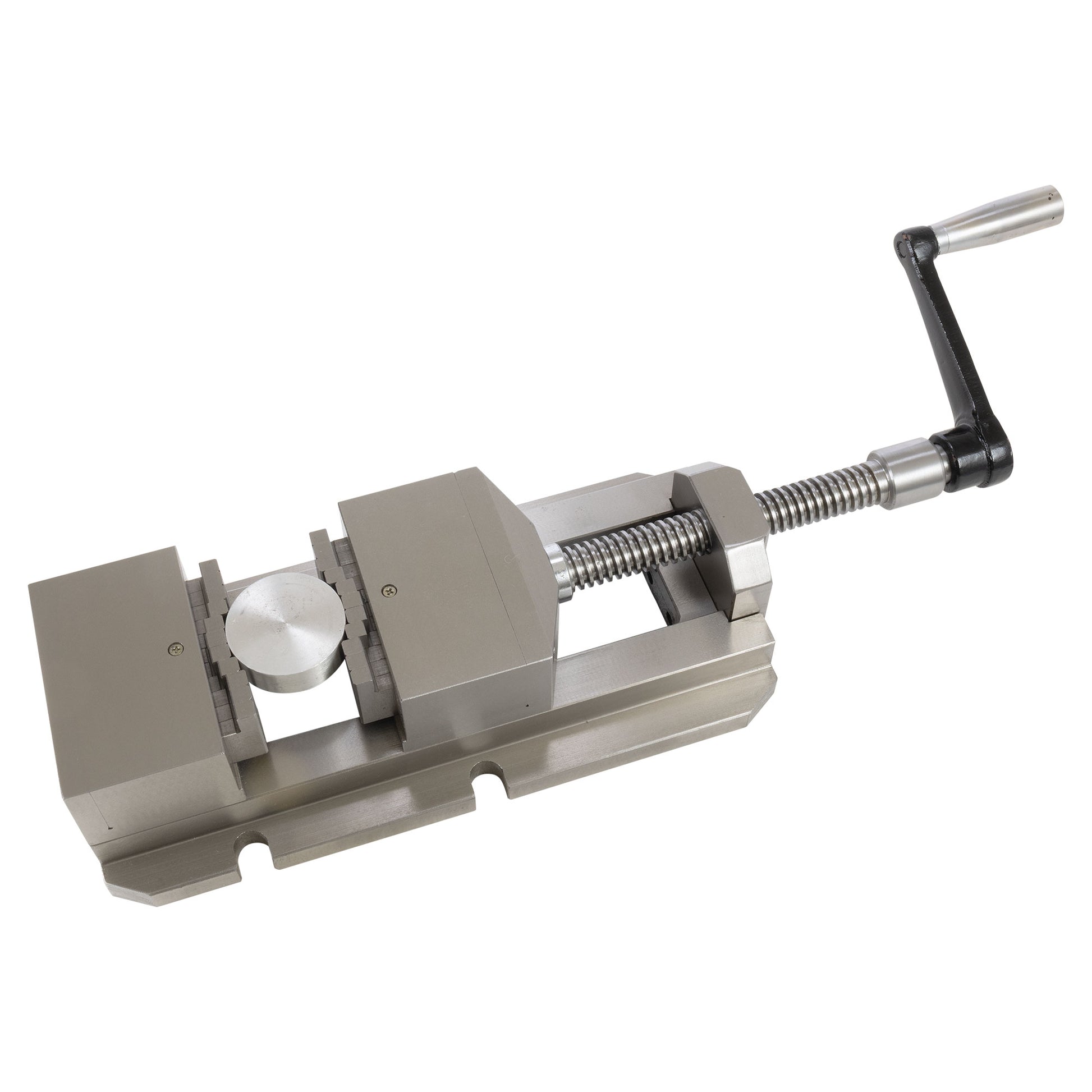

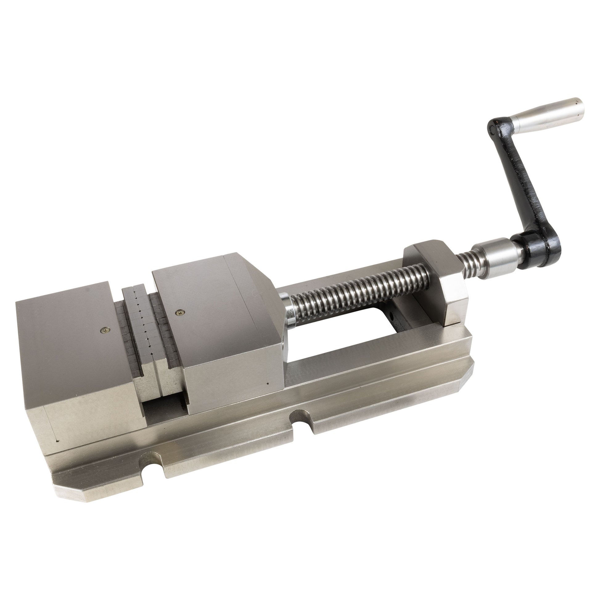

- 4" vise that conforms around stock
- Similar jaw action to fractal vise
- 4 inch jaws open to 4"
Manufactured from close grained high tensile grade cast iron, and precision ground body. The vise has multiple applications and is useful for clamping polygon work pieces, circular and round jobs as well as complex pieces.
The round parts can be gripped with superior holding power. This vise has the capability of gripping odd-shaped work pieces and eliminates the use of fixtures and jigs.
