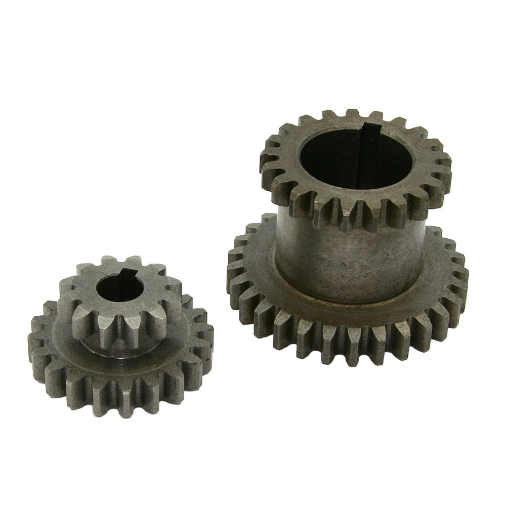

  • Replaces both plastic transmission gears with metal
  • Fits mini lathes (SIEG C2/C3) and 3MT mini mills (SIEG X2)
  • Small Gear: 12 Teeth / 20 Teeth, 12 mm Bore, 4 mm Keyway
  • Large Gear: 21 Teeth / 29 Teeth, 30 mm Bore, 5 mm Keyway
Enhance the longevity and reliability of your mini lathe (or Mill) with our metal transmission gear replacement set. Once this steel gear set is installed on your mini lathe, you will no longer have to worry about breaking the hard-to-replace gears inside the headstock.
This set includes 2 gears that are crucial for the smooth operation of the headstock. These gears are made of durable metal, ensuring they can withstand the rigors of regular use.
  • The smaller in this set is smaller of the two transmission gears. It has 12 Teeth on one end and 20 teeth on the other. (3451)
  • The larger of the two is the larger of the two transmission gears. It has 21 Teeth on one end and 29 teeth on the other. (3453)
With this replacement set, you'll no longer have to worry about the inconvenience and cost of replacing broken gears inside the hard-to-reach headstock. Upgrade your mini lathe's (or mill's) performance and ease of use with this essential replacement set.
*Compatible with SIEG C2/C3 mini lathes with 3MT spindle
These gears are the same as used on the 3 MT mini mill. The easy-to-replace intermediate gear on top of the headstock is still plastic. This helps to ensure that you don't break expensive and hard to replace parts deeper in the machine.
