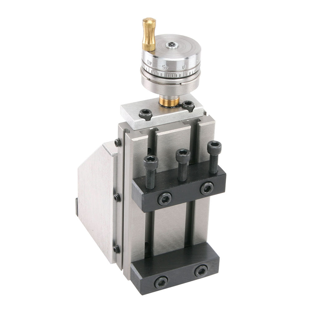

  • Small milling attachment for mini lathe
  • Fits most small SIEG class mini lathes
  • Mounting block not included
  • See Chris Tips for mounting block plans
The Taig milling attachment makes a good small milling attachment for the mini lathe.

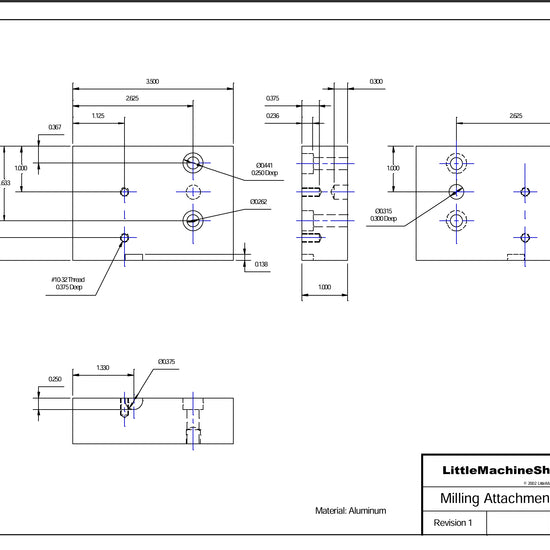

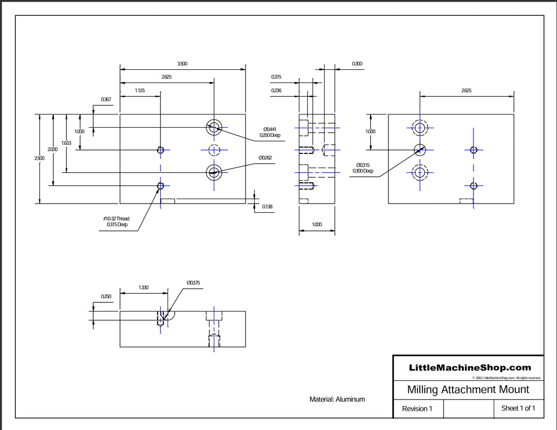

You must make a mounting block that is about 1" tall to mount this mini lathe milling attachment on the cross slide.
The total vertical travel is 1.5" and the dial provides 0.001" increments. The vise width is 2". The table is 2" x 3-3/4".
Overall the milling attachment is 2.25" wide, 3.38" deep, and 5.75" tall.

See Chris' Tips for mounting block plans.

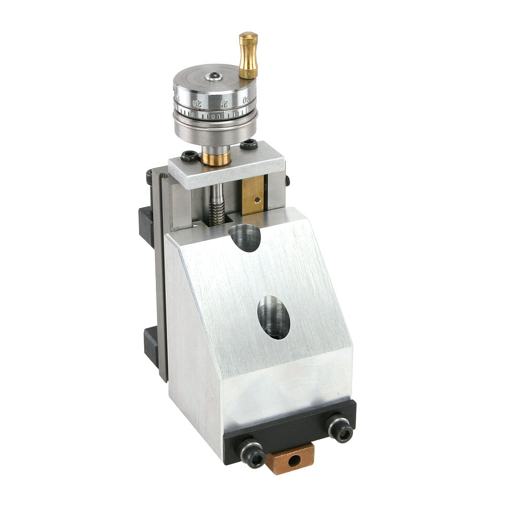

See associated plans for a mounting bracket that mounts the Taig milling attachment at the correct position on the mini lathe. This mounting block is Paul Mecca's design. Mount the plate to the lathe with M6x25 cap screws.
Here is a picture of the Taig milling attachment on the mini lathe.
