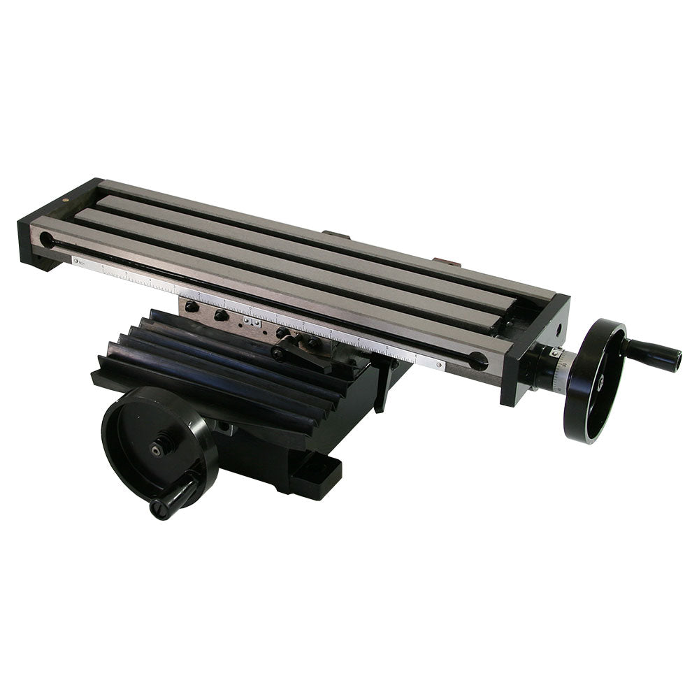

This is a complete X-Y table assembly for a mini mill.
The table is 120 mm (4.73") by 460 mm (18.11"). It has three 12 mm T-slots.
The X-axis travel is 300 mm (11.8") and the Y-axis travel is 130 mm (5.1").
The dials are graduated in 0.001" and one turn of the hand wheels moves the table 0.050".
The X-Y table is made of cast iron and steel. There are adjustable gibs on both axes.
The column mounting bolt pattern consists of 4 M8 threaded holes spaced 135 mm x 50 mm.
