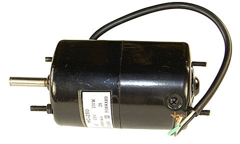

- Motor, 2001 Tool Post Grinder
- 110V AC 250 Watt motor draws 2 amps
- 18,000 RPM (nameplate, not tested)
- Turns clockwise when looking at end of shaft
The tool post grinder motor is approximately 110 mm long and 74 mm in diameter. The shaft is 8 mm in diameter and about 30 mm long. There is a 3 mm keyway.
The mounting studs for this electric grinder motor are M5, 13 mm long and 61 mm center to center.
