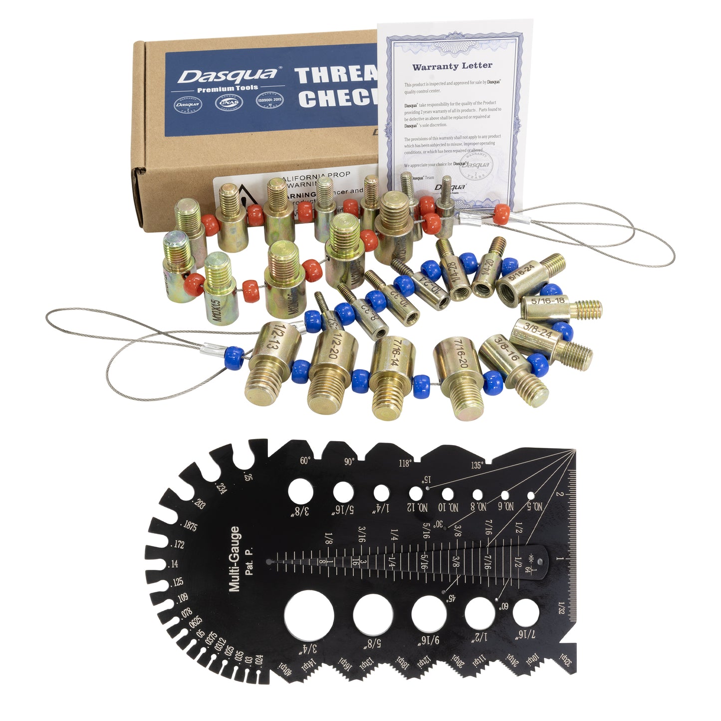

  • Each size has a nut and bolt checker on the same gauge with the sizes etched on each gage
  • All on a convenient wire cable with a loop for hanging
  • Measures wire gages, drill sizes, drill points, screw pitches, bores.
  • Can also be used as a ruler or protractor.
  • Tap & drill recommendation chart included.
Dasqua Premium Inch and Metric thread checker. This thread checker set provides a quick and easy way to measure standard threads in both inches and metric. They provide all the information you need for screws; diameter, length, threads per inch, hole size and even tap drill sizes. Each piece has a male and female end to help you identify screws, nuts, or other threaded items.
(14) Inch Sizes Included: #6-32, #8-32, #10-24, #10-32, 1/4-20, 1/4-28, 5/16-18, 5/16-24, 3/8-16, 3/8-24, 7/16-14, 7/16-20, 1/2-13, 1/2-20
(12) Metric Sizes Included: M4 x 0.7, M5 x 0.8, M6 x 1.0, M7 x 1.0, M8 x 1.0, M8 x 1.25, M10 x 1.0, M10 x 1.25, M10 x 1.5, M12 x 1.25, M12 x 1.5, M12 x 1.75
The metal construction removes the issue of damaging the checker when testing threading which is sometimes an issue with plastic checkers.
* Note: Spacer beads may vary in color and style.
Dasqua 7-in-1 Multi-Purpose Gage. Measures wire gages, drill sizes, drill points, screw pitches, bores. Can also be used as a ruler or protractor. Tap & drill recommendation chart included.
  • Wire gage measures 0.024-0.25".
  • Drill sizes include #5, #6, #8, #10, #12, 1/4, 5/16, 3/8, 7/16, 1/2, 9/16, 5/8 & 3/4".
  • Drill points include 60, 90, 118 & 135 degrees.
  • Screw pitch gage measures 40th, 32nd, 24th, 20th, 18th, 16th, 14th, 13th, 12th, 11th & 10th TPI.
  • Bore gages include 1/64-1/2".
  • Ruler is 2-1/2 x 32nds.
  • Protractor measures 15, 30, 45, 60, & 90 degrees.
Made of tool steel with black coating. Laser engraved markings. 6-5/8 long X 3-1/2" wide. Vinyl pouch is included.
