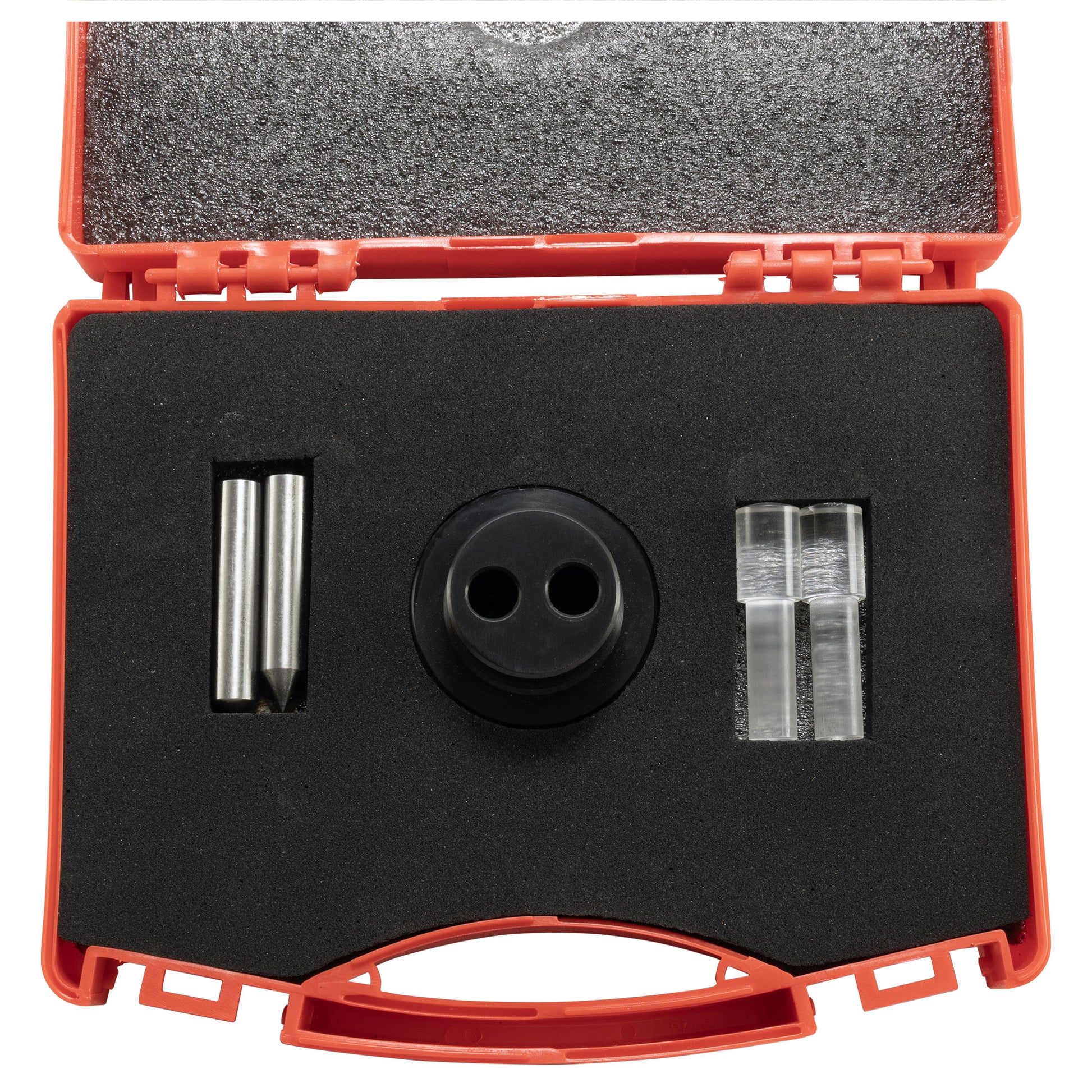

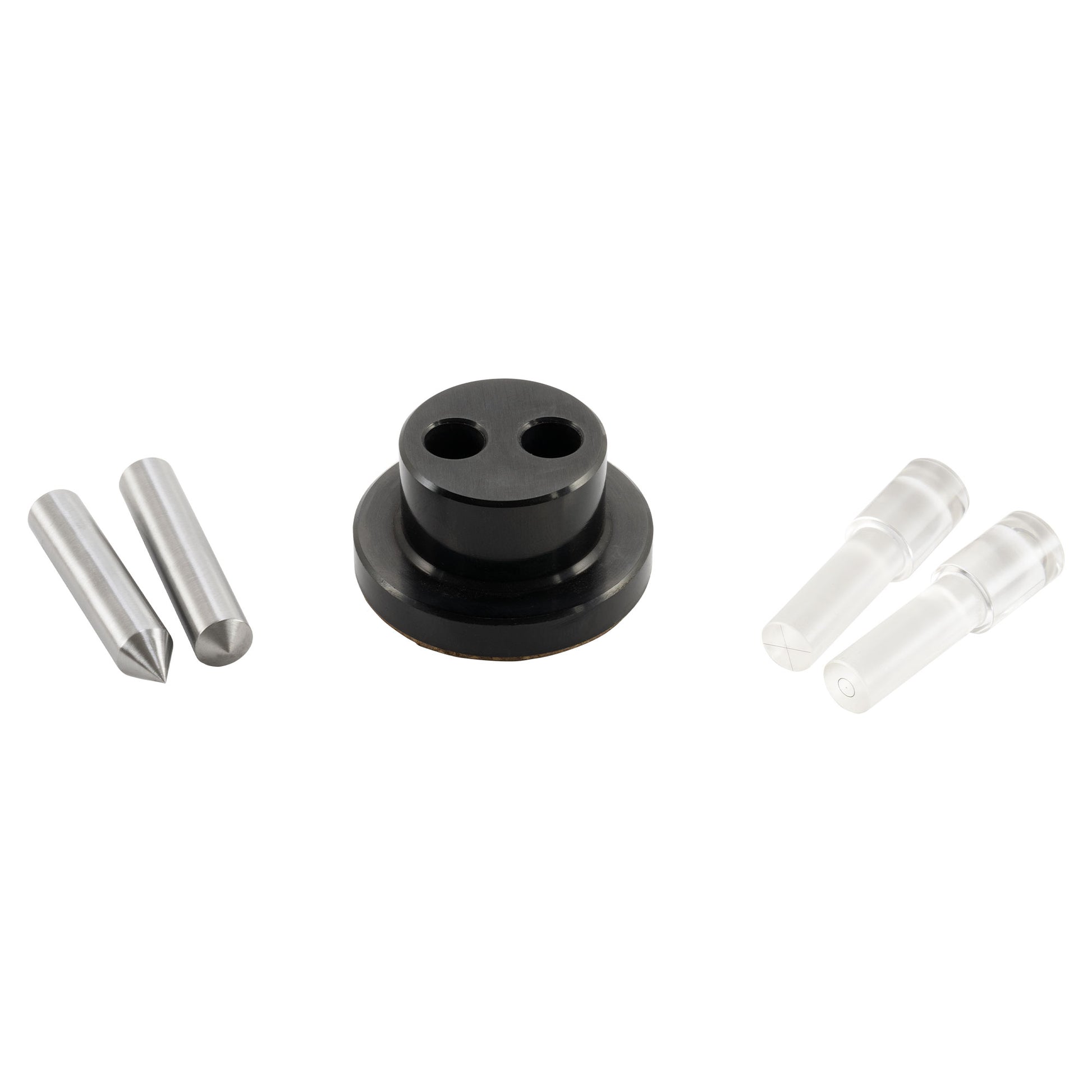

- Accuracy to 0.002"

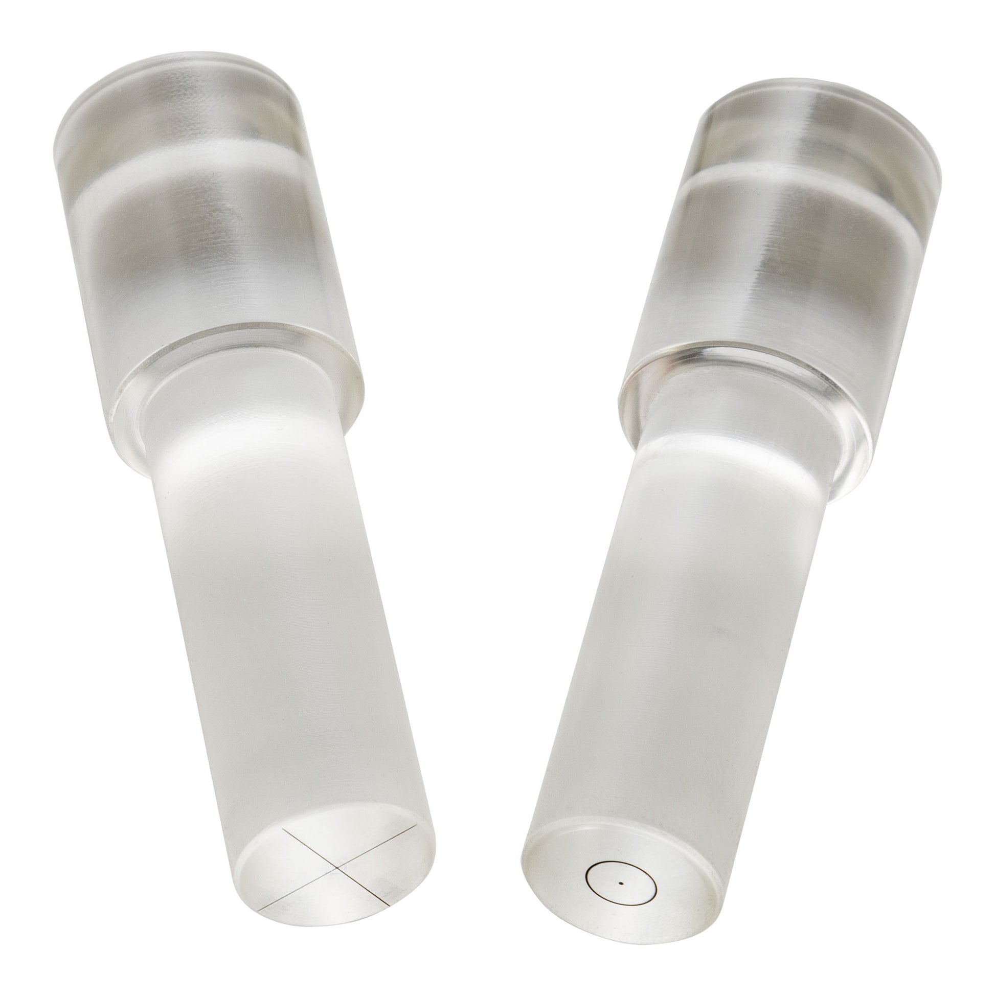

- A bullseye lens and a cross hair lens target the punch location
- Acrylic lens magnifier power is 9x

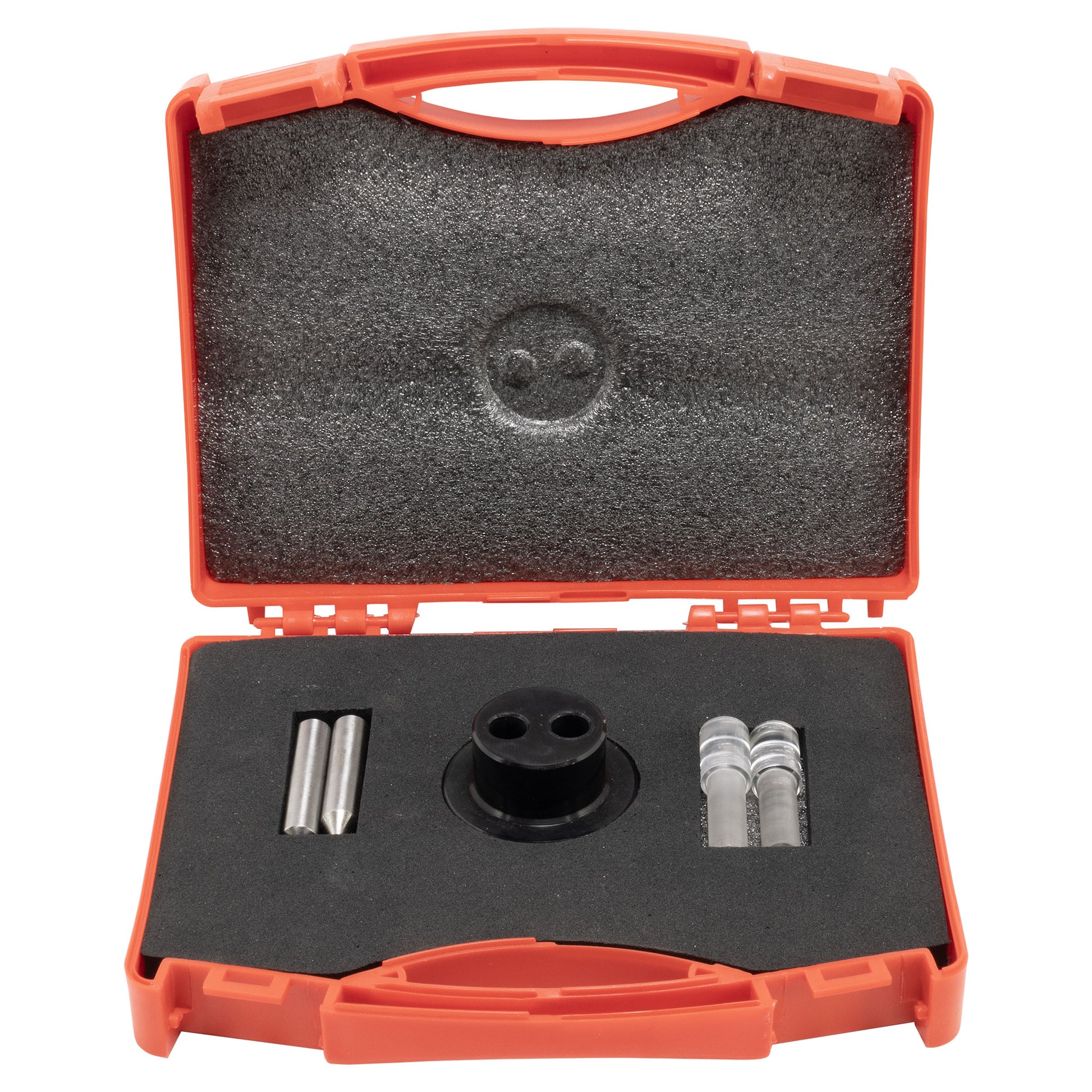

- Includes sturdy storage case

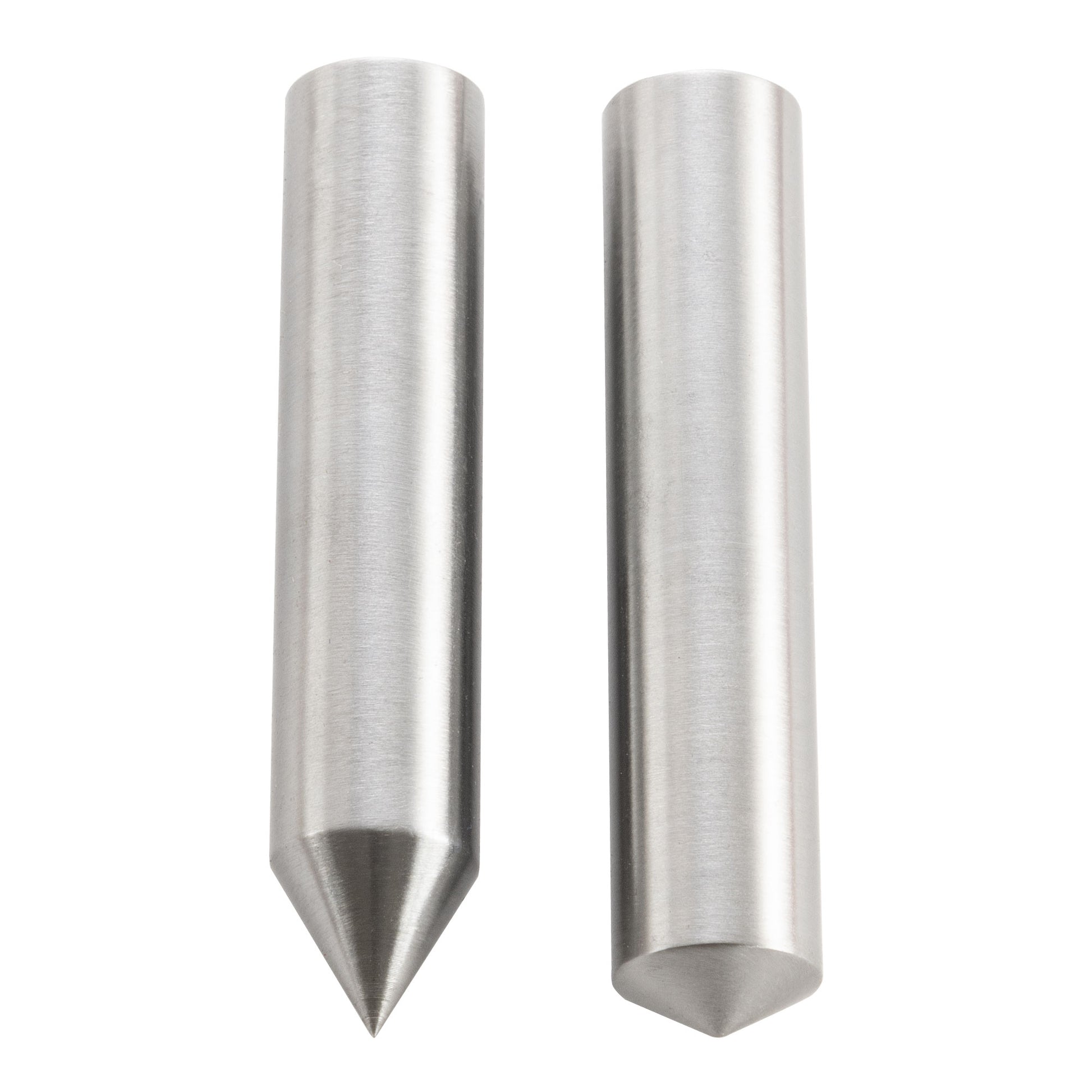

- Includes a 120 degree tempered steel center punch and a 60 degree tempered steel center punch
Even less experienced machinists can punch layout points to within 0.002" using this high-power piloted center punch system.
The optical center punch is located over a scribed workpiece and adjusted until centered using the optics. The optical pilot is then removed and replaced by the punch. A tap marks the spot.
