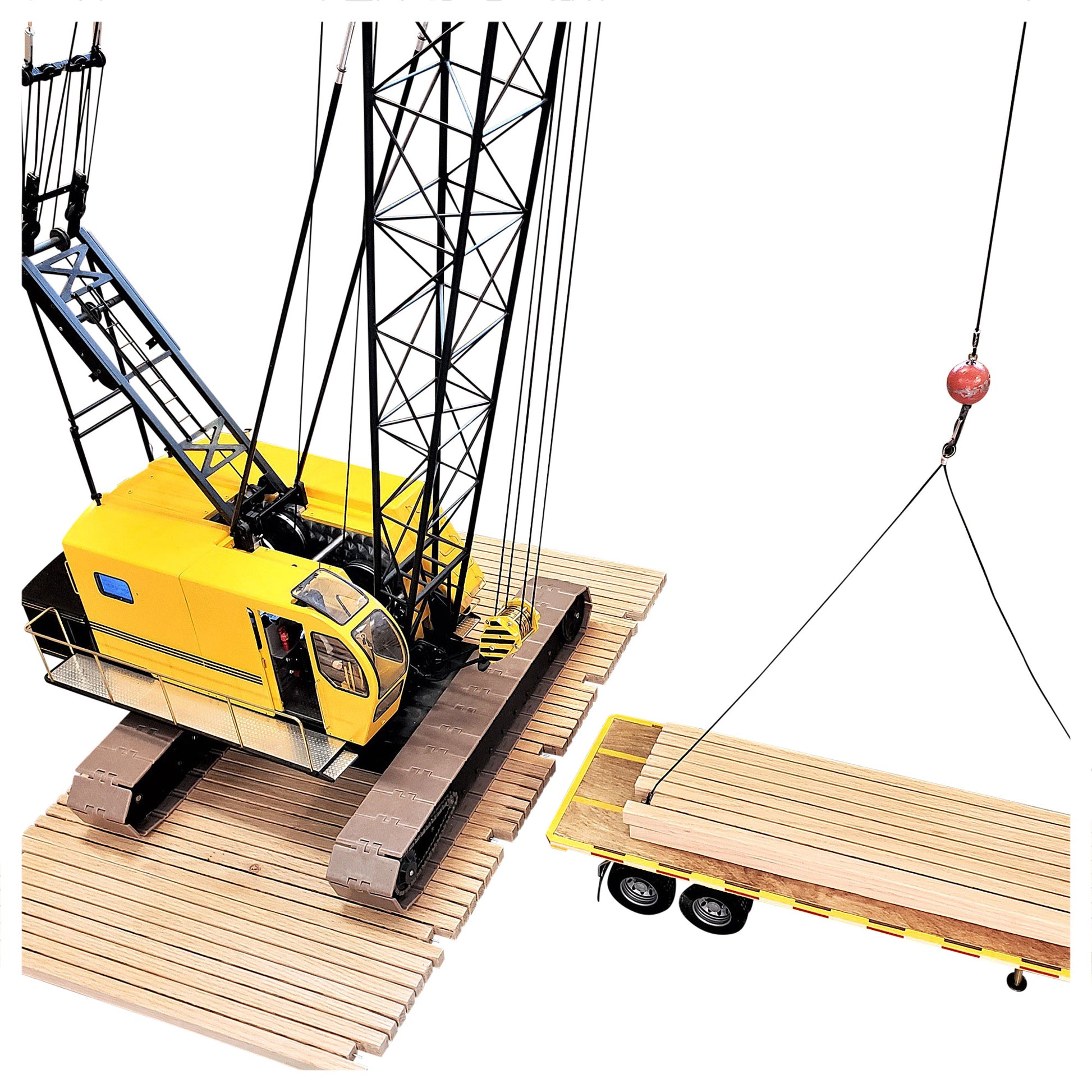

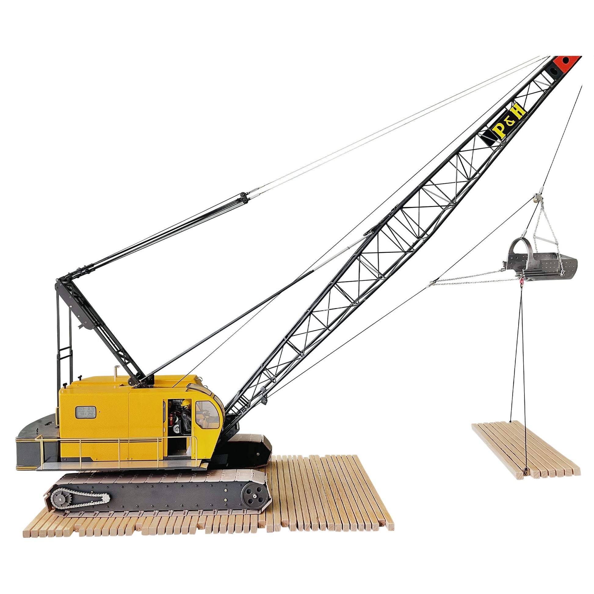

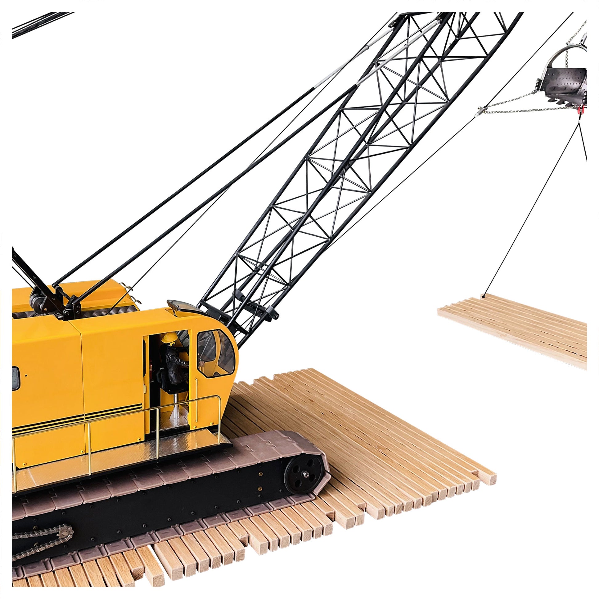

  • Complete plans to build a model P&H Model 1015 crawler crane
  • Crane can be configured with boom length over 9 feet
  • USB Flash Drive containing 7 GB including complete plans and annotated construction photos

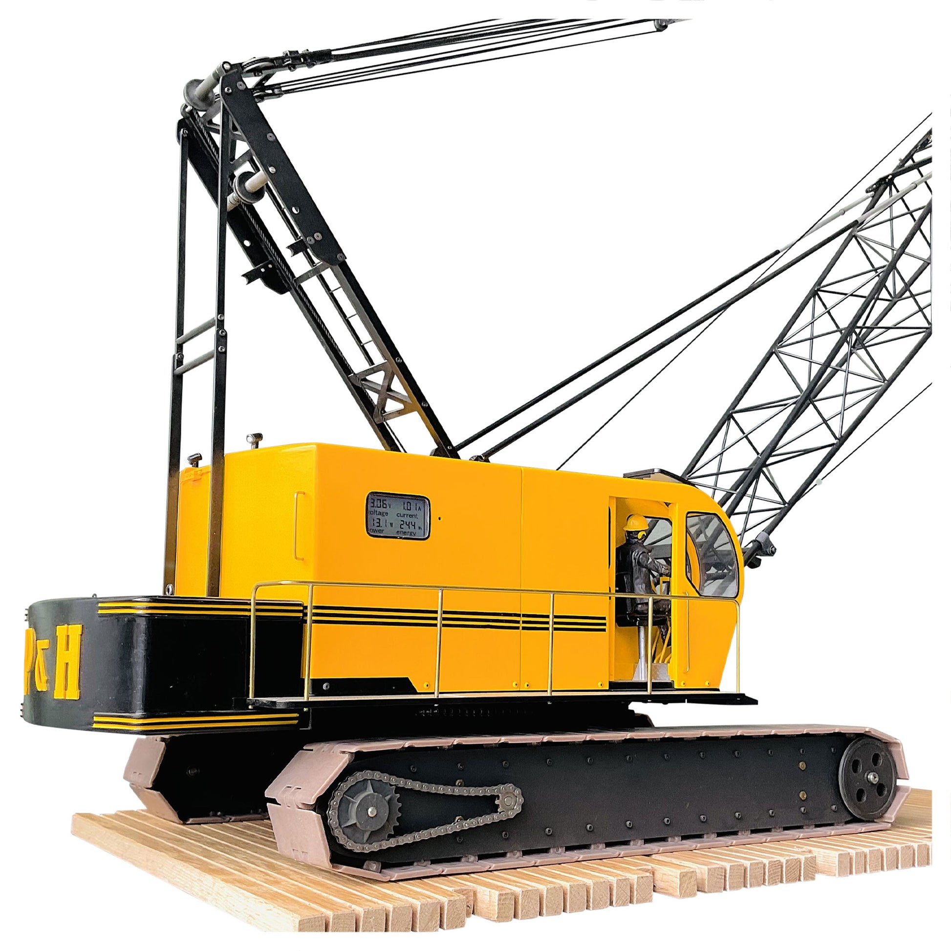

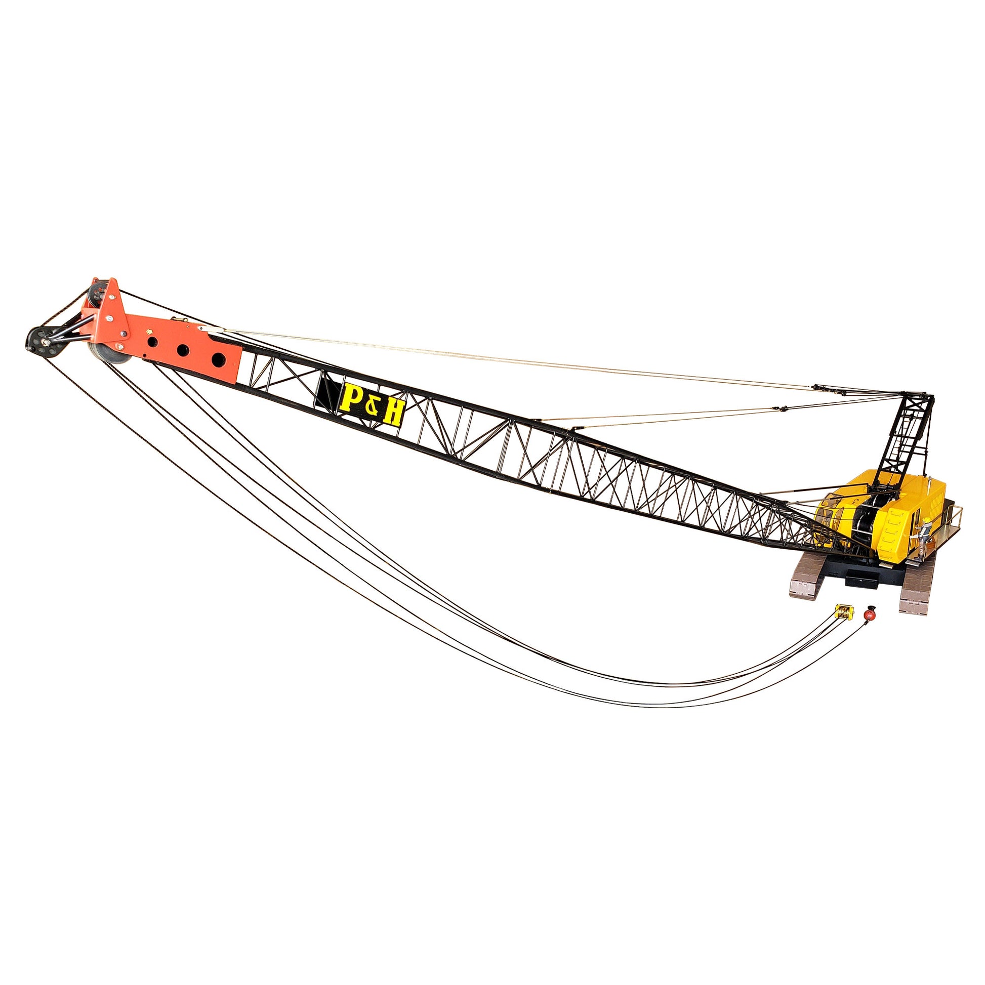

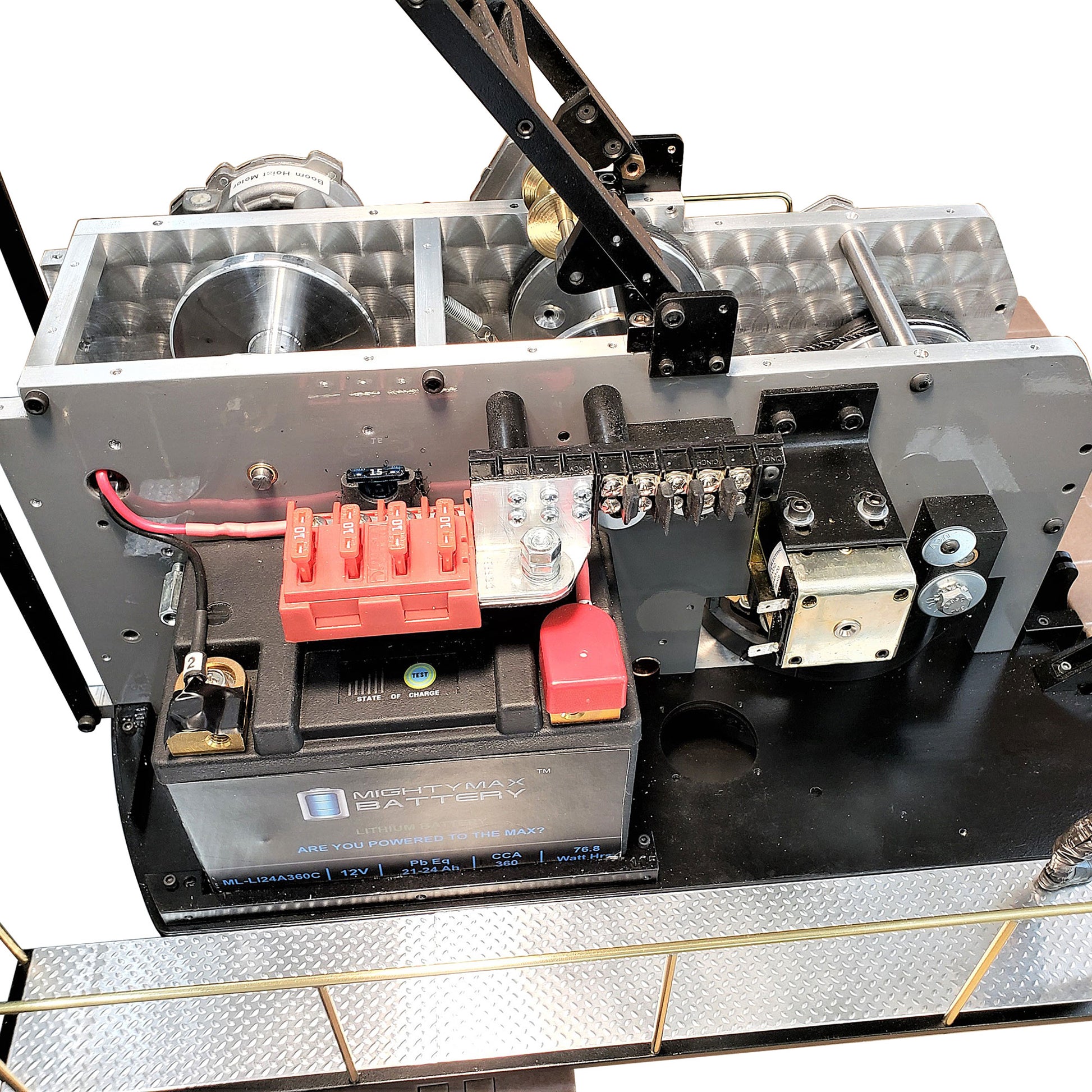

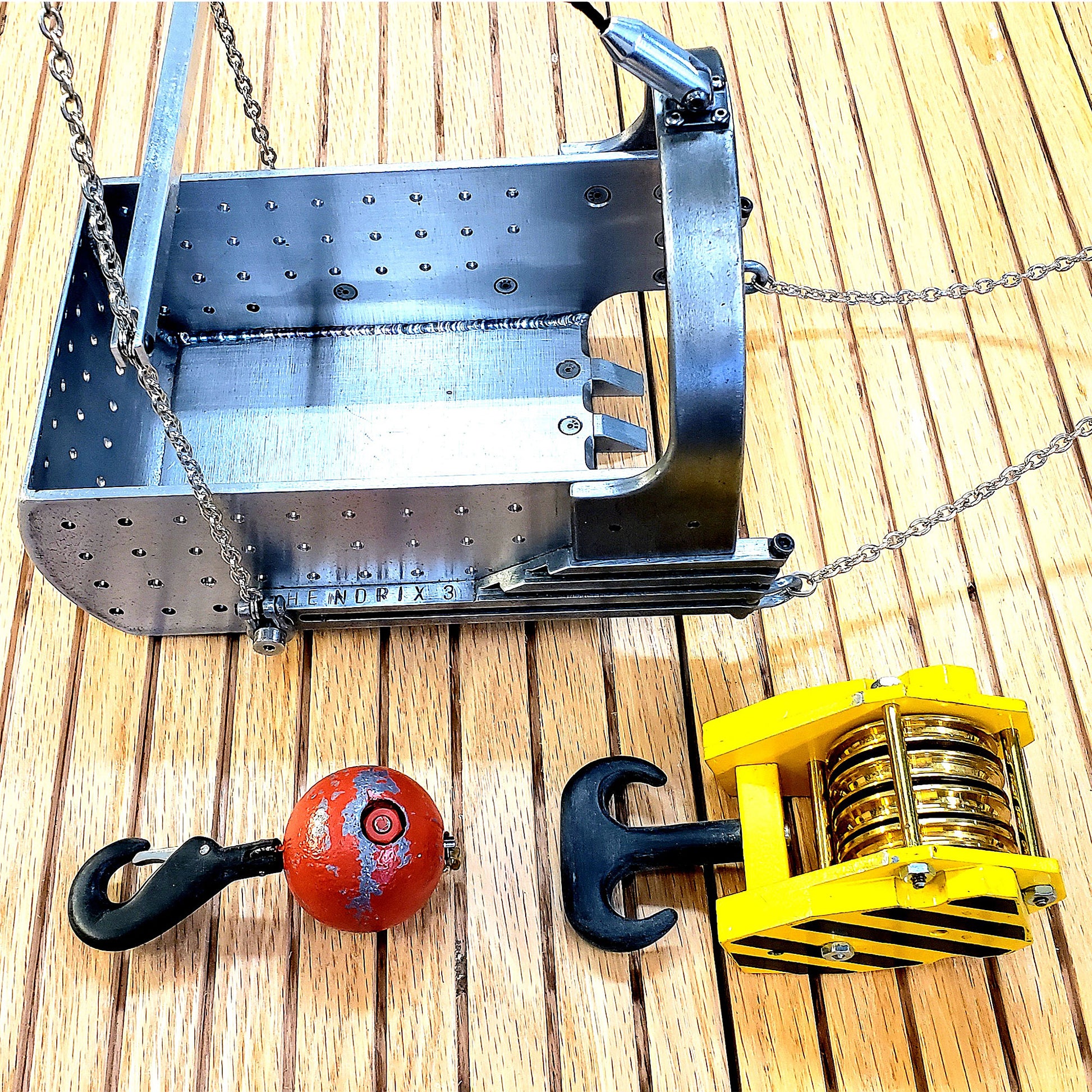

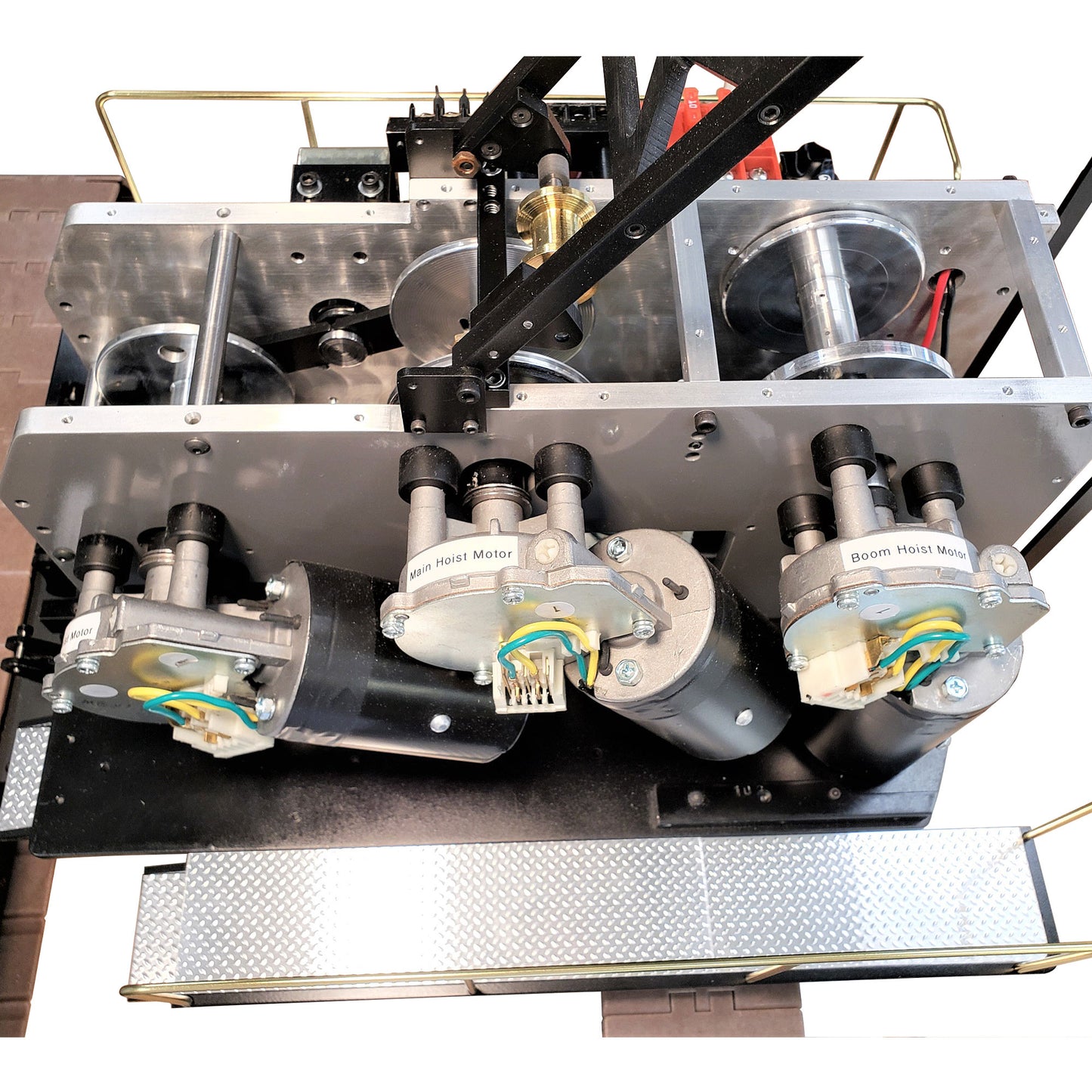

This Crane Model is a 1/12th scale, fully functioning 8-channel Radio Controlled replica of the 1960s vintage P&H Model 1015 (110-ton capacity) Lattice Boom Crawler Mounted Crane. Power for the model is provided by a 12 Volt, 22 Amp Hour LiFePO4 battery that is mounted at the right rear of the cab. The model’s left and right crawler treads are powered independently with 12 Volt gearmotors and propel the model at a scale speed of 60 inches per minute. The single Boom Hoist Drum, two Cable Hoist Drums and the Cab Swing are each powered by modified 12 V windshield wiper (worm gear) motors from late model VWs. The lattice boom is a hybrid design that utilizes select straight 5/16" diameter oak x 36" long corner rods with 1/8" diameter poplar lattice members, however the boom areas of stress concentration including the Boom Tip section, Boom End sections and the Boom Base section are 50/50 soldered brass tubing fabrications.
