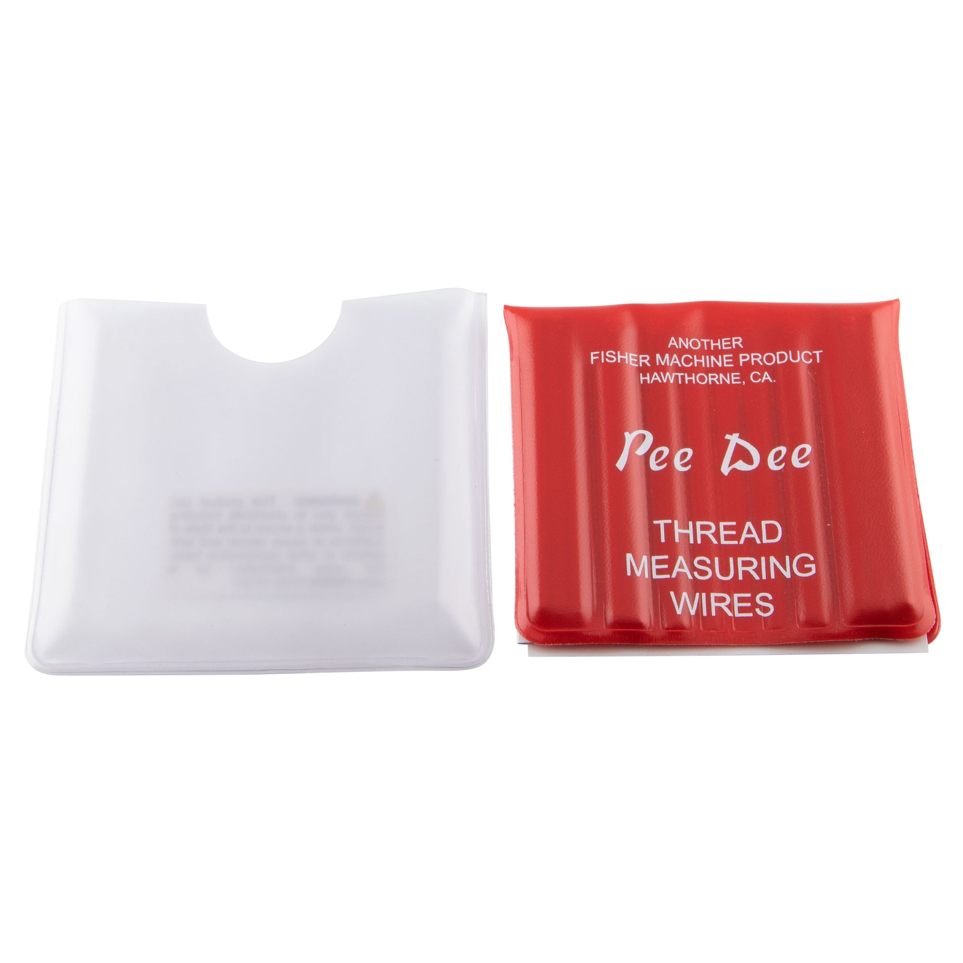

Pee Dee Thread Measuring Wires, Fisher
Regular price $49.95
SKU:1962Shelf Location: (B06 - 05)
  • Made in USA by Fisher Machine Shop

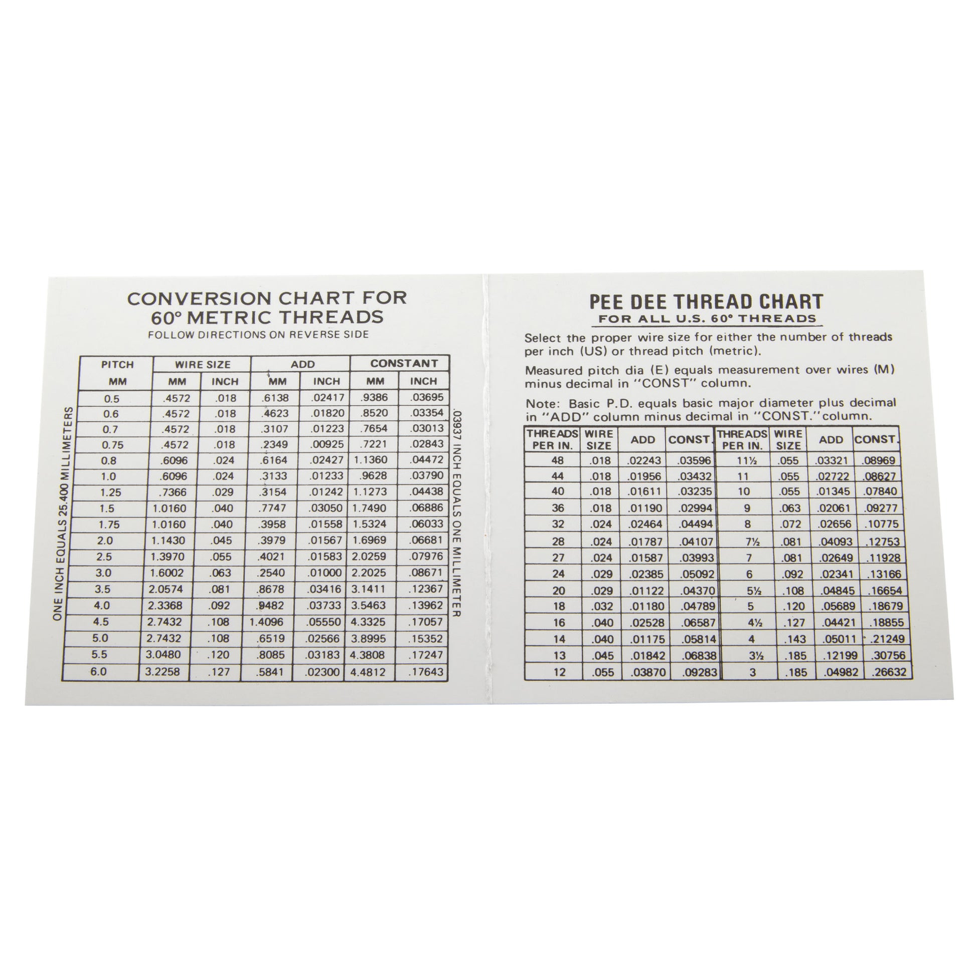

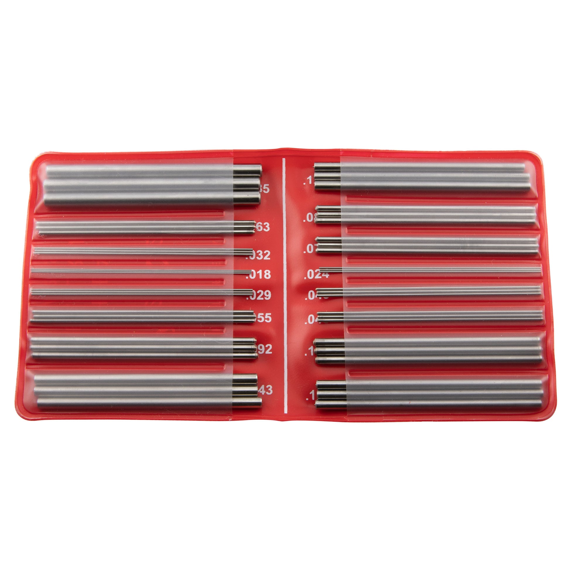

This set of thread measuring wires includes 48 wires of 16 different diameters for the three wire thread measuring procedure.
You can measure threads from 3 to 48 threads per inch, and metric threads from 0.5 mm to 6 mm pitch. You can also measure Acme threads from 3 to 16 threads per inch.
The thread measuring wires come with thread charts and are furnished with a quality vinyl case.
This is a quality American-made product from Fisher Machine Shop. These are the original Pee Dee thread measuring wires.
