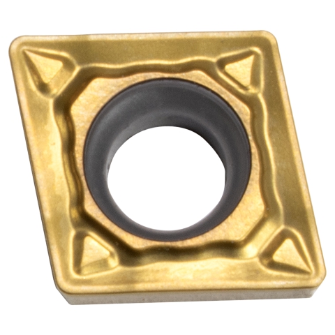

Insert, CCMT-21.51 Carbide
- Coated carbide
- 80 degree diamond, 7 degree relief
- 40-60 degree single countersink, single-sided chip breaker
- 0.0156" (1/64") corner radius
- ANSI: CCMT21.51, ISO: CCMT060204
CCMT-21.51 carbide insert is a 80° diamond with a 7° relief. The center hole is a 40°-60° single countersink, and a single-sided chip breaker.
It has an inscribed circle (IC) of 0.25" (1/4"), a thickness of 0.094" (3/32"), and a corner (nose) radius of 0.0156" (1/64").
The insert is designated CCMT21.51 (ANSI) or CCMT060204 (ISO). For a list of compatible LittleMachineShop.com products, see the Compatibility tab.
