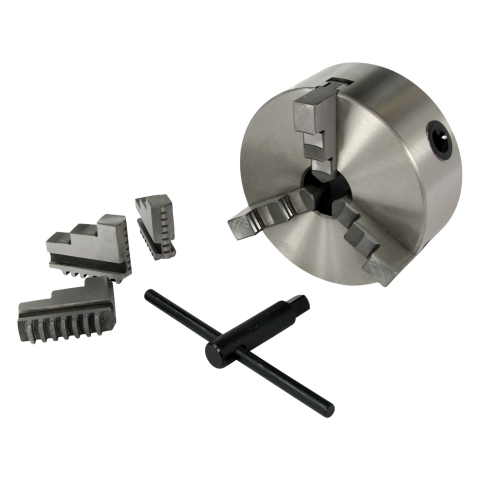

Lathe Chuck - 6", 3-Jaw
- 3-jaw self centering lathe chuck
- 6" (160 mm) diameter
- Includes chuck key, inside and outside jaws
- Plain back mounting
- High quality steel, hardened and ground
This 6 inch 3-Jaw self-centering lathe chuck includes a chuck key, inside and outside jaws, and mounting bolts.
This chuck has a 1.57" (40 mm) through hole. The chuck can hold work up to 5.70" (145 mm) in diameter.
This is a plain back chuck and requires a backplate adapter to mount it.
The radial runout of a test bar held in this chuck, when the chuck is mounted true, is 0.003" maximum.
Chris' TipsThis chuck is too big to fit on a mini lathe.

| Rated Capacity, Inside Jaws | 0.12" - 2.17" (3.0 mm - 55.0 mm) |
| Rated Capacity, Jamming Range | 1.97" - 6.30" (50.0 mm - 160.0 mm) |
| Rated Capacity, Outside Jaws | 2.17" - 5.71" (55.0 mm - 145.0 mm) |
| Runout (Max) | ≤ 0.0032" (0.081 mm) |
| Diameter, Overall | 6.30" (160.0 mm) |
| Registration Recess Diameter | 5.12" (130.0 mm) |
| Registration Recess Depth | 0.20" (5.0 mm) |
| Bolt Circle Diameter | 5.59" (142.0 mm) |
| Center Hole Diameter | 1.57" (40.0 mm) |
| Height | 2.56" (65.0 mm) |
| Jaw Height Above Face | 1.18" (30.0 mm) |
| Height with Jaws | 3.74" (95.0 mm) |
| Number and Size of Bolts | 3 M8 |
| Chuck Key | 0.374" (9.50 mm) |
| Max RPM | 3600 RPM |
| Chuck Designation | K11-160 |
