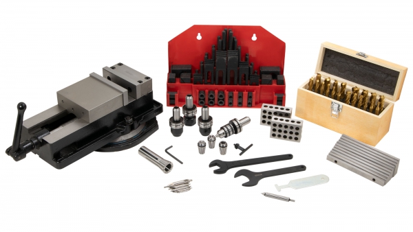

- Everything you need to use your mill with the Tormach Tooling System
- Workholding - 5" precision CNC milling vise, parallels, clamping kit, 1-2-3 blocks
- Cutting tools - end mills and center drills
- More - edge finder, vise mounting kit, T-slot cleaner
- Includes Tormach TTS Manual Starter Set (Inch)
Weight: 78.3 lb
Purchased individually $779.50
The precision 5" lock-down CNC milling machine vise features a compact size that allows multiple vises on CNC mill table.
The top, bottom of vise bed, gib, jaws, swivel base, and all plate mounting surfaces are ground. The hardened and ground replaceable jaws on this vise are 4" wide, 1.46" deep, and open 4.2". The vise is 11.2" long. The vise is 3.94" high.
The replaceable jaws can be mounted on either end of the fixed and movable jaw supports providing a wide range of clamping distances.
The set of ten pairs of thin parallels come in a fitted case. They are 1/8" thick and 6" long. The heights are 1/2", 5/8", 3/4", 7/8", 1", 1-1/8", 1-1/4", 1-3/8", 1-1/2", and 1-5/8". The parallels are made of high grade alloy steel hardened to 52-58 Rc. They are parallel within 0.0002" on the top and bottom. The pairs are matched in height within 0.0004"
The 20 piece TiN coated HSS end mill set includes both 2 flute and 4 flute end mills. The center cutting end mills are 3/16" to 3/4" by 16ths. The set comes in a fitted case.
The precision 1-2-3 blocks are ground and case hardened on all sides to 50-60 Rc. The blocks are 1" by 2" by 3". They are parallel within 0.0002", flat within 0.0002" and square within 0.00021". The set includes two matched blocks. The blocks have 23 holes through them, 5 are threaded 3/8-16 NC.
This package includes 5 different sizes of combined drills and countersinks, commonly called center drills. The center drill set is high speed steel and includes sizes 1,2,3, 4, and 5. These are 60 degree center drills.
The Tormach Tooling System Starter Set includes two set screw end mill adapters, one ER-20 collet chuck with three collets, a TTS R8 collet, a 1/4" drill chuck, plus wrenches and installation tools.
