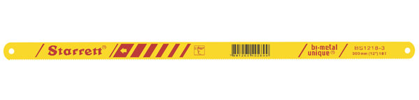

  • Starrett bi-metal uniqueHSS Safe-Flex hacksaw blades
These blades are 12" long, 1/2" wide and are 0.025" thick.
Bi-metal unique High Speed Steel Safe-Flex hacksaw blades are made with a patented solid-state diffusion process with 170% more HSS weld area and ground teeth for reduced blade fracture, faster cutting and longer life.
Get the correct hacksaw blade for the material you are cutting:
Cross Section To Be CutUse PitchP/N
Inchmm
7/32" - 3/4" 6 - 19 mm 14 1849
3/16" - 1/2" 5 - 13 mm 18 1850
1/8" - 7/16" 3 - 11 mm 24 1851
3/32" - 5/16" 2.5 - 8 mm 32 3561
Note that there is a lot of overlap in the cross section column. Use coarser pitches for faster cutting and finer pitches for smoother cutting.
