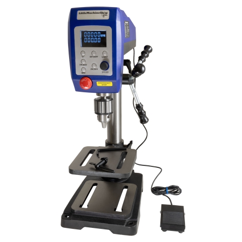

Drill Press, Mini Bench Top with Tapping Function
- Mini Drill press with tapping feature
- 4.7" (120 mm) Swing, 22" (570 mm) Height
- Drilling 600-3000 RPM, Tapping 400-800 RPM
- 1HP (600 watt) direct drive brushless motor
- JT33 1/2" Drill Chuck (1.5mm - 13mm) (0.059" - 0.512")

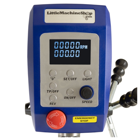

The control panel has a large LED display screen showing spindle speed as well as spindle travel. Control buttons include a "0" function, tapping mode, spindle reverse, On/Off, light On/Off, drilling depth setting, and a speed control dial. A small light is mounted on the underside of the headstock and controlled at the control panel.

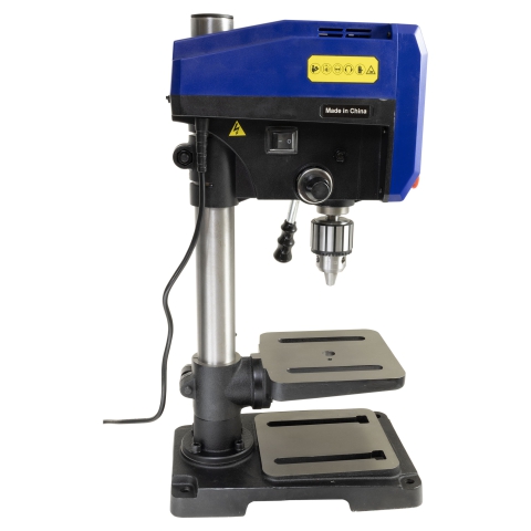

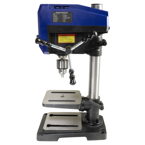

The feed handle assembly may be mounted on the right or left of the machine based on user preference. The headstock is mounted on the column top and the column is bolted to the base. This assembly is done when you unpack the machine.
The drill press has a cast iron base with two 5/8" t-slots and tilting table with an additional two 5/8" t-slots. The tilting table can rotate 45 degrees in either direction and moved 360 degrees around the central column.
