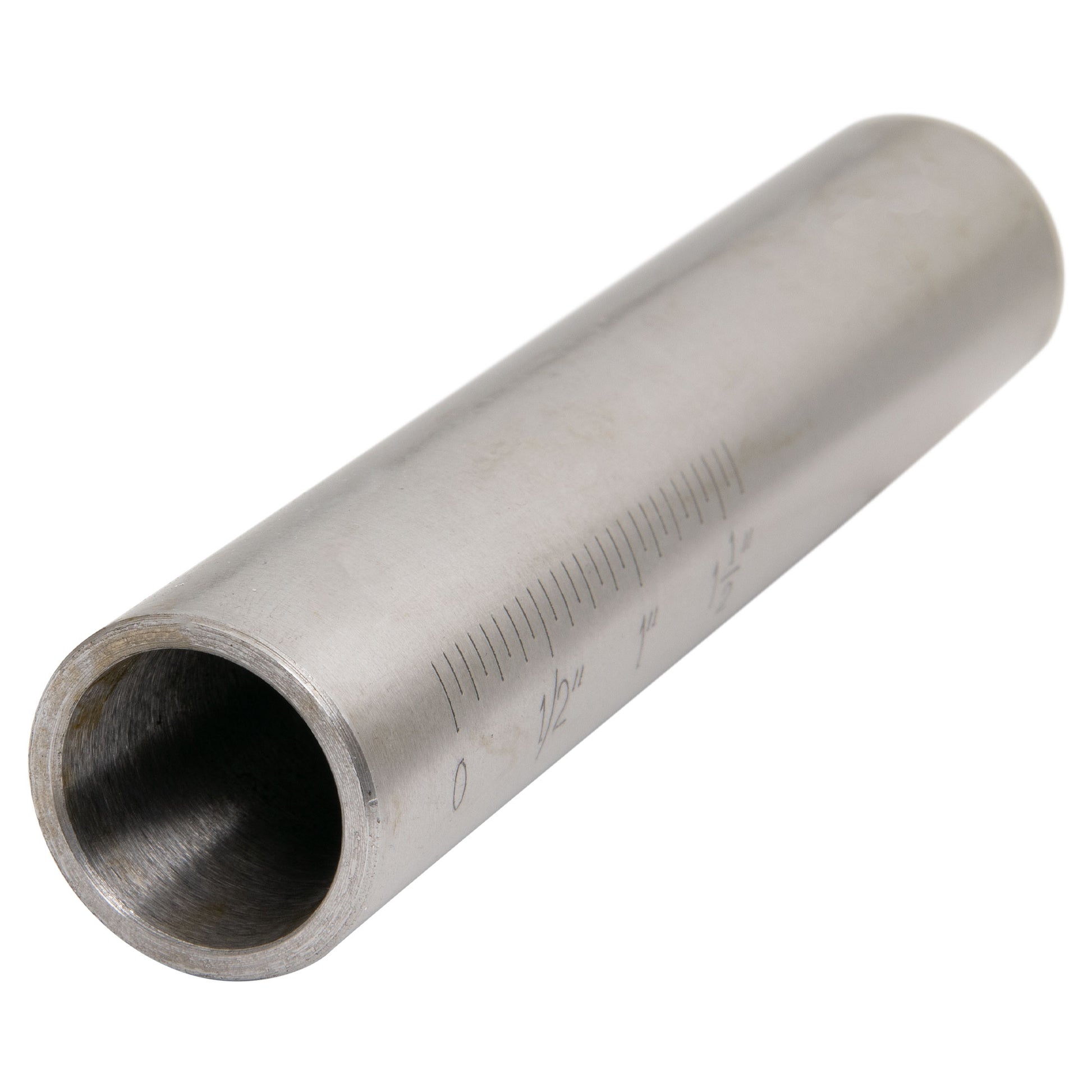

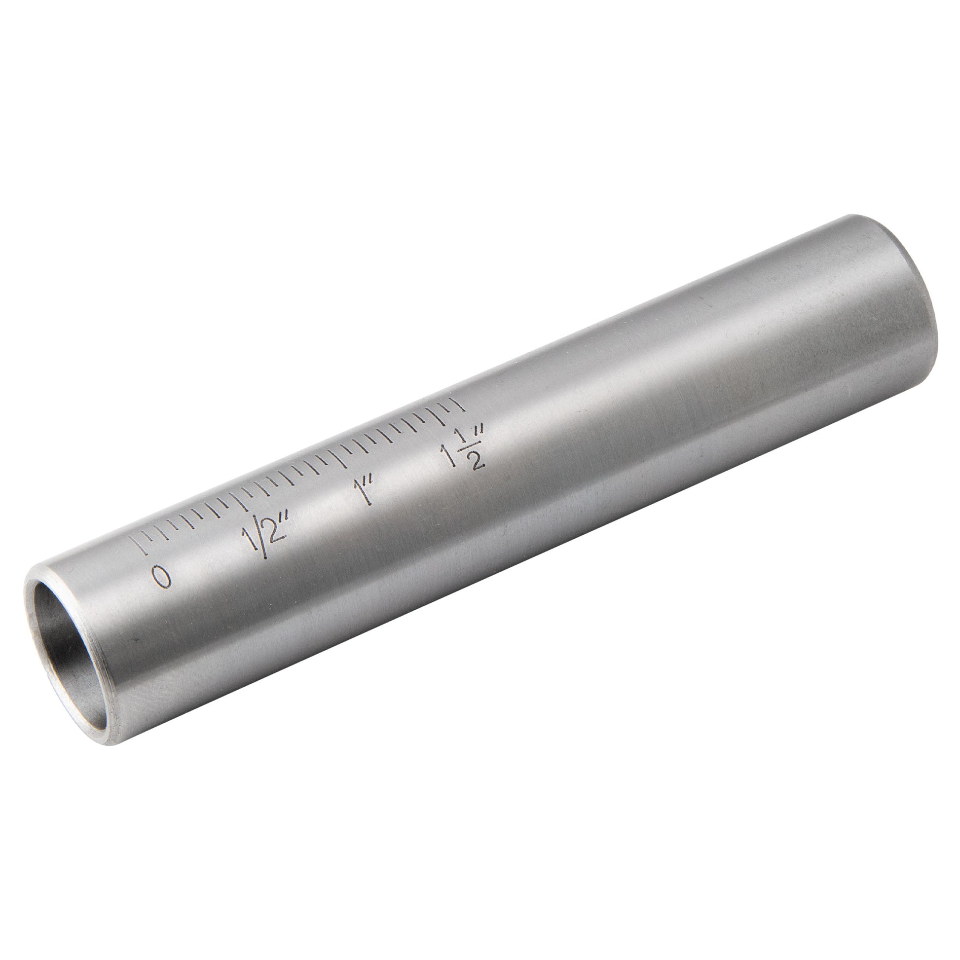

  • Quill for 7x10, 7x12 & 7x14 mini lathe tailstocks
  • #2 Morse Taper bore
  • Overall length 110 mm
  • Diameter 22 mm

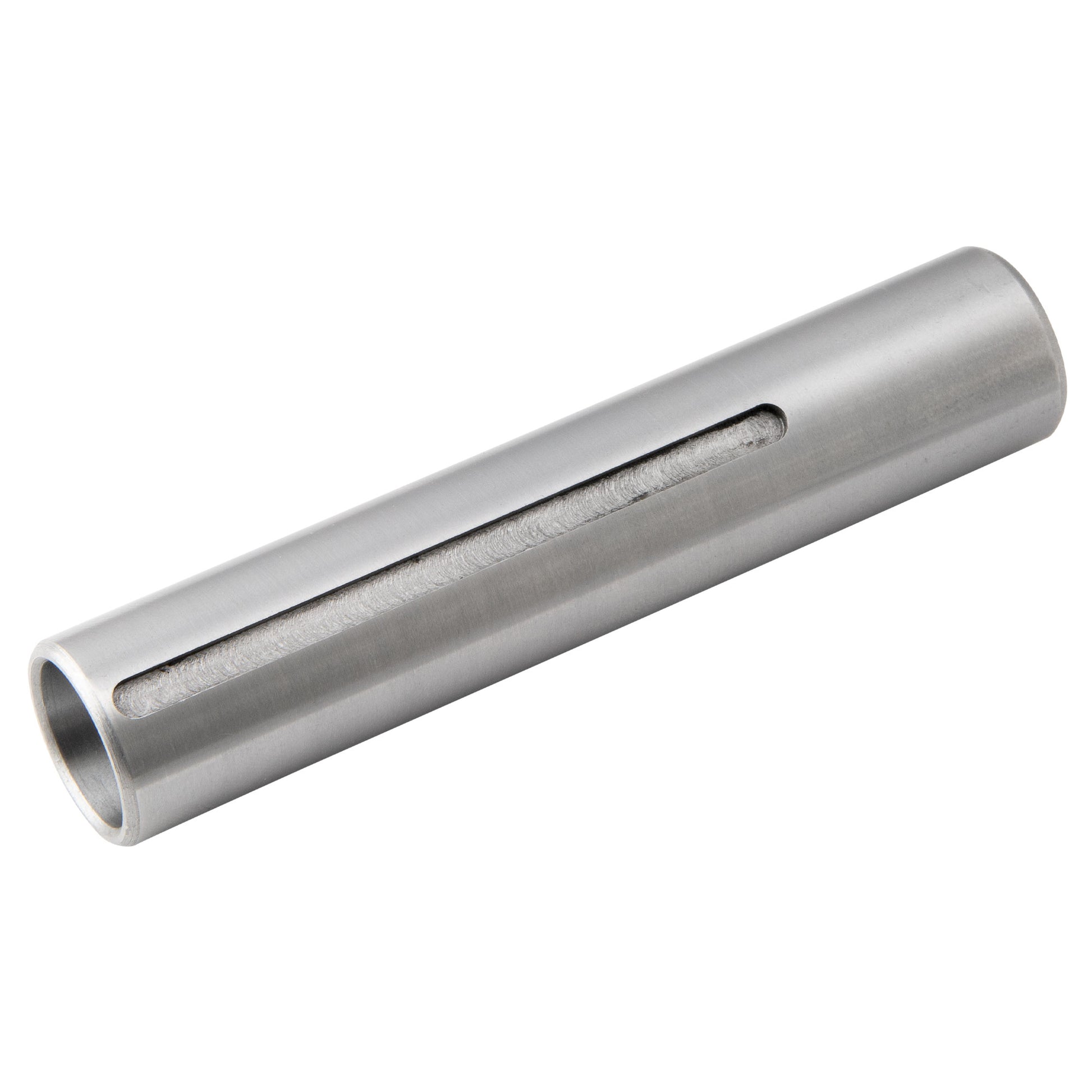

  • Keyway 4 mm x 75 mm in length
This is the quill for the tailstock on common 7x10, 7x12 and 7x14 mini lathes (SIEG C2 & C3 models) as well as HiTorque mini lathes (SIEG SC2).
It has a #2 Morse Taper bore.
Overall length is 110 mm and diameter is 22 mm. The keyway on the underside is 4 mm x 75 mm in length.

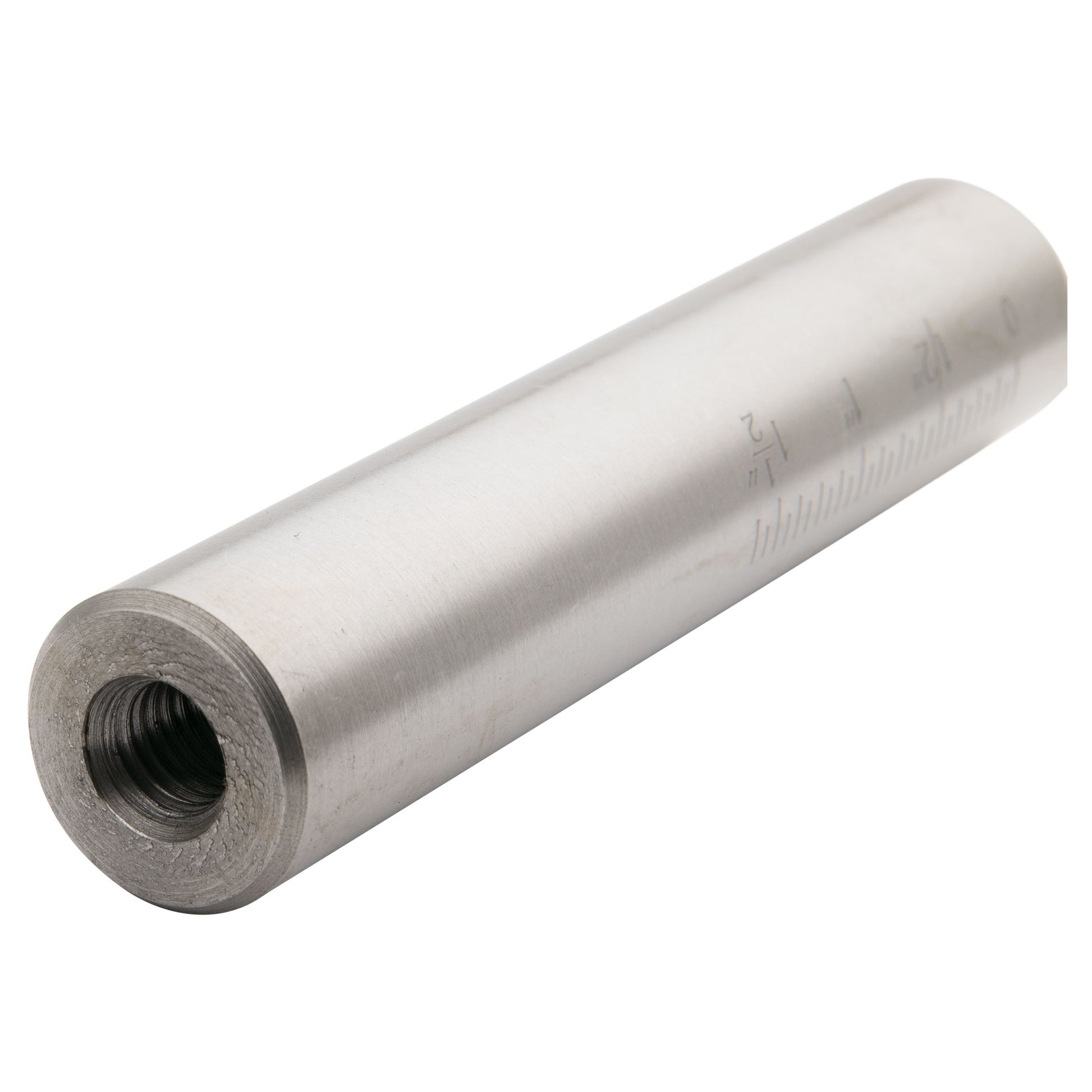

Thread is M10-2 left hand
Overall Length: 4.331" (110 mm)
Diameter: 0.866" (22 mm)
Keyway: 4 mm x 75 mm
Bore: #2 Morse Taper
