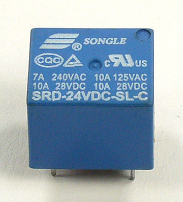

  • SRD-24DC-SL-C
SONGLE 24V DC SPDT Power Relay SRD-24VDC-SL-C
Rated load: 10A 250VAC/28VDC,10A 125VAC/28VDC,10A 125VAC/28VDC
Contact resistance: <=100m (ohm)
Electrical life: 100,000
Mechanical life: 10,000,000
Coil rated voltage: 3-48VDC
Coil power: 0.36W, 0.45W
Coil pick-up voltage: <=75%
Coil drop-out voltage: >=10%
Ambient temperature: -25 degrees Celsius to +70 degrees Celsius
Coil and contacts:1500VAC/min
Contact and contacts: 1000VAC/min
Insulation resistance: >=100M ohm
Mounting form: PCB
Weight : 10 g
Outline dimensions :19mm x 15.5mm x 15mm
