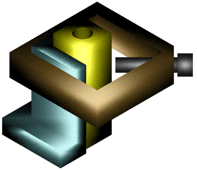

Here is a rendering that shows how the Rike-Vise is used. The yellow piece is the workpiece.
