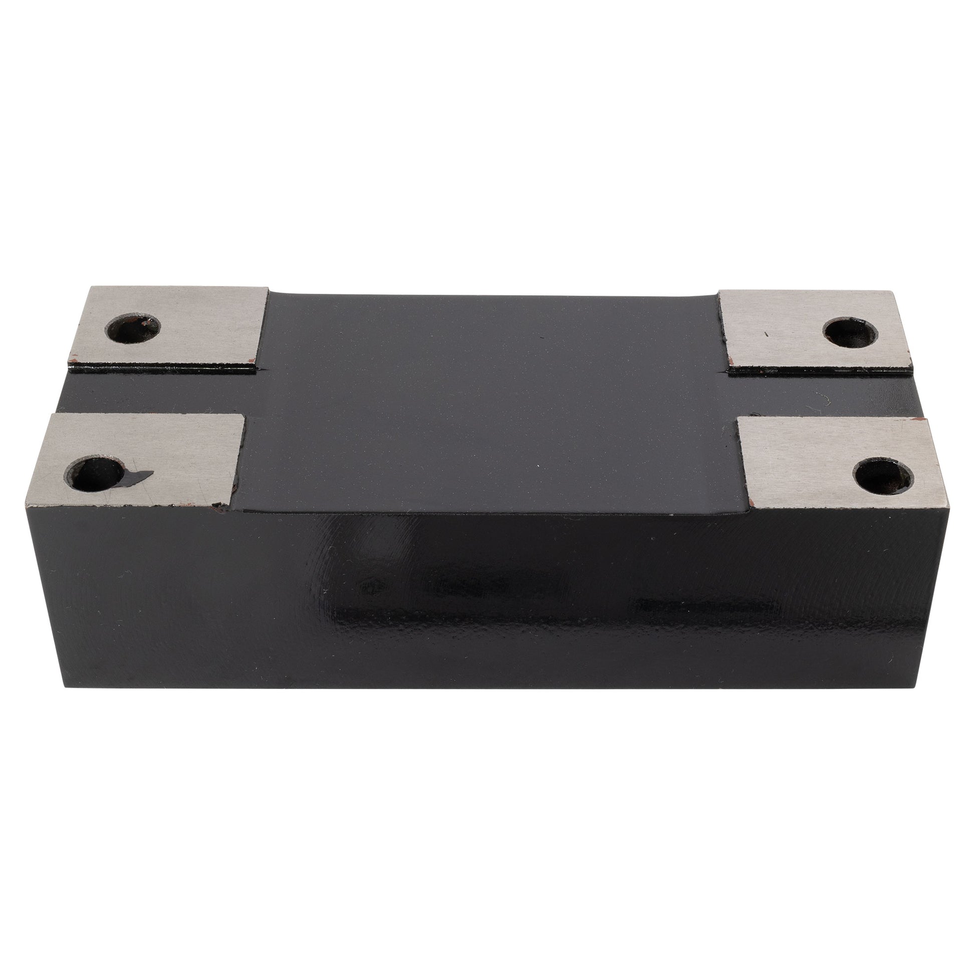

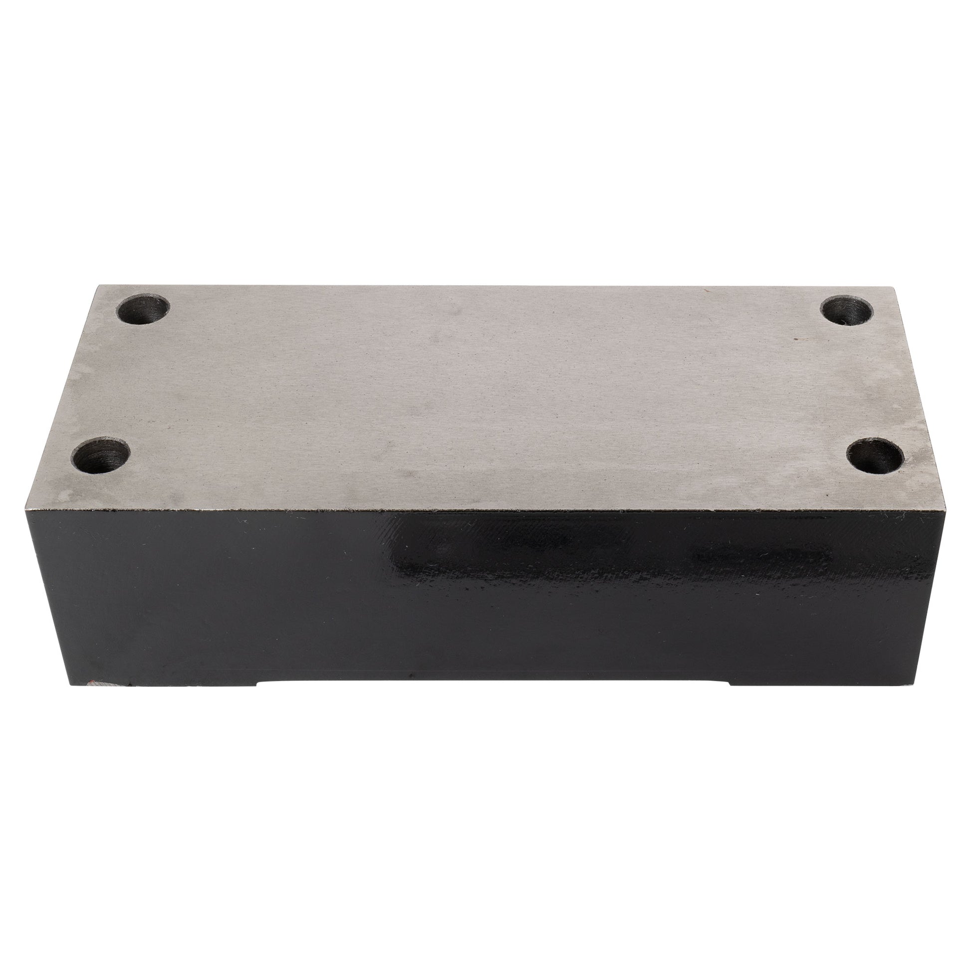

  • Adds 2" (50 mm) to the head space
  • For solid column bench mills
  • Includes proper mounting hardware
  • Fits HiTorque bench mills and SIEG SX2.7 mills
This riser block mounts between the base and the column, adding 50 mm (2") to the head room on the HiTorque Bench Mill.
This block is designed for the HiTorque bench mill column and SIEG SX2.7 bench mills.

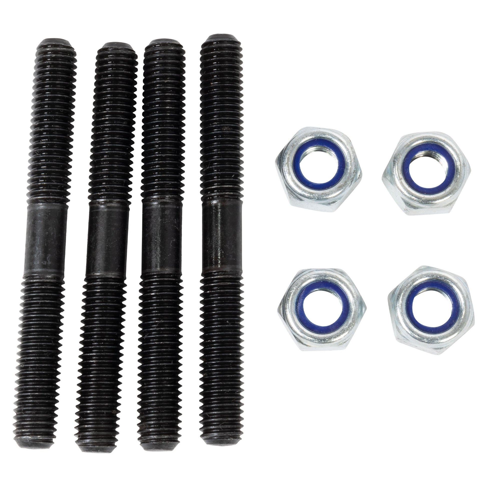

Mounting kit: four mounting studs and four locking nuts.
The studs are threaded on both ends and are M10 x1.5 thread, 90mm in length.
Length: 7.087" (180 mm)
Width: 3.031" (77 mm)
Height: 1.969" (50 mm)
Studs Threading: M10x1.5
Studs Length: 3.543" (90 mm)
