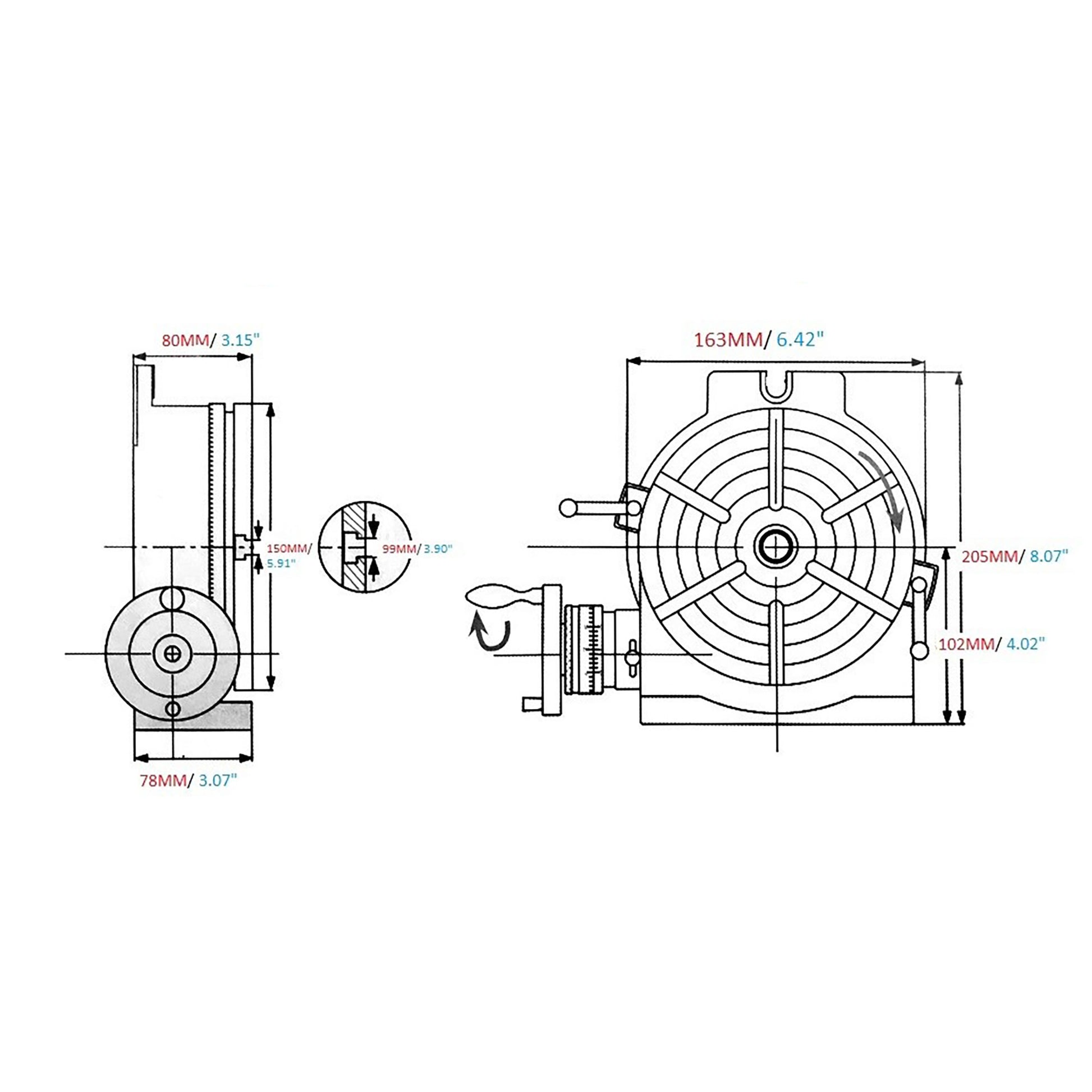

  • 6 inch horizontal / vertical rotary table
  • #2 Morse Taper center hole
  • 3 T-slots with 0.43" channels
  • Height 3.1", vertical height 7.8"
  • Gear ratio 90:1, 10 second vernier reading

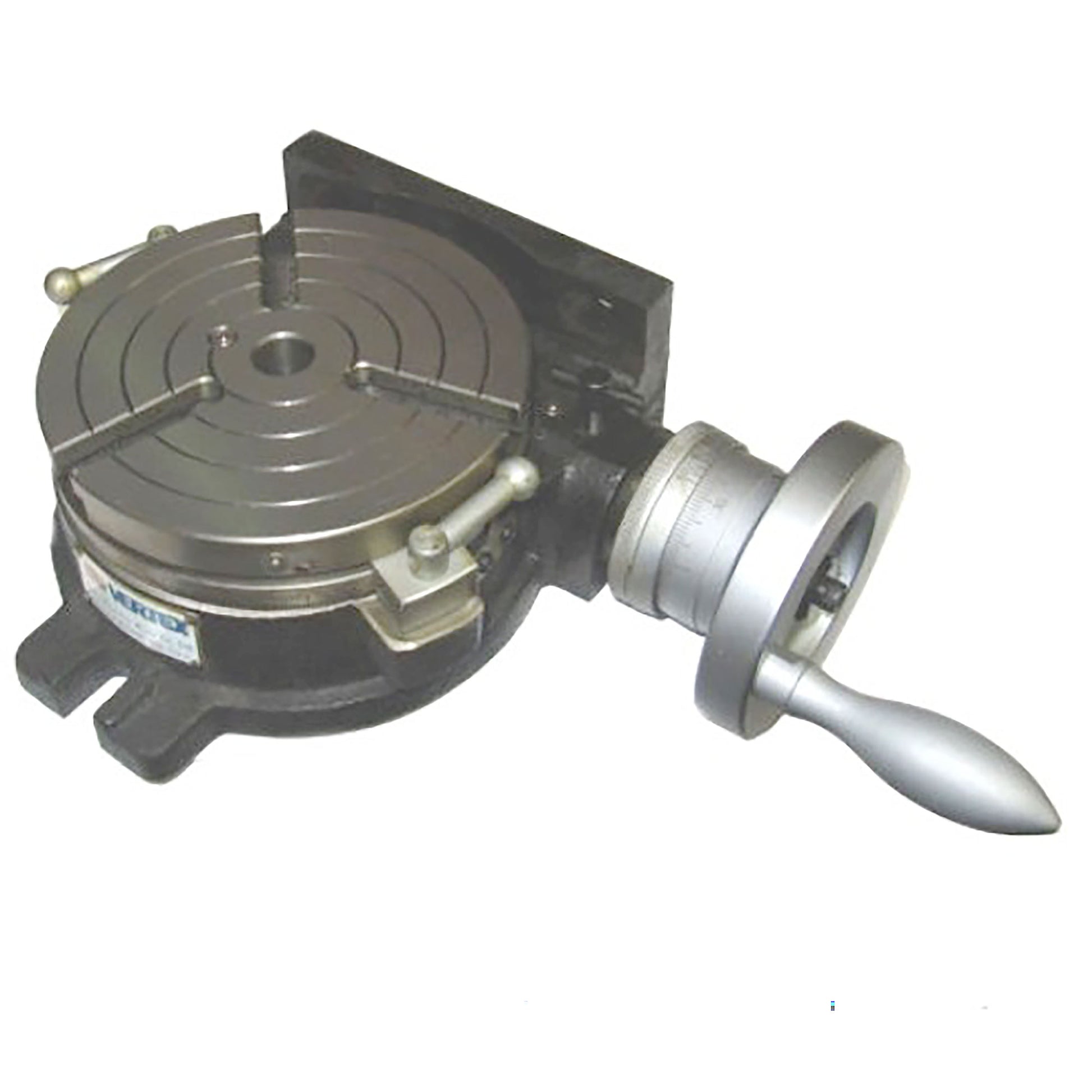

This 6" horizontal / vertical rotary table is for indexing, circular cutting, angle setting, boring, and spot facing operations. The cast iron table is precision machined in Taiwan and has a #2 Morse taper center hole. This 6" rotary table is graduated with a 360° scale. A micro collar graduated to one minute with a ten second accuracy vernier scale is provided. This horizontal/vertical rotary table has lock down clamps and the crank can be disengaged.
The worm gear and center hole are hardened and ground.

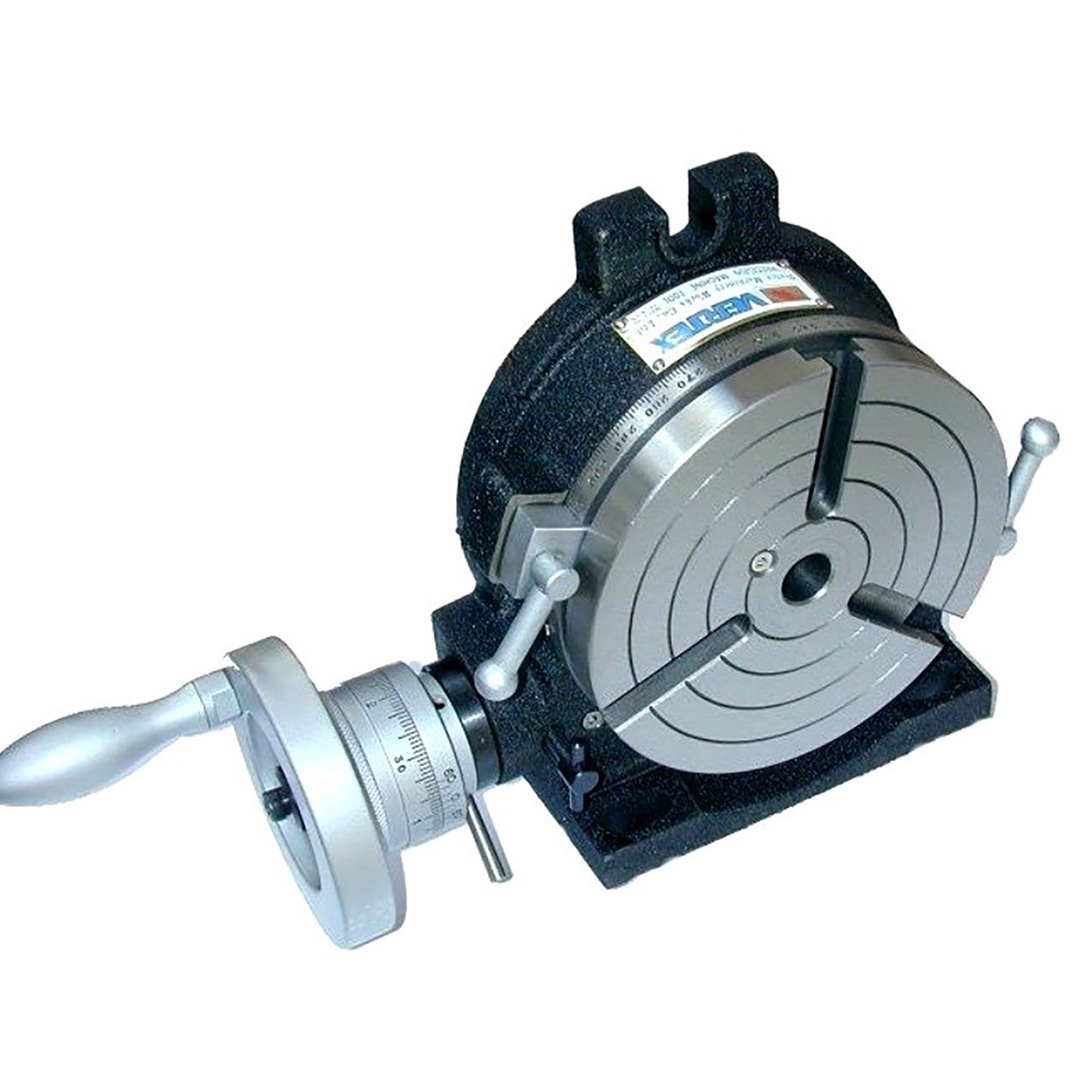

The 6" rotary table is 3.1" high when horizontal, and 7.8" when vertical. The centerline is 3.9" above the table when in the vertical position.
The worm ratio is 90 to 1 and one rotation of the handle equals 4 degrees on the collar.
There are three T-slots and each slot is 0.43" in width.
Flatness of clamping surface: 0.0006"
Parallelism of clamping surface to base: 0.0008"
Squareness of clamping surface to angle face: 0.0004"
Squareness of clamping surface to center slot: 0.0008"
Concentricity of center bore: 0.0008"
