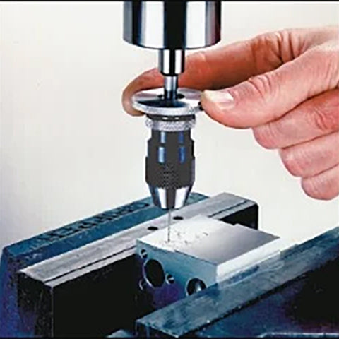

  • Drill small holes with ease and accuracy
  • Gives more control than coarser quill feeding

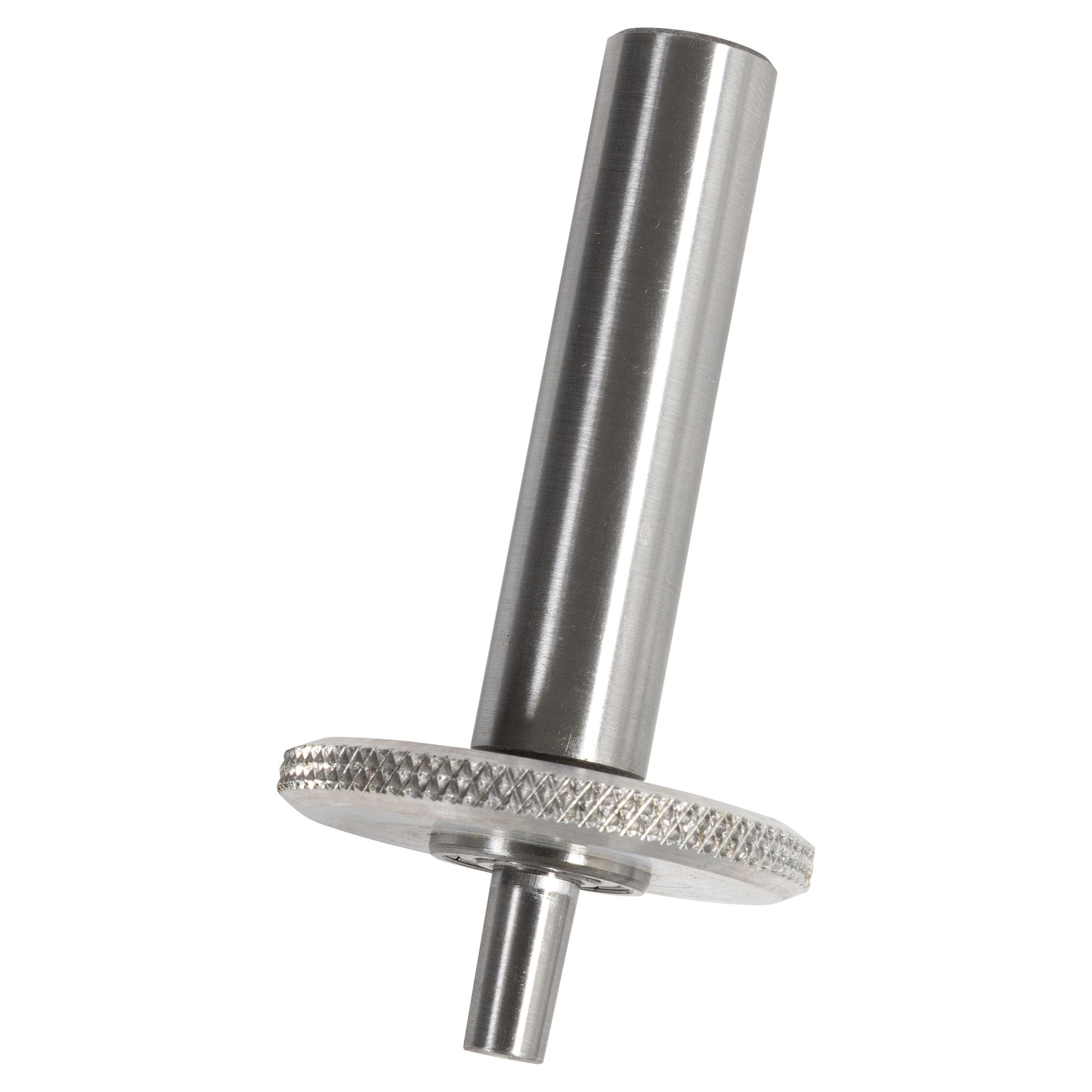

  • 1/2" shank, 0JT taper, 3/4" travel
  • Fingertip control helps prevent walking and deflection
  • Eliminates need for specialized drilling equipment for small holes
Drill small holes with ease using this sensitive drill feed. Designed to be combined with a 0 Jacobs Taper chuck, typically keyless, this feed gives the operator fingertip control over fine work and eliminates the need to rely on the more coarse quill feed of most drills and mills.
The design helps eliminate walking and deflection of drill since you have direct hand control near the point of contact.
The knurled ring and feed give a secure grasp yet the tool is sensitive to gentle finger pressure.
The feed is spring-loaded and retracts automatically when the ring is released.
The feed has 3/4" of travel, has a 1/2" shank and fits a 0JT drill chuck.
