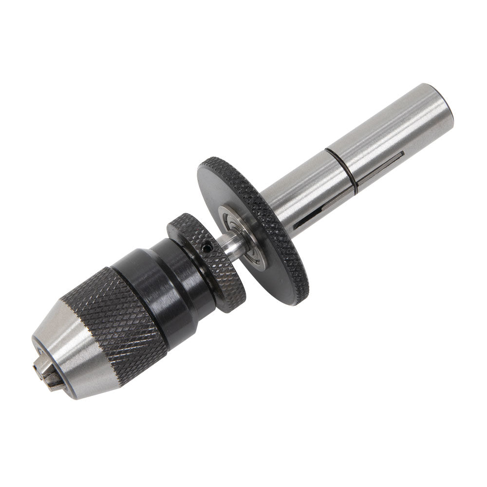

  • Fingertip control for drilling small holes
  • Helps prevent drill breakage
  • 0JT taper, 1/2" diameter precision ground straight shank
  • Spring loaded 3/4” travel fits most drills, mills, lathes or jig borers
  • Capacity: 0” - 1/8" (0 - 3mm ) Keyless drill chuck
Sensitive drill feed designed for drilling small holes combined with a 0"-1/8" (3 mm) capacity keyless drill chuck.

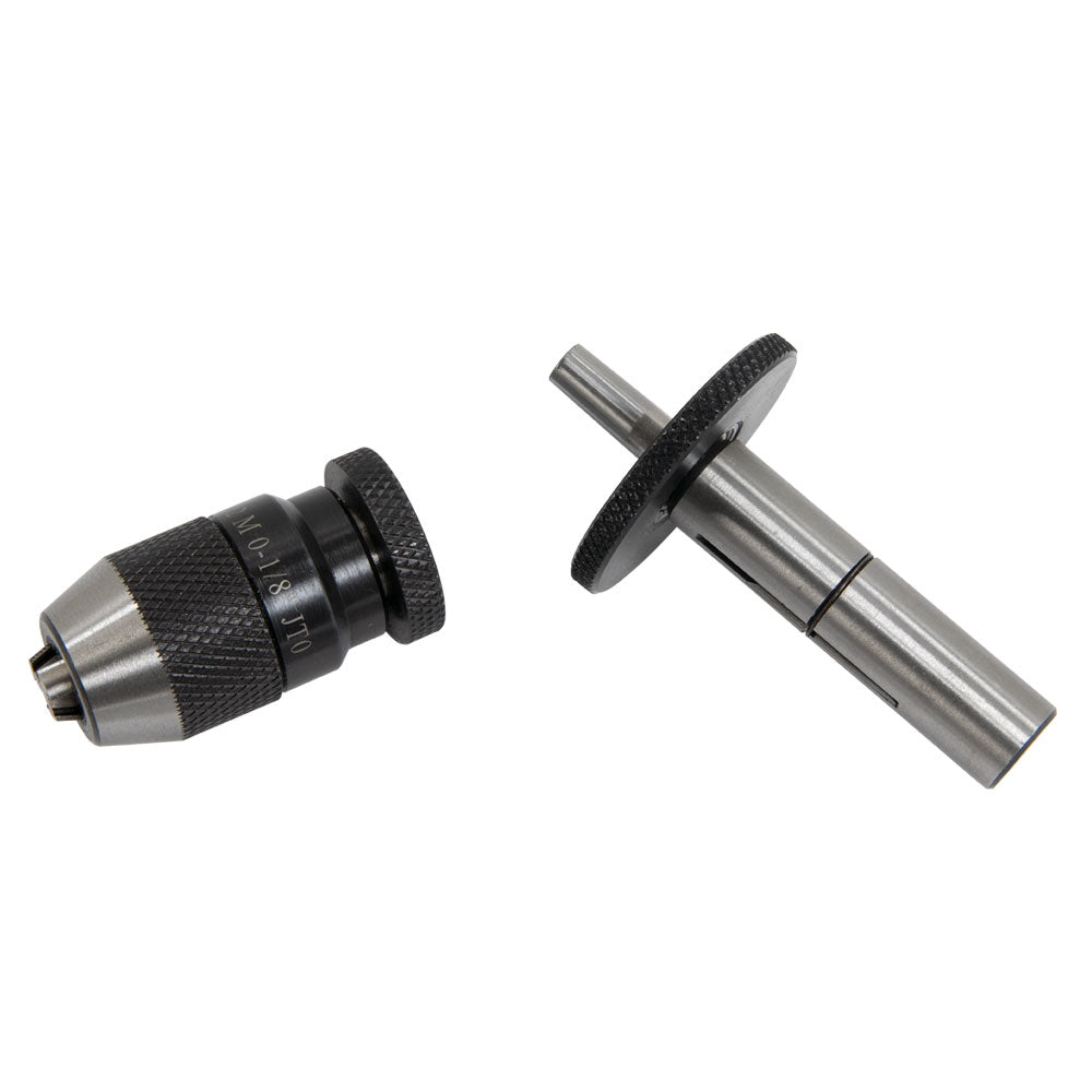

To use the sensitive drill feed, grasp the knurled ring and pull it down to feed the drill into the workpiece. The internal spring retracts the drill when the ring is released.
No chuck key is required with this self-tightening design. The chuck is made from hardened tool steel to ensure accuracy and extended life.
The rated capacity of the drill chuck is 0 to 3 mm. Number 0 Jacobs taper mount. 0.003" (0.075 mm) overall maximum runout.
This thing is great for drilling small holes. It virtually eliminates broken drill bits because it gives you much better feedback than a drill press or milling machine.
The sensitive drill feed incorporates a spring to retract the drill chuck. The spring that is in the sensitive drill feed is quite light. It will not support the weight of the small keyless drill chuck. It will probably support a small keyed chuck.
The light spring is not necessarily a problem. If the sensitive drill feed is used with a lathe, the spring is just fine. And when used in a drill press or mill, it gives you the most control over the drilling operation.
