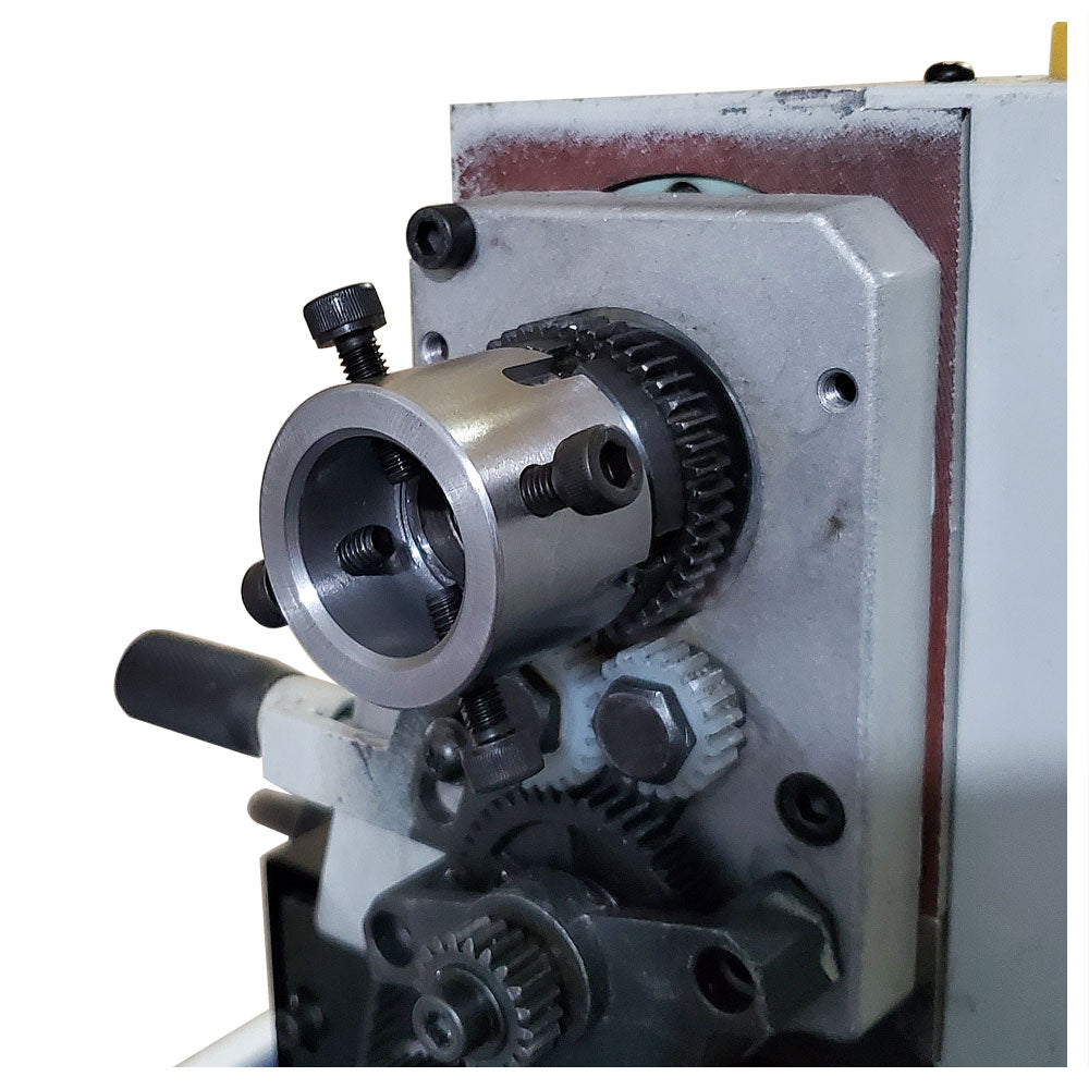

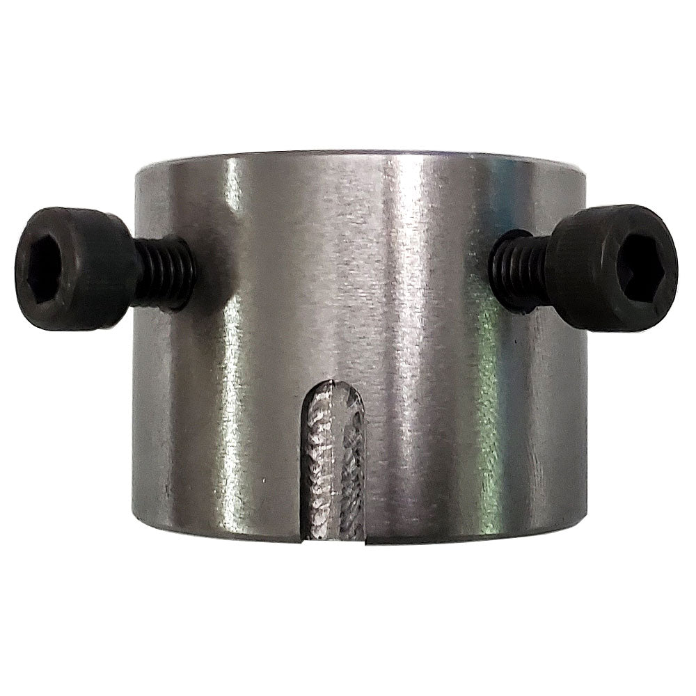

  • Spider for back of mini lathe spindle
  • Use to support long stock through spindle

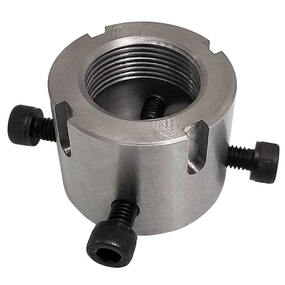

  • Replaces 2nd spindle nut (M27x1.5 thread)
  • 3/4" (20 mm) diameter capacity

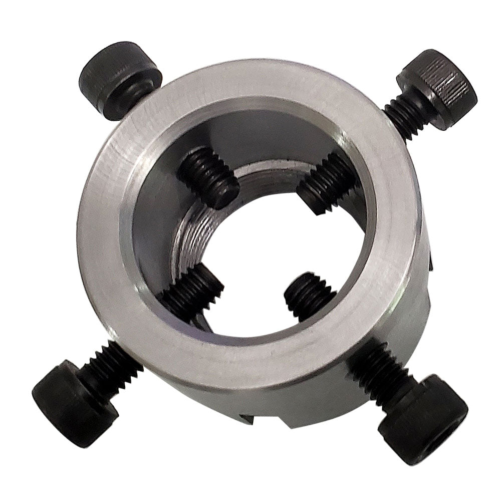

  • Uses M6x20 cap screws
Mini lathe spindle spider. Made for LittleMachineShop.com and designed specifically for the HiTorque 7x12/14/16 and SIEG C2/C3 mini lathe spindle.
Use this spider to support long stock extending out the back of the spindle. The spider has a 3/4" (20 mm) diameter capacity with four adjustment screws sized M6x20.
Mount on back of spindle by removing and replacing one of the M27x1.5 spindle locking nuts (1329). Once attached to spindle, stock is secured by four cap screws.
* NOTE: Requires having change gear door open during operation. Mounted Spider shown is for mini lathe.
