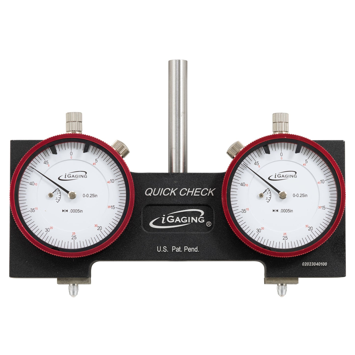

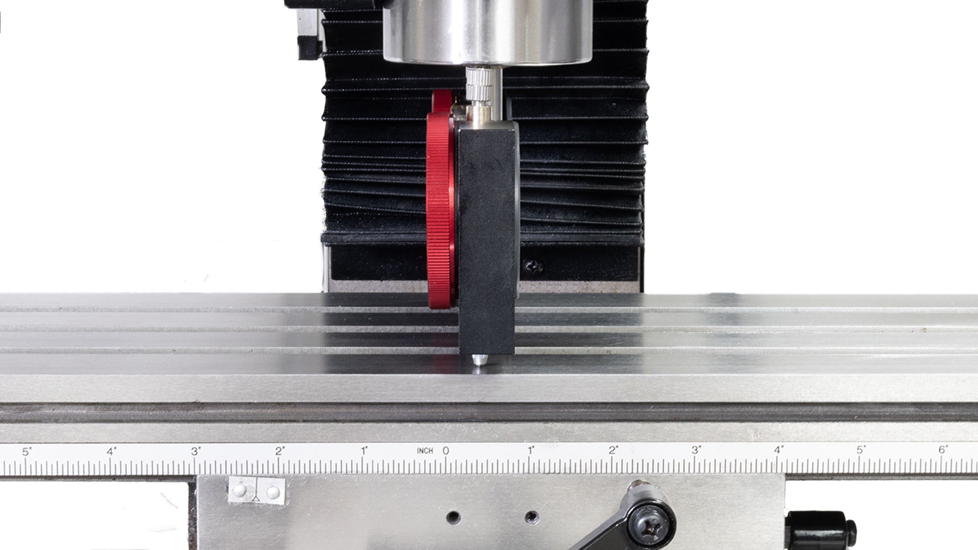

  • Pre-Calibrated for perfect flatness and squareness
  • 3/8" dia. shank
  • 4" distance between contact points
  • Range: 0 - 0.25, Graduation: 0.0005"
  • Graduation: 0.0005"

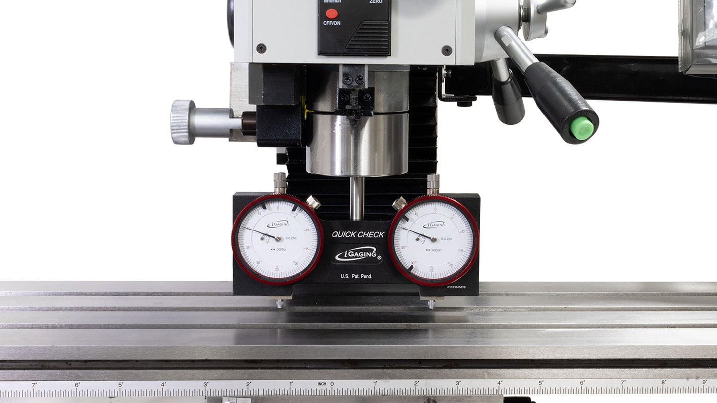

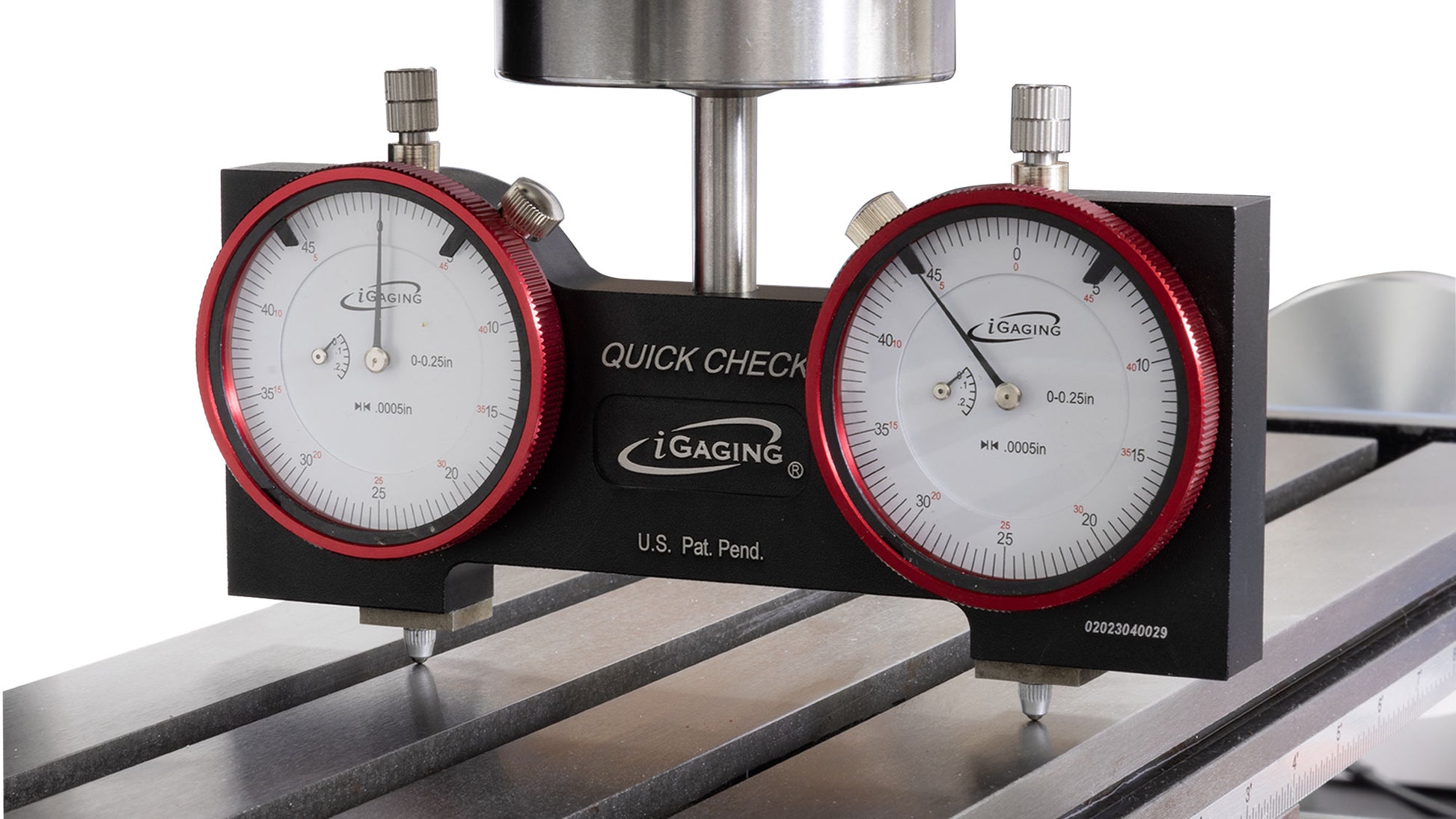

Zeroing the Spindle to square is the key to excellent milling. With this product you can square the spindle on any mill or CNC router that will hold a 3/8" shank. Pre-Calibrated for perfect flatness and squareness
Includes two AGD group 2 indicators•
  • Range: 0 - 0.25"
  • Reading: 0 - 50

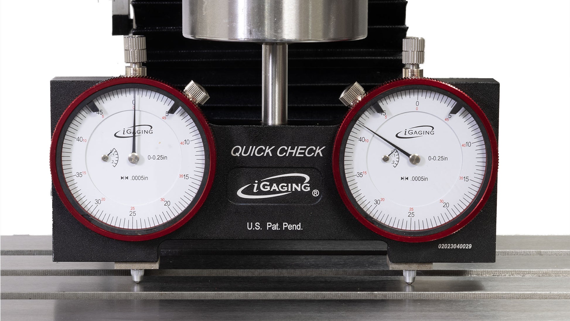

  • Squareness: <=0.0005"
Precision CNC solid aluminum body with black anodized finish and 4" distance between contact points.
  • Revolution counter
  • 3/8" dia. shank
  • Carbide contact points

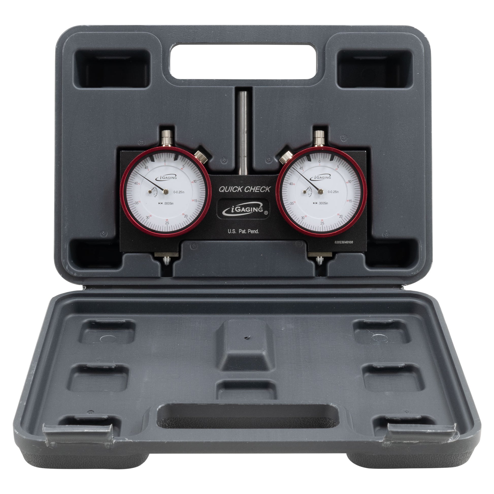

Supplied in fitted case
This handy tool gives quick reference to a surface at a distance of 4". It is ideal for use on plates or other surfaces where the perpendicularity is over a shorter distance.
