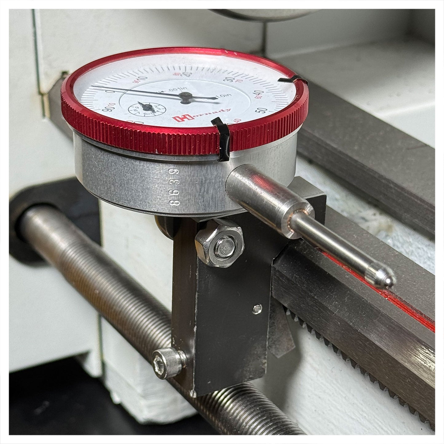

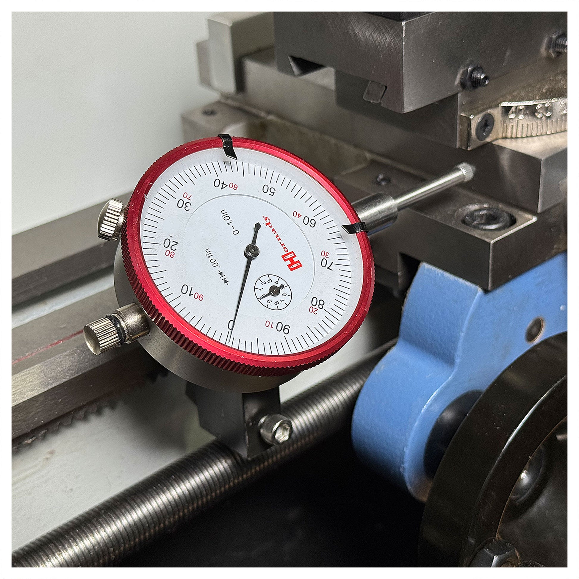

  • Add precision depth control to your turning, threading, grooving, etc. operations.
  • Very helpful on older or worn machines with less reliable handwheel measurements
  • Installs easily with no drilling or modification to the carriage.

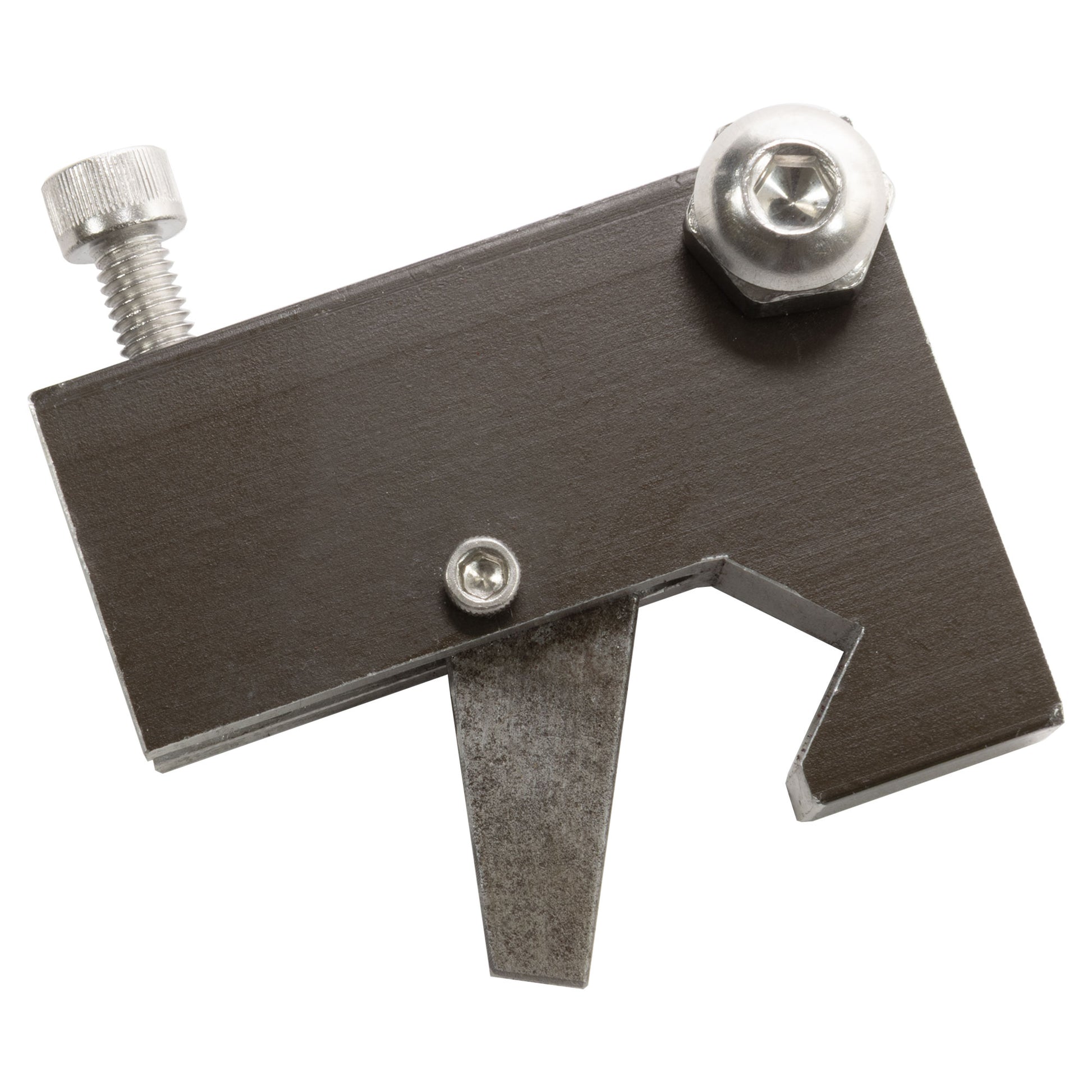

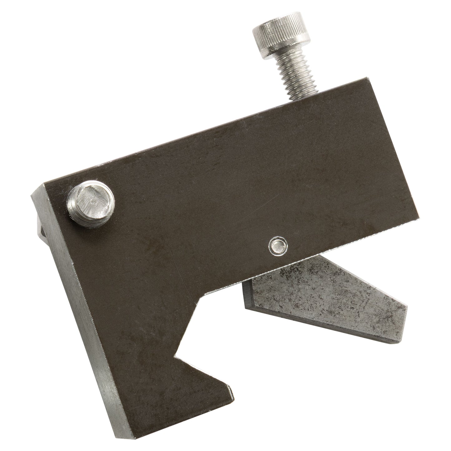

Mini lathe carriage indicator holder and hard stop. Use this to mount your dial indicator on the lathe's prism ways to measure fine carriage movement. For example, very specific turning or threading distances, boring depths, etc. Very helpful on older or worn machines with less reliable handwheel measurements.
  • Doubles as a hard stop using the included screw and nut.
  • Installs easily, clamps to the prism way via a cantilever jaw.
  • Designed for most 7x mini lathes and uses standard 2" Indicator with lug back.
  • Made from reclaimed aluminum saved from the landfill.
