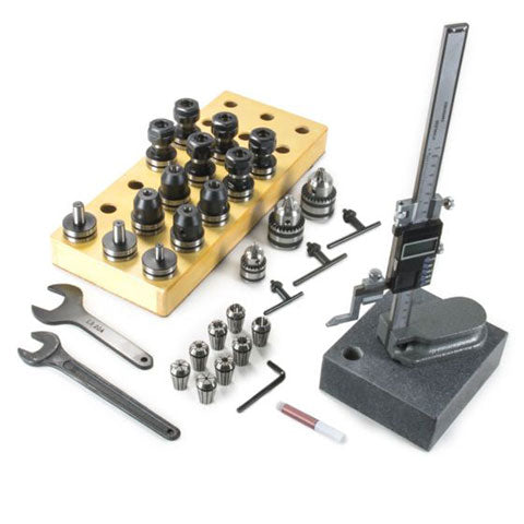

  • Complete set for CNC operations includes 13 tool holders
  • Minimal clearance height for tool change
  • Repeatable tool positioning
  • All tool holders are hardened and precision ground
  • Tool height presetting set included
CNC operations work best with one holder for each tool in order to make use of the tool length compensation table in the CNC controller. This function also requires a system for measuring the mounted tools. The CNC set includes a total of 13 tool holders plus a tool measuring set.
The Tormach Tool Assistant Set includes 8" digital height gauge (measurement accuracy +/-0.0005"), USB interface cable with touch trigger, manual, and Tool Assistant software.
  • 2 3/8” Set Screw Tool Holders
  • 2 1/2” Set Screw Tool Holders
  • 6 ER20 Collet Holders
  • 8 of the most popular ER20 collets (2 ea of 1/8”, 1/4”, 3/8”, 1/2")
  • 3 drill chucks and JT adaptors
  • 8” Digital Height Gauge
  • Compact Granite Surface Plate with integrated locating hole
  • TTS Tool Tray
  • Tormach Tool Assistant Software for PC and Manual
  • USB interface cable with touch trigger
  • Wrenches and installation tools
This is an outstanding value and a great way to get started with a CNC that has been retrofitted from a manual machine. If your CNC machine supports a tool offset table but you’re not using it, then you’re not realizing the full benefit of CNC machining.
Tool switching with the Tormach Tooling System (TTS) is extremely easy: Simply loosen the drawbar, slide out the current tool holder, then slip in the next and retighten. The unique geometry of the TTS tool holder ensures that, as the drawbar is tightened, the tool holder moves into an exact Z height while increasing rigidity. Each TTS holder has a shoulder that is undercut so it contacts the spindle itself, not the end of the collet. As the drawbar is tightened the collet will simultaneously squeeze the shank and be pulled upward into the spindle taper. This simultaneous action, grasping while moving up, pulls the tool holder tightly against the spindle face. The high-pressure contact between the shoulder of the tool holder and the spindle is the equivalent of a zero tolerance fit; the vertical location (Z-height) of the tool is exact. The initial placement, created by simply sliding the tool holder up until it stops, is normally within a few thousandths of an inch. The final location, after tightening the collet, is exact, highly repeatable, and not affected by the variable tension of the drawbar or wear on the collet.
