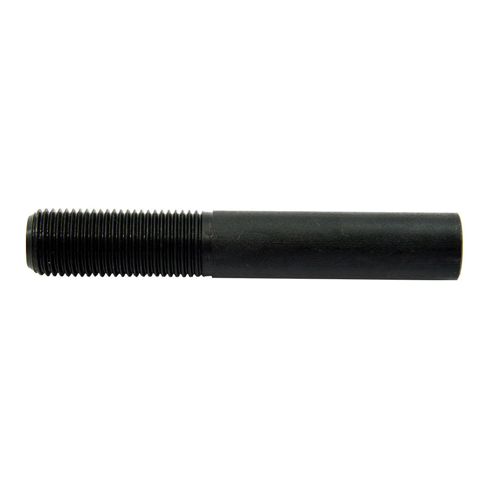

- Makes AXA QCTP a bolt-on accessory for 9x20 lathes
- Threads over standard tool post stud
- Outside thread is 9/16"-18
This tool post mount is internally threaded M8 to thread over the standard tool post mounting stud on a 9x19 or 9x20 lathe. The external thread mates with the nut furnished with our AXA quick change tool post.
The outside thread is 9/16"-18. The inside thread is M8-1.25. The post is 3.5" long.
