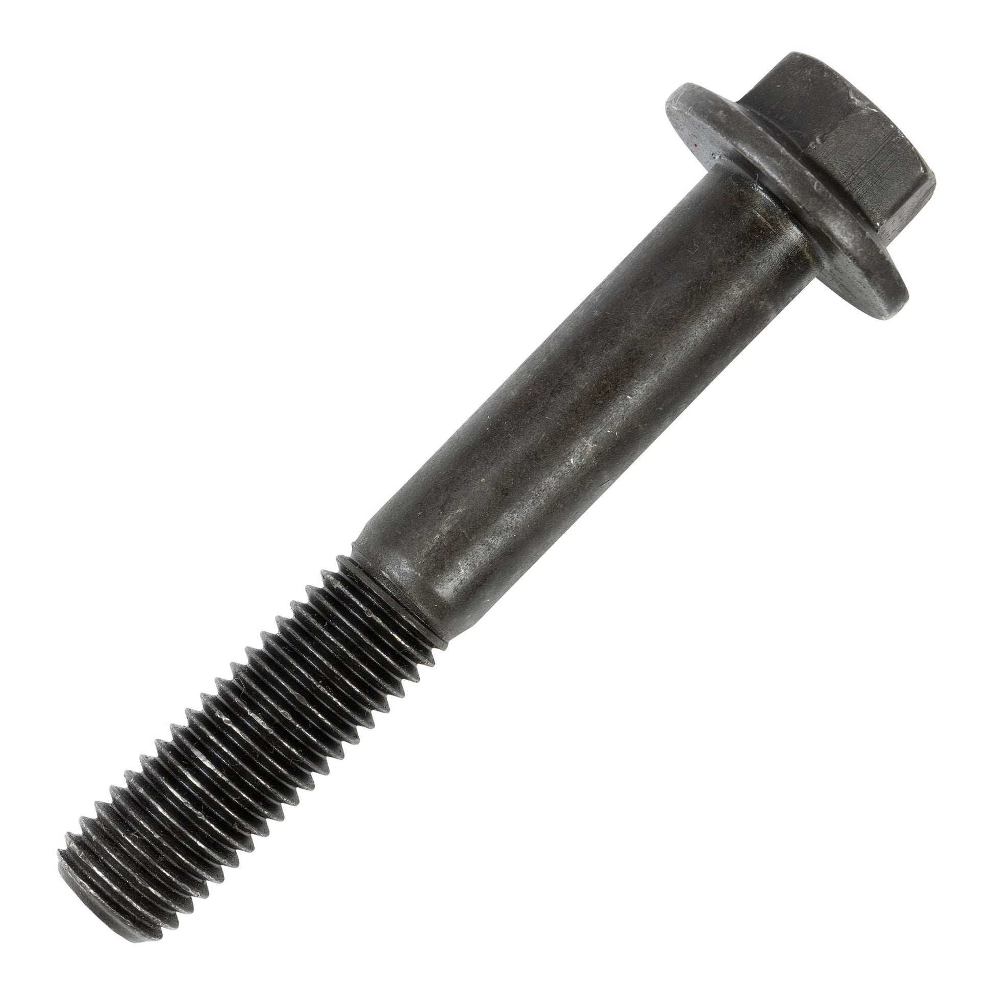

  • Makes AXA QCTP a bolt-on accessory for HiTorque 9x20 lathes
  • Threads through tool post into compound rest
  • Outside thread is 14mm x 2mm
  • Length: Shaft (90mm/34mm threaded), Bolt Head (12.88mm)
  • Hex head is 18mm
Black-phosphate class 10.9 steel bolt which is run through the middle of the AXA tool post into the 14mm x 2mm threading of the compound rest.
The shaft length is 90mm with min. thread length of 34mm. The hex head height is 12.8mm with an 18mm hex head and a 30.5mm flange.
Material: Class 10.9 Black-Phosphate Steel
Thread Direction: Right
Thread Size: M14
Thread Pitch: 2 mm
Thread Fit: Class 6g
Length: 3.543" (90 mm)
Threading: Partially
Min. Thread Length: 1.339" (34 mm)
Head Width: 0.709" (18 mm)
Head Height: 0.504" (12.8 mm)
Flange Diameter: 1.201" (30.5 mm)
Strength Grade/Class: Class 10.9
Hardness: Rc 32
