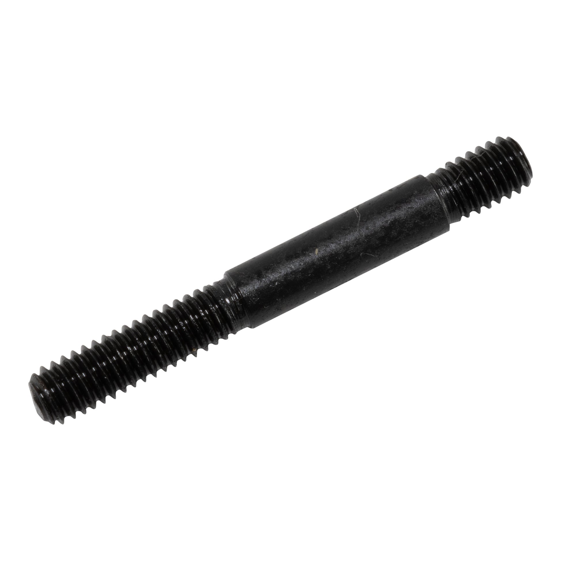

  • Double Ended Stud, M4x28
  • Nominal length 28 mm, Diameter 4 mm
  • Long threaded section 14 mm
  • Unthreaded section 14 mm
  • Short threaded section 4 mm
Double ended stud. The stud is M4x28. Here are the specific dimensions.
  • Long threaded end 14 mm
  • Short threaded end 4 mm
  • Unthreaded portion 14 mm
See Chris' tips on measuring double ended studs.
Double ended studs that conform to DIN 938 have two external threaded sections divided by an unthreaded section.
The short threaded section is fixed in length of 1 x diameter. The short end is typicalled installed into a tapped hole or fitting. The length of the long end will vary depending on the length of the stud.
Both ends are designed for internally threaded fasteners such as a nut or a bracket.
The nominal length of the stud is the calculated by adding the length of the unthreaded section plus the long threaded section.
