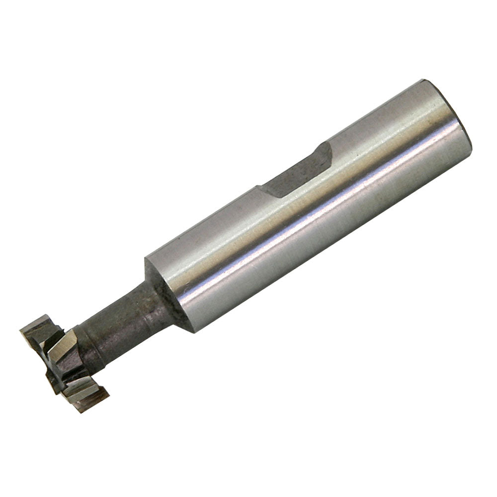

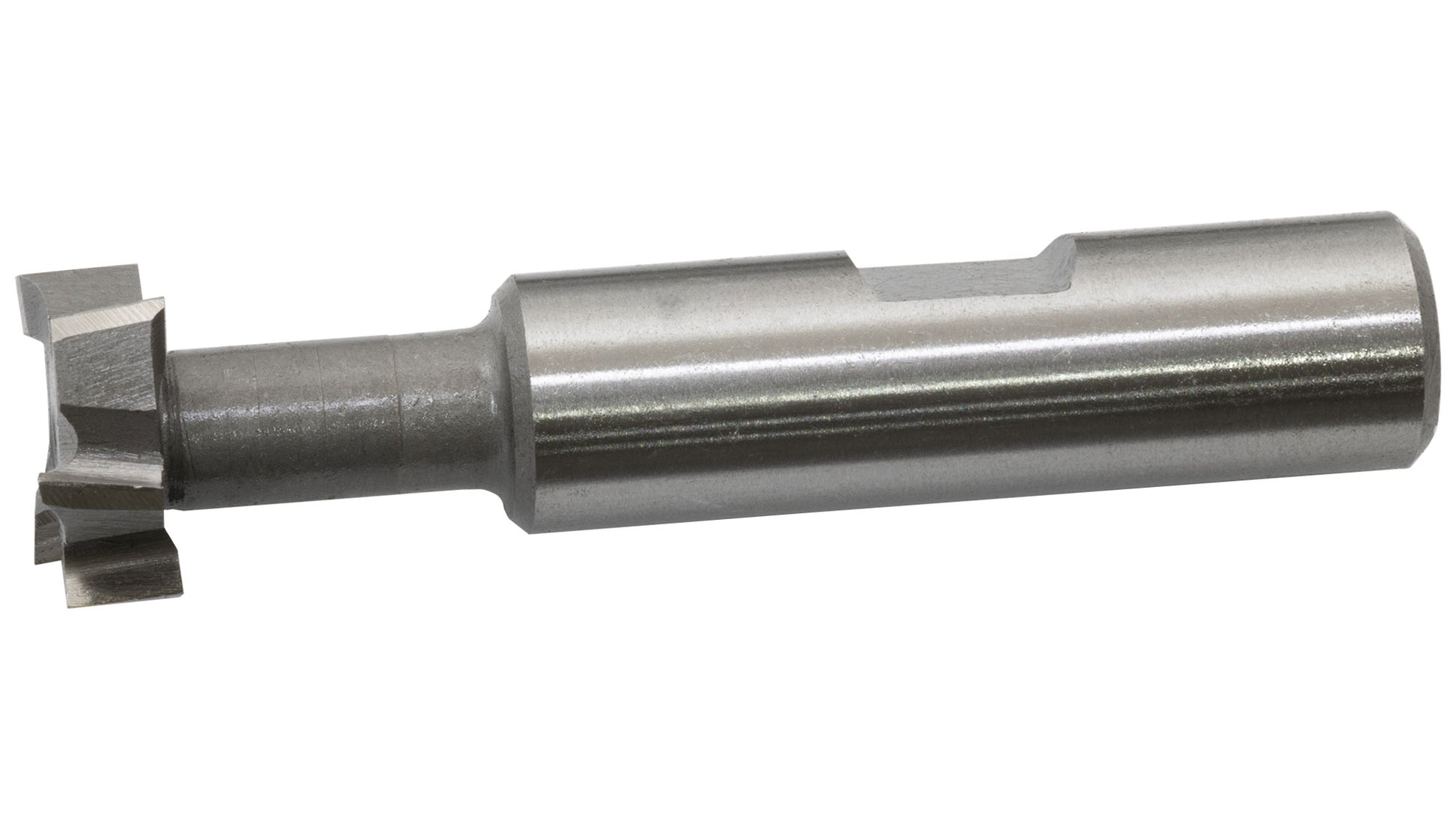

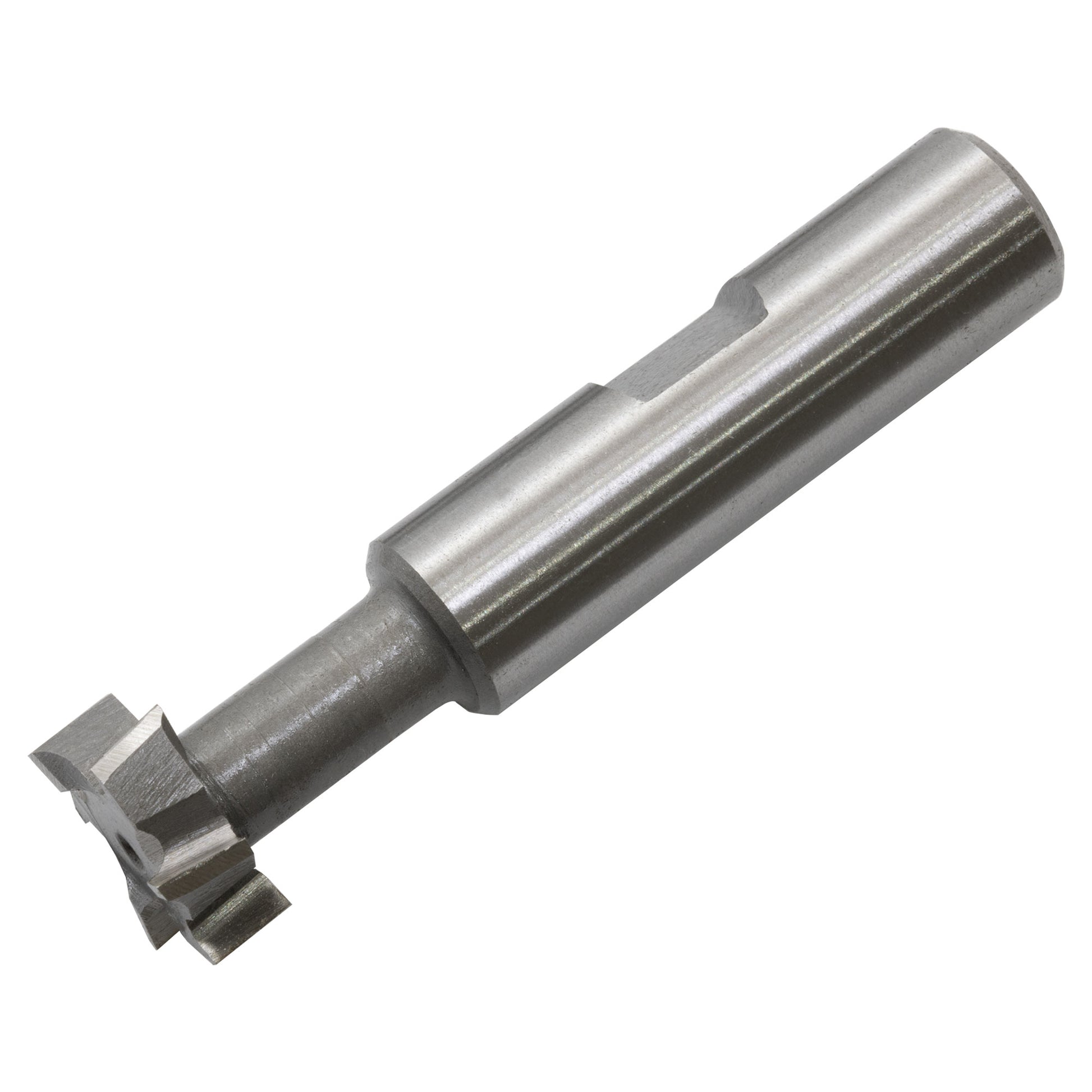

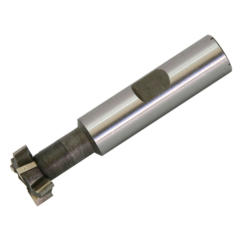

- High speed steel T-slot cutters
- Positive radial rake, right and left hand spiral.
- Weldon Shank

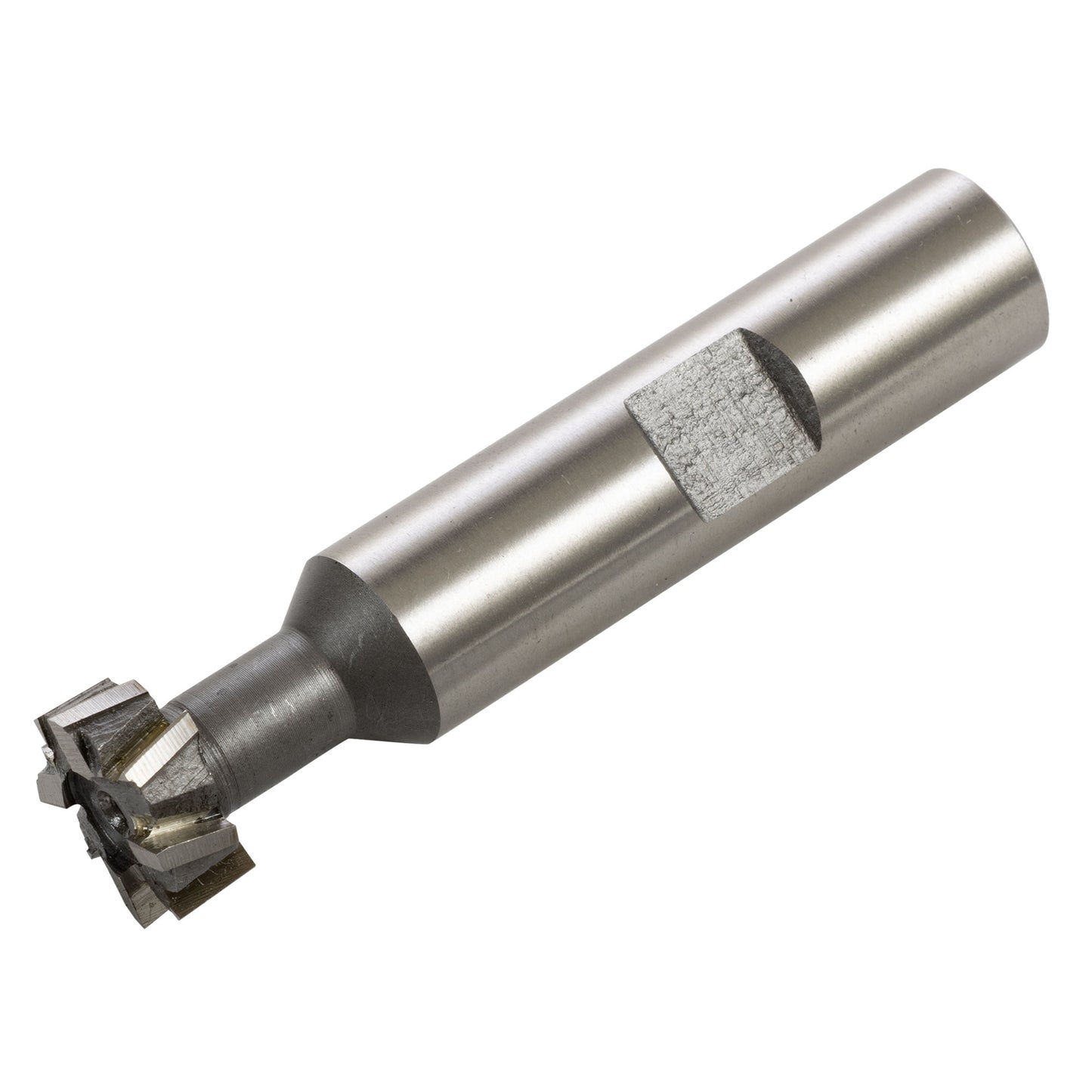

T-slot cutting tools are designed to make T-slots in tables and beds.
Two milling cutters are required for milling T-slots, an end mill and a T-slot cutter. A 1/4" vertical slot is milled into the piece so that the neck and shank of the T-slot cutter can enter.

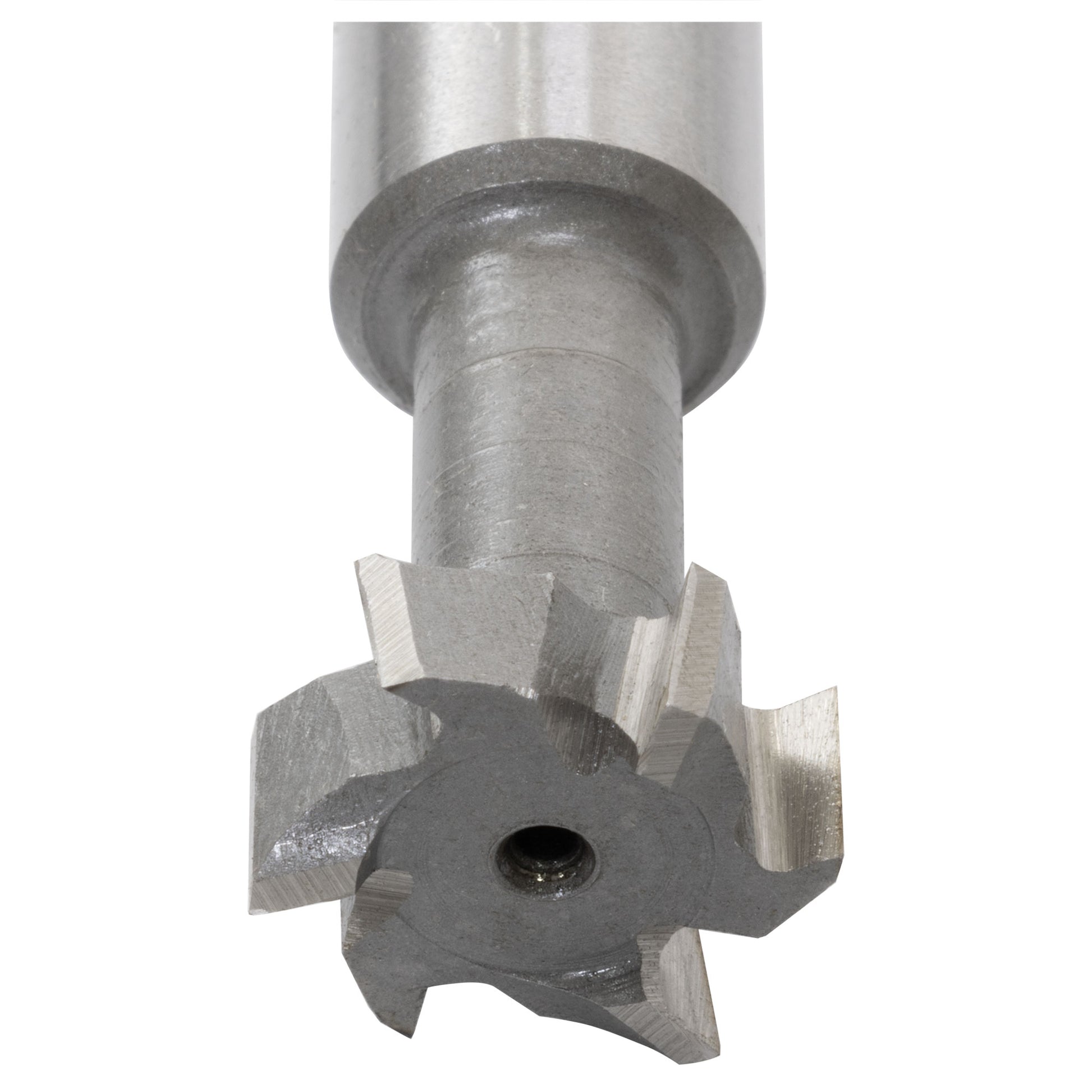

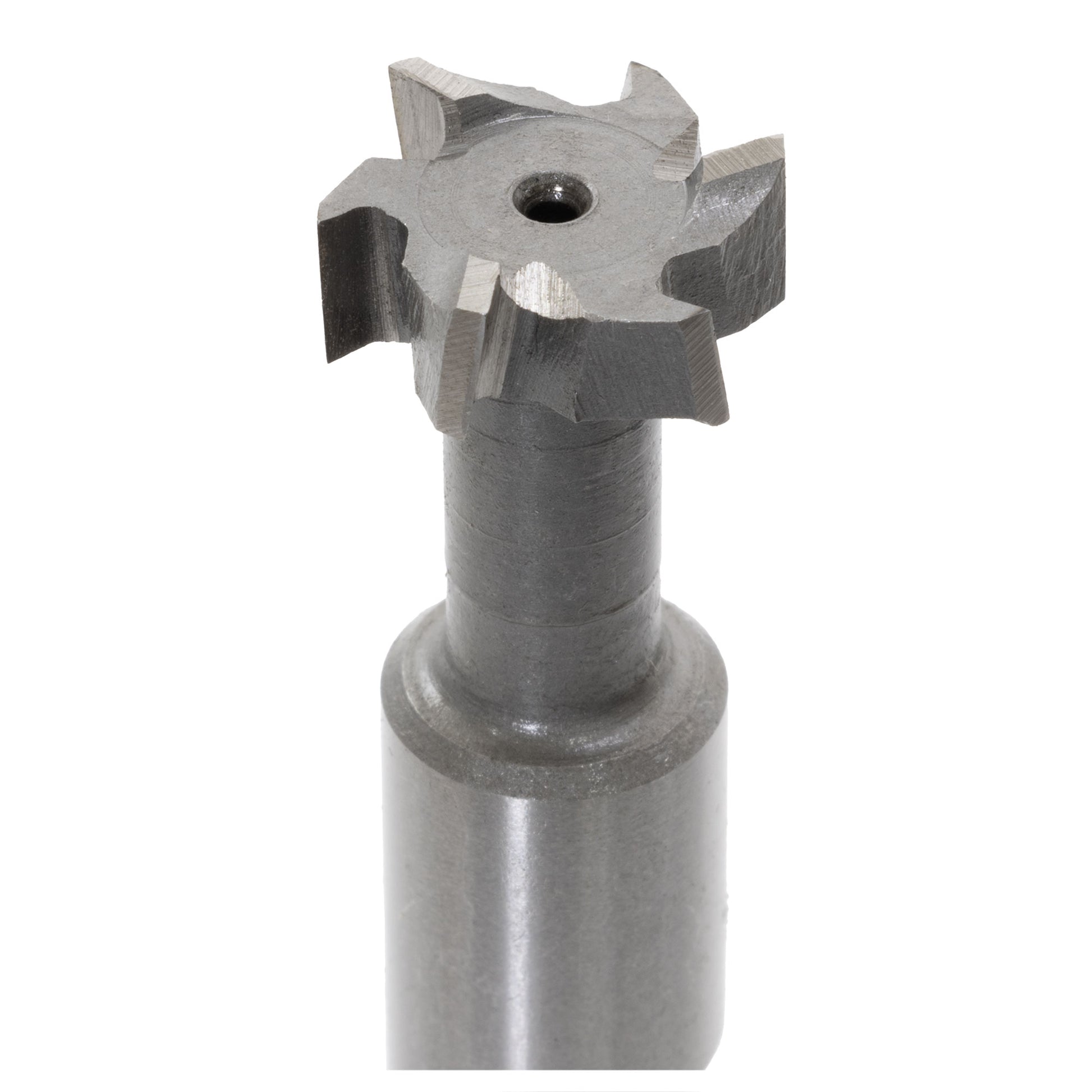

These T-slot cutters have a positive radial rake, right and left hand spiral with alternate side cutting teeth for maximum chip clearance.
The listed dimension is the width of the T-slot measured at the top of the T-slot.
T-Slot Width: 0.315" (8 mm)
Cutting Diameter: 0.563" (14.300 mm)
Cutter Width (Depth): 0.2344" (5.954 mm)
Bolt Size: M6
Neck Diameter: 0.266" (6.75 mm)
Shank Diameter: 0.50" (12.70 mm)
Undercut Length: 0.547" (13.89 mm)
Overall Length: 2.5938" (65.883 mm)
