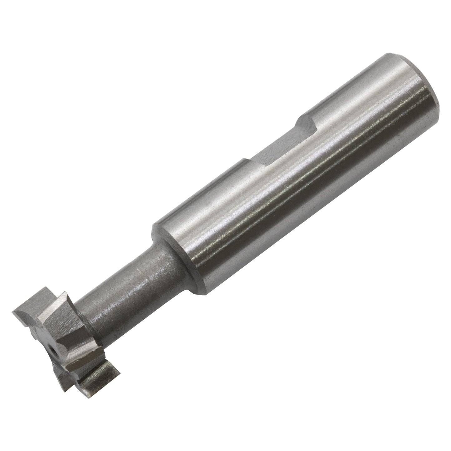

  • High speed steel T-slot cutters
  • Positive radial rake, right and left hand spiral.
  • Weldon Shank
T-slot cutting tools are designed to make T-slots in tables and beds. Two milling cutters are required for milling T-slots, an end mill and a T-slot cutter. An 1/4" vertical slot is milled into the piece so that the neck and shank of the T-slot cutter can enter.
These T-slot cutters have a positive radial rake, right and left-hand spiral with alternate side cutting teeth for maximum chip clearance.
The listed dimension is the width of the T-slot measured at the top of the T-slot. Additional dimensions in the Specifications
T-Slot Cutter, 1/4" T-slot, HSS
• Cutting diameter 9/16", cutting width 15/64"
• Neck diameter 17/64", shank diameter 1/2"
• Undercut length 35/64", OAL 2-19/32"
• 6 Teeth
• T-Nut bolt size 1/4"
T-Slot Cutter, 5/16" T-slot, HSS
• Cutting diameter 21/32", cutting width 17/64"
• Neck diameter 21/64, shank diameter 1/2"
• Undercut length 39/64", OAL 2-11/16"
• 8 Teeth
• T-Nut bolt size 5/16"
T-Slot Cutter, 3/8" T-slot, HSS
• Cutting diameter 25/32", cutting width 21/64"
• Neck diameter 13/32", shank diameter 3/4"
• Undercut length 3/4", OAL 3-1/4"
• 8 Teeth
• T-Nut bolt size 3/8"
