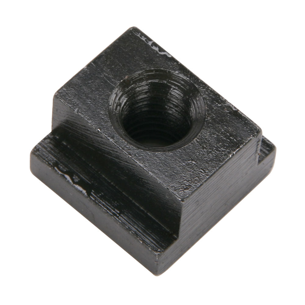

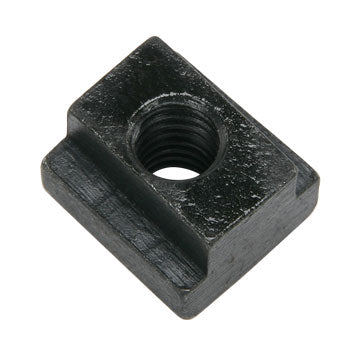

  • Black oxide finish
  • Heat treated 1040 steel
  • Case hardened
We carry a wide range of T-Slot nuts in both inch and metric measurements.
They are heat treated and have a black oxide finish.
The stated dimension of the T-slot nut is the width at the top of the T-slot.
Measure the width at the top of the T-slot on your mill table as shown in the photo below.
This is the dimension given for T-slot nuts and clamping kits. For example, if you measure 0.468 at the top of the T-slot, you should get a 7/16” (0.438”) T-slot nut or clamping kit.
