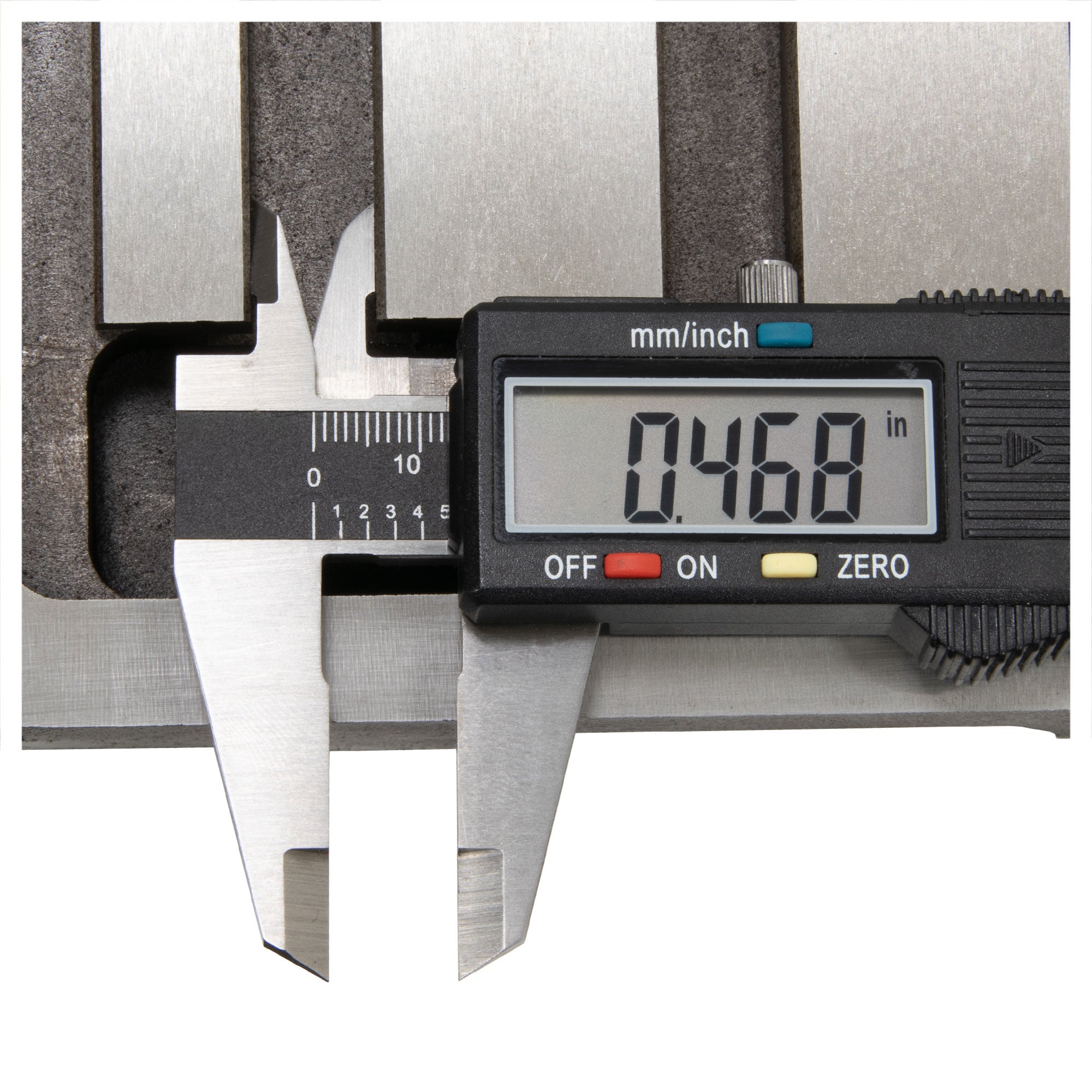

Measure the width at the top of the T-slot on your mill table as shown in the photo below.
This is the dimension given for T-slot nuts and clamping kits. For example, if you measure 0.468 at the top of the T-slot, you should get a 7/16” (0.438”) T-slot nut or clamping kit.
T-slot measuring
