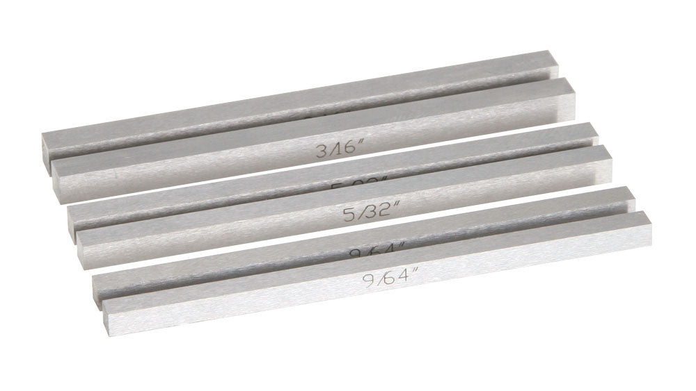

  • Shims are 9/64" , 5/32" and 3/16" square and 3" long
  • Made of high grade alloy steel hardened to 52 to 58 Rc
  • Parallel within 0.0002". The pairs are matched in height within 0.0002"
These shims multiply the options for your 3" long thin parallels. You can now space your work by 1/64".
Vise jaws are often too deep for the work. In general, you want the top of the work piece to extend above the top of the vise jaws. To fill the gap from the bottom of the work piece to the "ways" of the vise, you use parallels.
Parallels are strips of metal that have been carefully ground so that the top and bottom edges are parallel with very tight tolerances. They usually come in matched pairs. Place one parallel adjacent to each jaw in the vise and place the work piece so it rests on the parallels.
