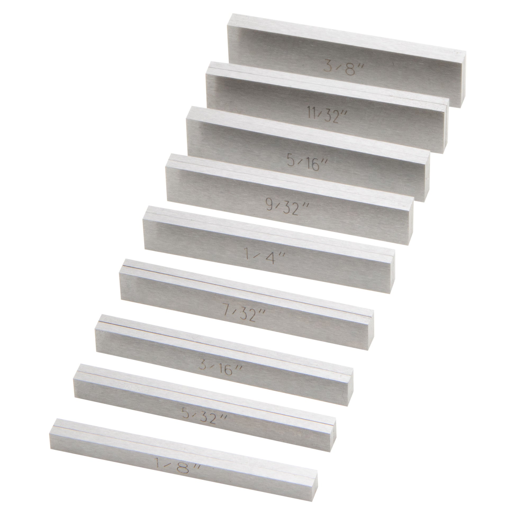

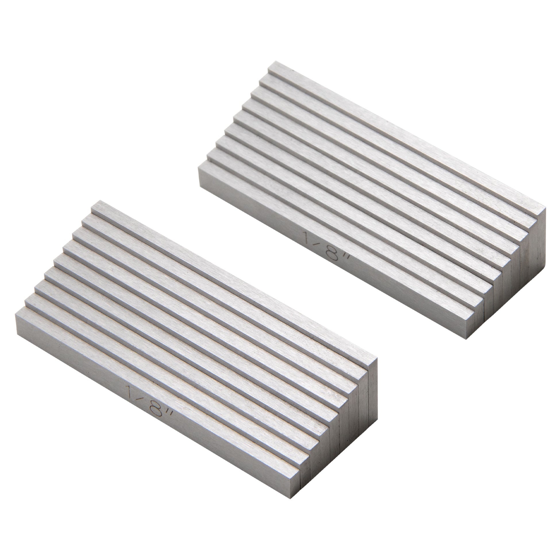

- Nine pairs thin parallels
- Length: 1.5", Width 1/16"
- Heights range 1/8" - 3/8"
- High grade alloy steel
- Parallel top and bottom within 0.0002"
Set of nine pairs of thin parallels. Each parallel is 1.5" long and 1/16" wide. The height of the parallels range from 1/8" to 3/8" in the following sizes: 1/8", 5/32", 3/16", 7/32", 1/4", 9/32, 5/16", 11/32", 3/8".
Made of high grade alloy steel hardened to 52 to 58 Rc. Parallel within 0.0002" on the top and bottom. The pairs are matched in height within 0.0002"
These 1.5" long parallels are great for miniature vises such as the 2" screwless vises.
*Case not included.
