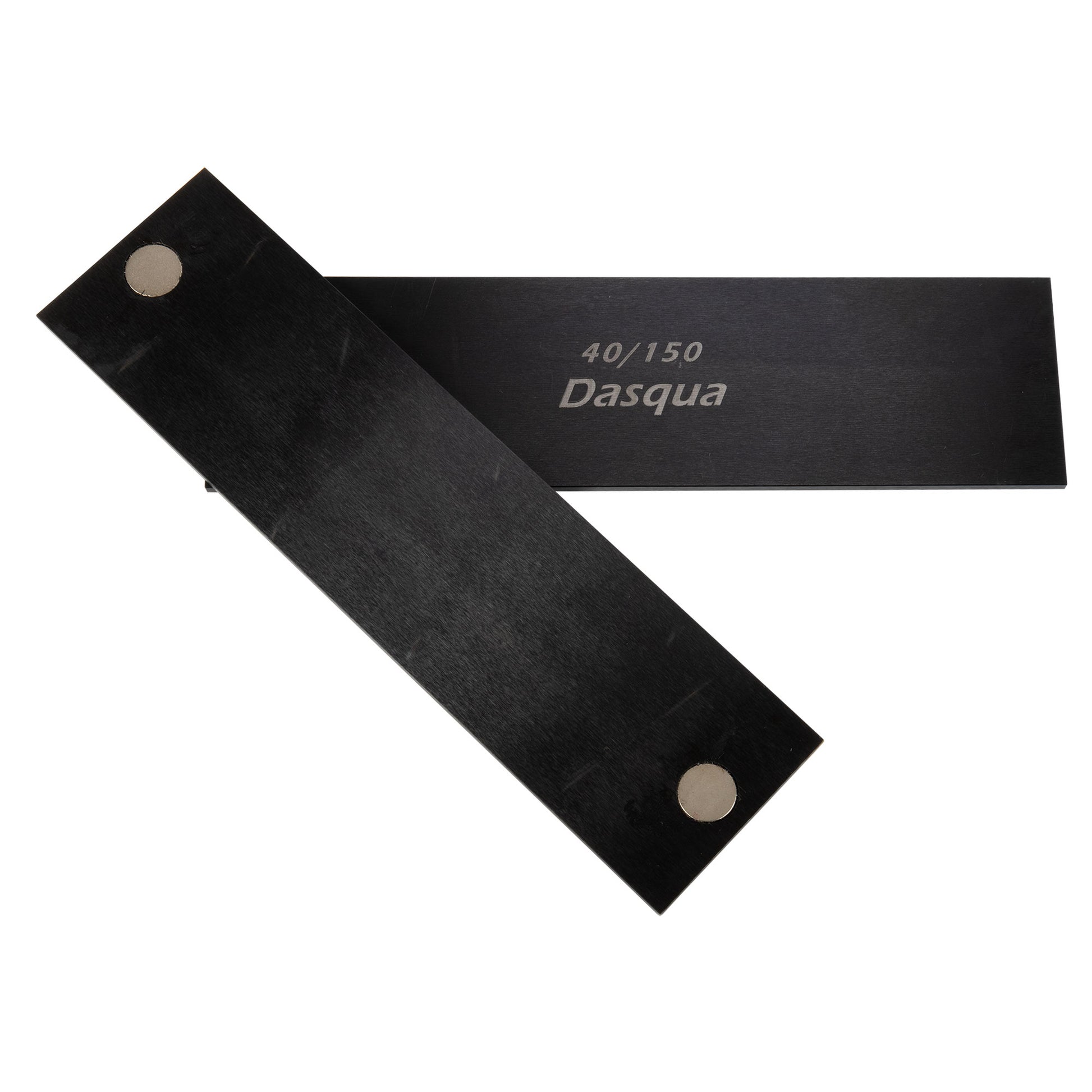

  • Five pairs thin parallels
  • Length: 150mm (6"), Widths 2.5mm (0.1")
  • Heights range from 25mm - 47mm (1" - 1.85")
  • Height tolerance +/- 0.005mm
  • Width tolerance +/-0.01mm
Dasqua 150mm Length X 2.5mm Width 5 Piece Premium Magnetic Parallel Set. Excellent in high precision work for mounting parallel components in machine vises or jigs. Newly designed embeded magnets leaving your hands for clamping and setting up reduce the clamping time significantly

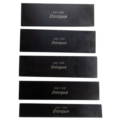

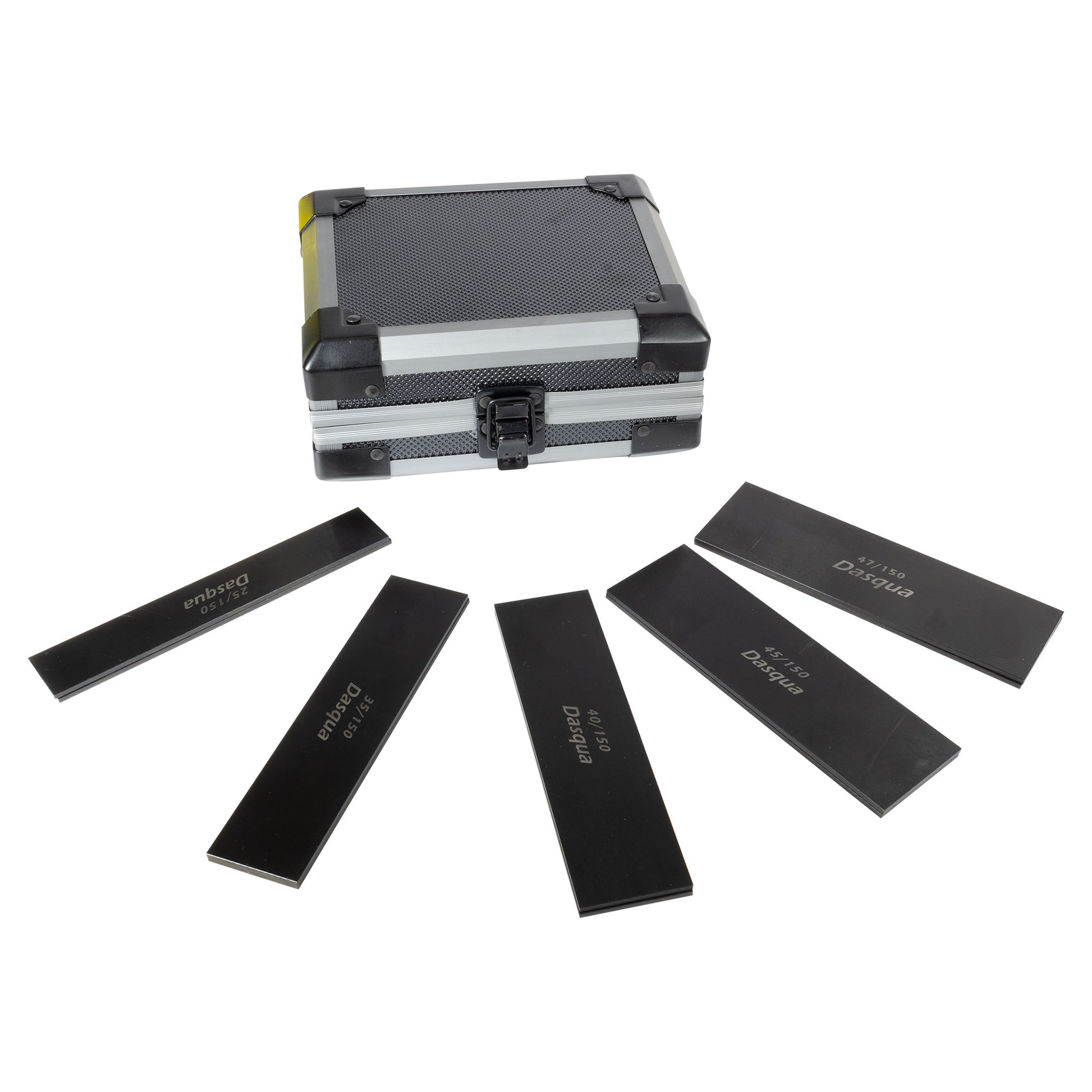

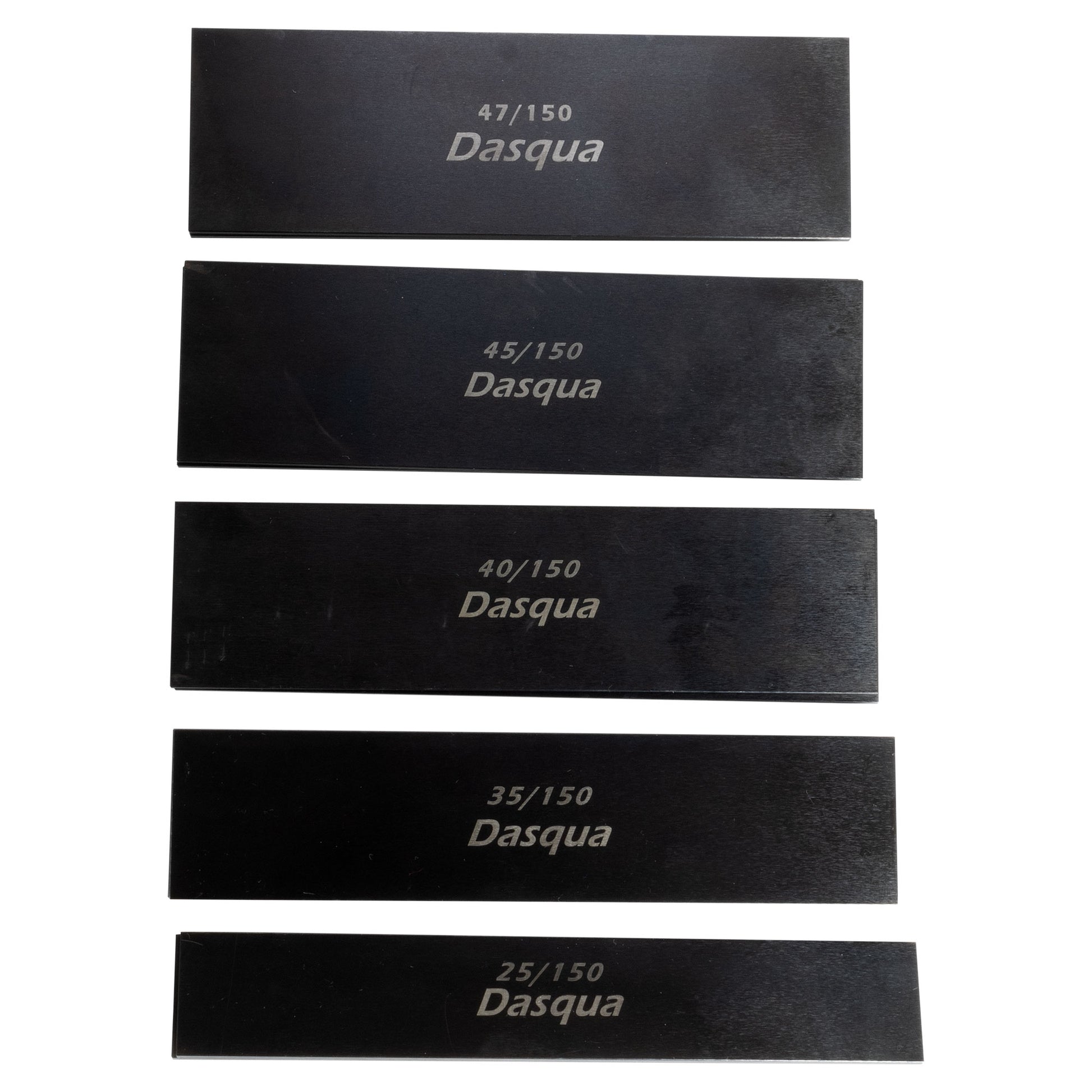

Set of five pairs of thin parallels. Each parallel is 150mm (6") long and 2.5mm (0.1") wide. The height of the parallels range from 25mm to 47mm in the following sizes: 25mm, 35mm, 40mm, 45mm, 47mm (1", 1.37", 1.57", 1.77", 1.85").
Made of high grade alloy steel, hardened to 55-60 Rc. The parallels have a height tolerance of +/- 0.005mm and a width tolerance of +/-0.01mm. Precision ground as pairs.
The parallels are magnetic to allow for easy placement which will reduce clamping time.

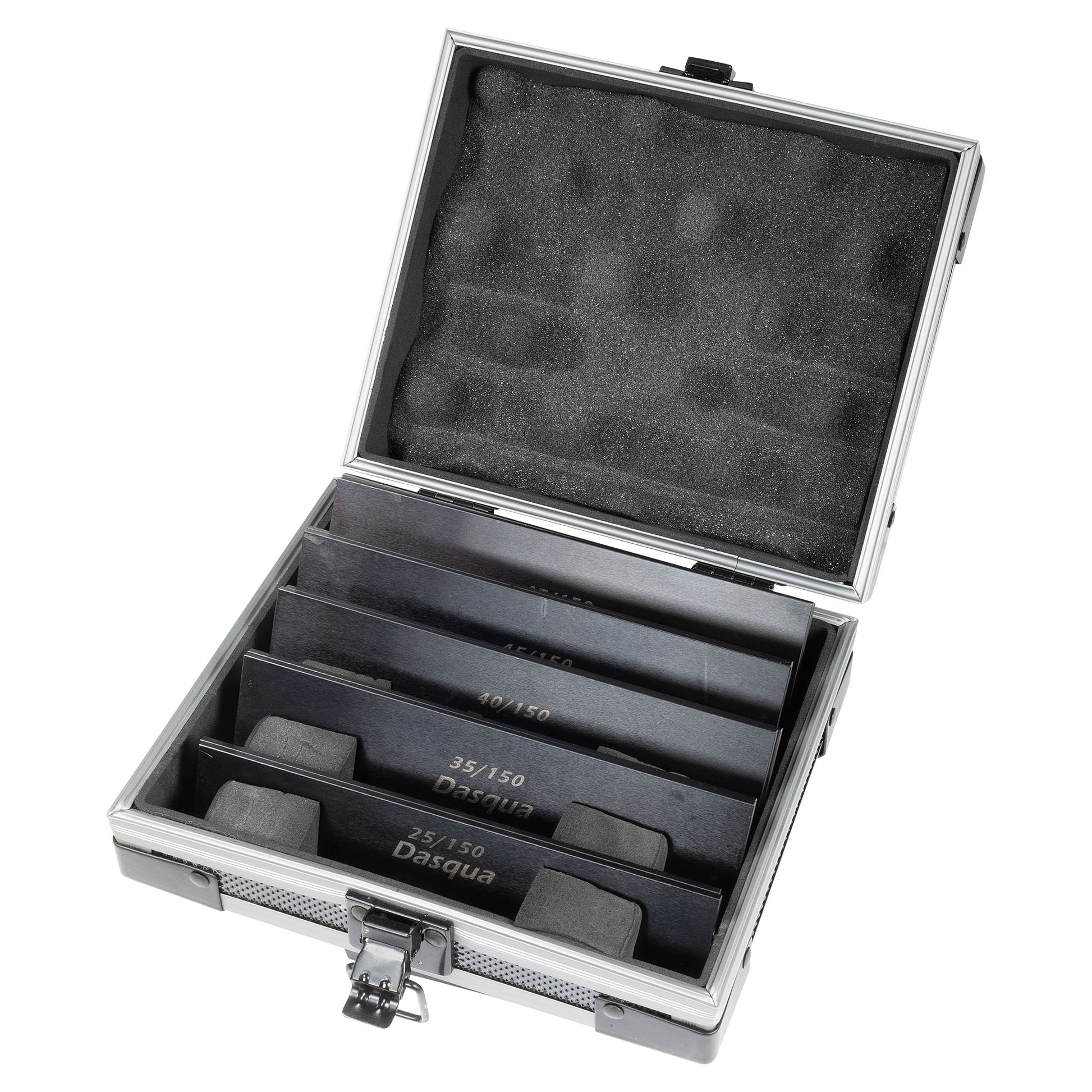

A sturdy case in included.
