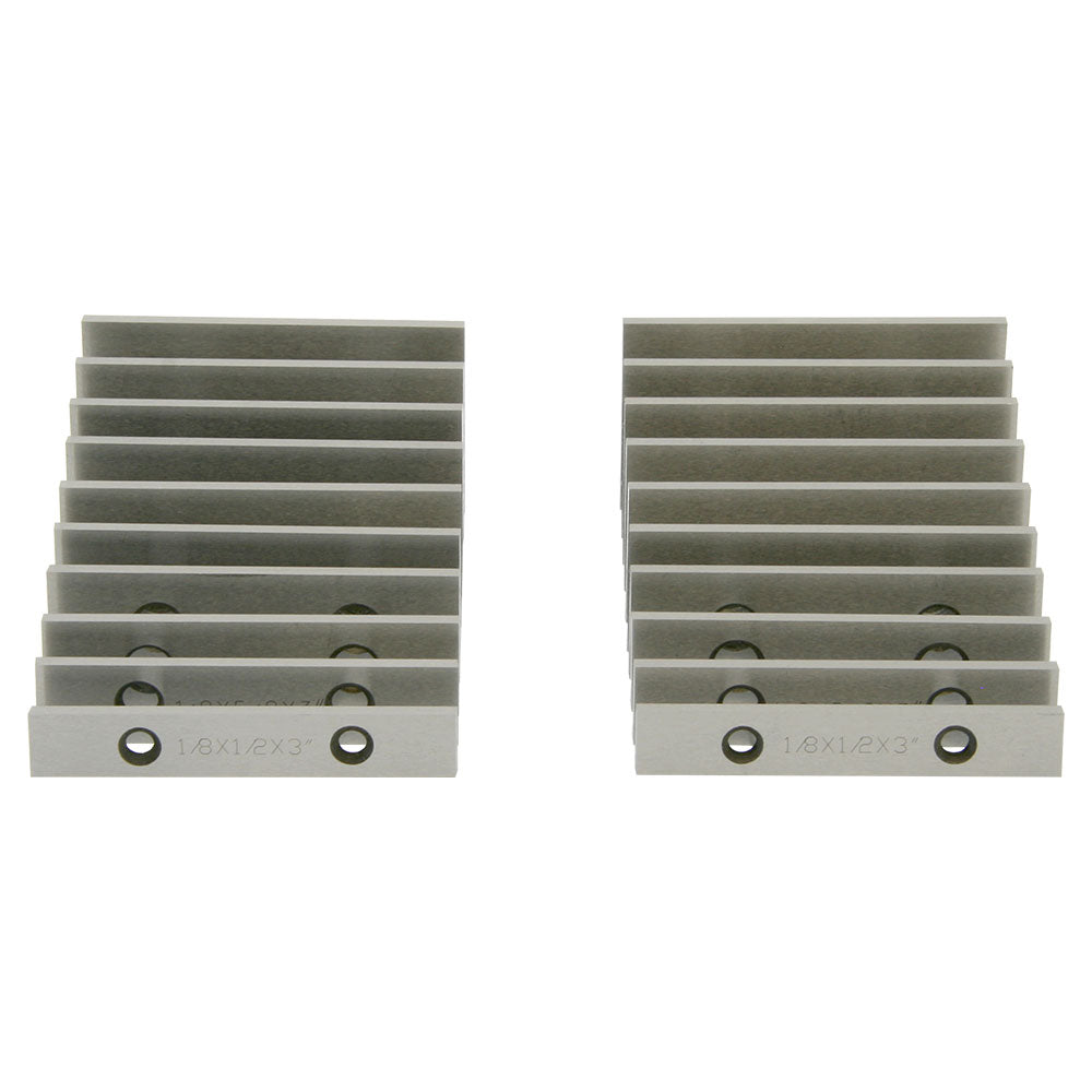

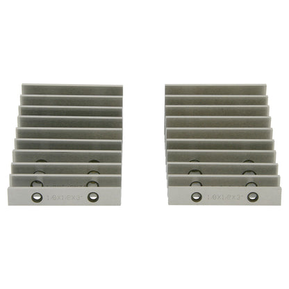

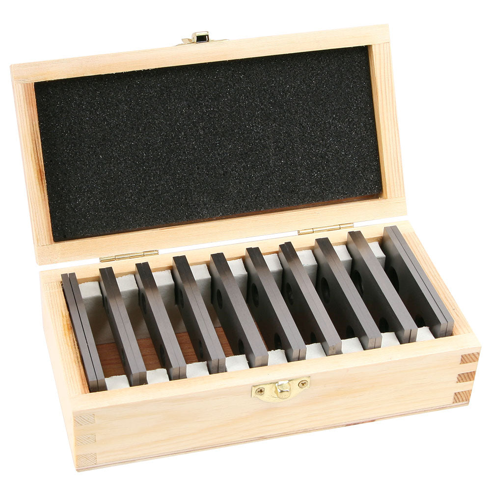

  • Set of ten pairs of 3" thin parallels in a fitted case
  • Parallels are 1/8" thick and 3" long
  • Heights are 1/2", 5/8", 3/4", 7/8", 1", 1-1/8", 1-1/4", 1-3/8", 1-1/2", and 1-5/8"
  • Made of high grade alloy steel hardened to 52 to 58 Rc
  • Parallel within 0.0002" on the top and bottom. The pairs are matched in height within 0.0004"
These 3" long thin parallels are great for the small vises used on the mini mill. The set includes ten pairs of parallels in a fitted case. Each parallel is 1/8" thick and three inches long. They are made of high grade alloy steel and hardened to 52-58 Rc. This set is tested to be parallel within 0.0002" on top of bottom and the pairs match in height within 0.0004".
Vise jaws are often too deep for the work. In general, you want the top of the work piece to extend above the top of the vise jaws. To fill the gap from the bottom of the work piece to the "ways" of the vise, you use parallels.
Parallels are strips of metal that have been carefully ground so that the top and bottom edges are parallel with very tight tolerances. They usually come in matched pairs. Place one parallel adjacent to each jaw in the vise and place the work piece so it rests on the parallels.
