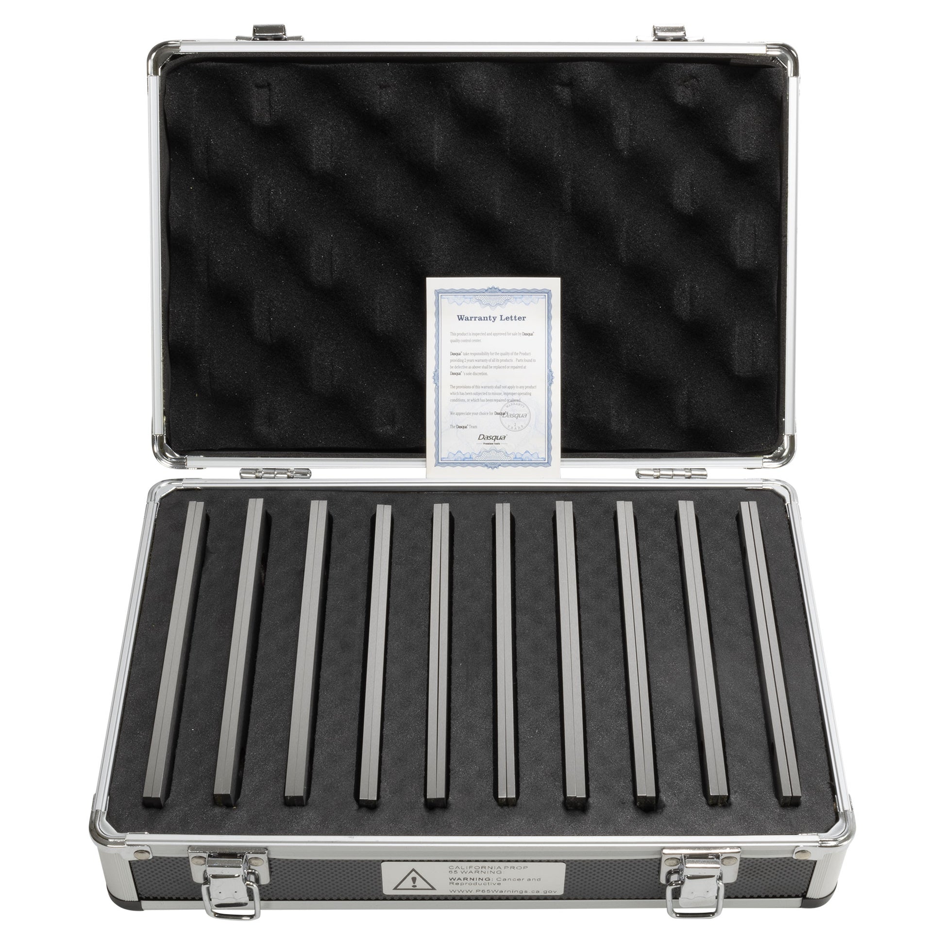

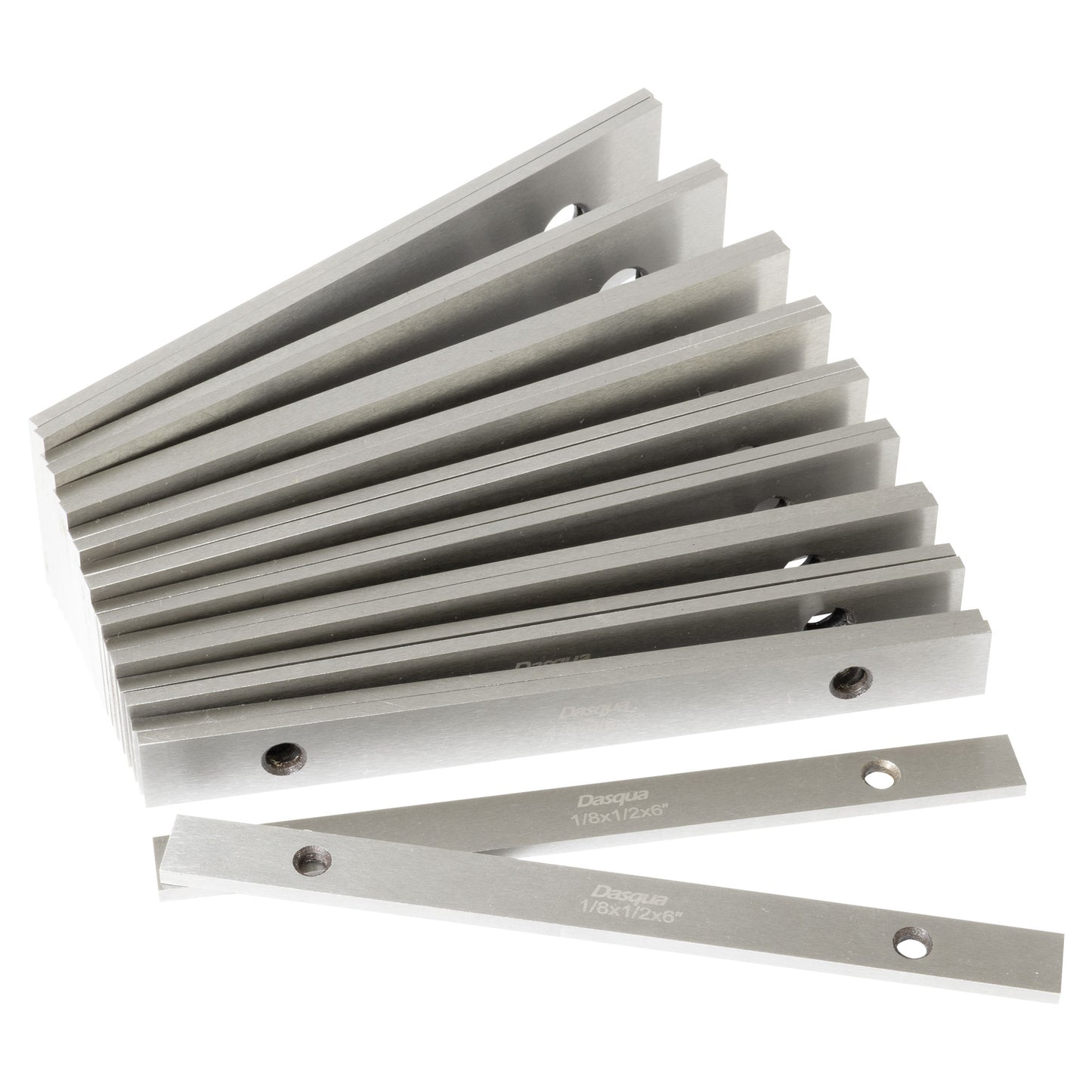

  • Set of ten pairs of thin parallels in a aluminum case
  • Parallels are 1/8" thick and 6" long
  • Heights are 1/2", 5/8", 3/4", 7/8", 1", 1-1/8", 1-1/4", 1-3/8", 1-1/2", and 1-5/8"
  • Made of premium alloy steel, hardened, stress-relieved, precision ground, in pairs
  • Highly perpendicular, parallel, and dimensionally accurate
Dasqua 1/8" X 6" 10 Piece Premium Parallel Set With Aluminum Case. Made of premium alloy steel, hardened, stress-relieved, precision ground, in pairs. Highly perpendicular, parallel, and dimensionally accurate. Edges are slightly beveled.
• Parallel within 0.0002" on the top and bottom. The pairs are matched in height within 0.0004"
• Height and thickness accuracy is ±0.0004".
• Superior surface finish is Ra0.4um/16uin with a hardness of HRC56-61 which provides a long service life.
• Made of high grade alloy steel hardened to 52 to 58 Rc
Matched pairs are marked with sizes. These parallels are convenient to use and maintain. Easy to use in drilling, milling and assembly work by providing a reliable and accurate position for the workpiece. Provided in a fitted aluminum case.

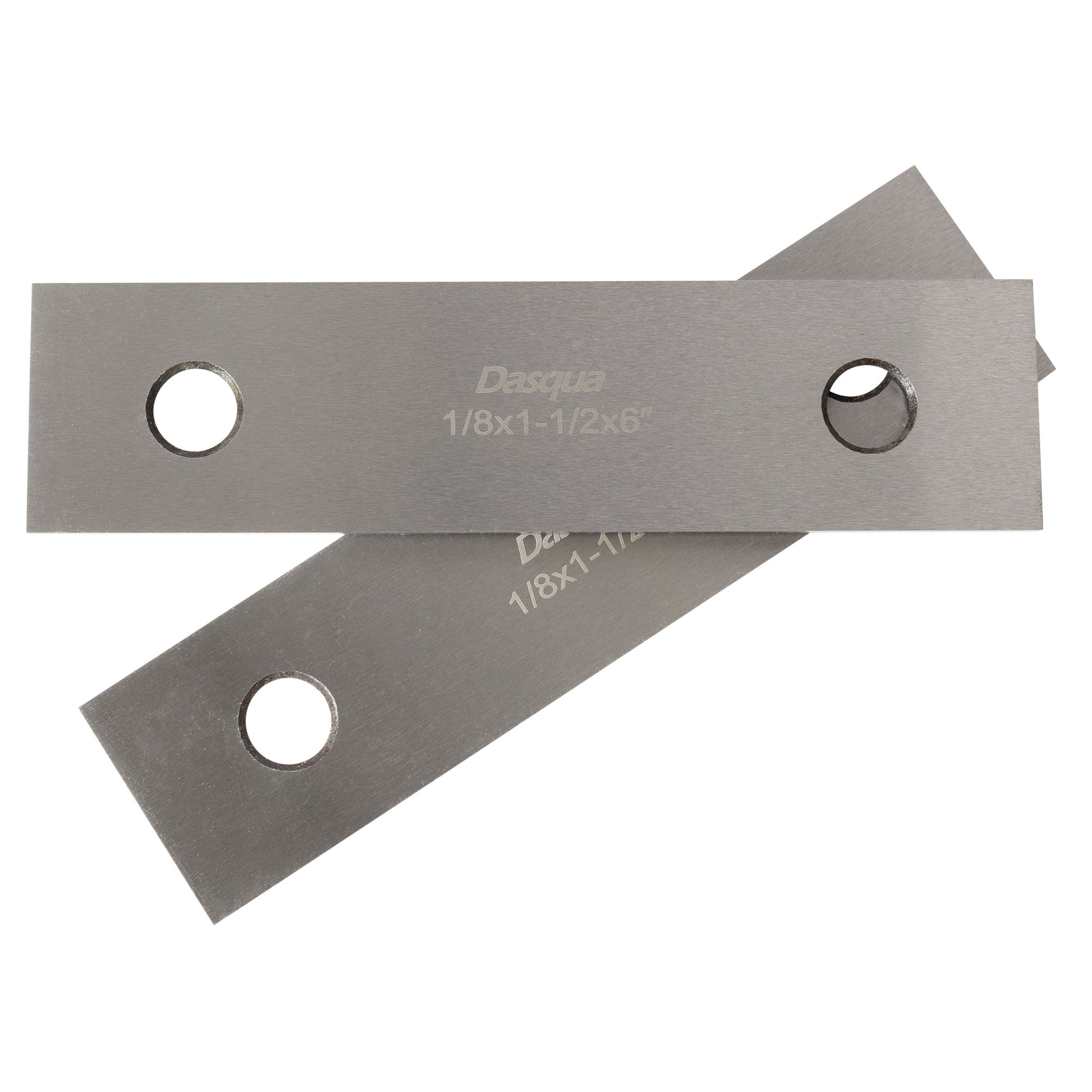

Vise jaws are often too deep for the work. In general, you want the top of the work piece to extend above the top of the vise jaws. To fill the gap from the bottom of the work piece to the "ways" of the vise, you use parallels.
Parallels are strips of metal that have been carefully ground so that the top and bottom edges are parallel with very tight tolerances. They usually come in matched pairs. Place one parallel adjacent to each jaw in the vise and place the work piece so it rests on the parallels.
