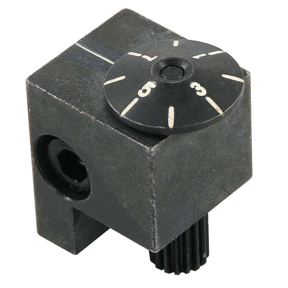

This kit includes all the parts needed to add a thread dial indicator for cutting inch threads to a mini lathe.
This dial assembly DOES NOT help you to cut inch threads on a metric lathe with a metric lead screw.
The threading dial tells you when to engage the half-nuts during threading. It turns when the half nuts are NOT engaged. IT DOES NOT TURN WHEN THE HALF NUTS ARE ENGAGED.
To cut true metric threads on a lathe with an Imperial (inch) lead screw (and vise versa) you can't just change the threading dial. You need a Metric Threading Kit which changes the leadscrew, half nuts and the threading dial.
Currently, there is no threading dial available for metric threading.
