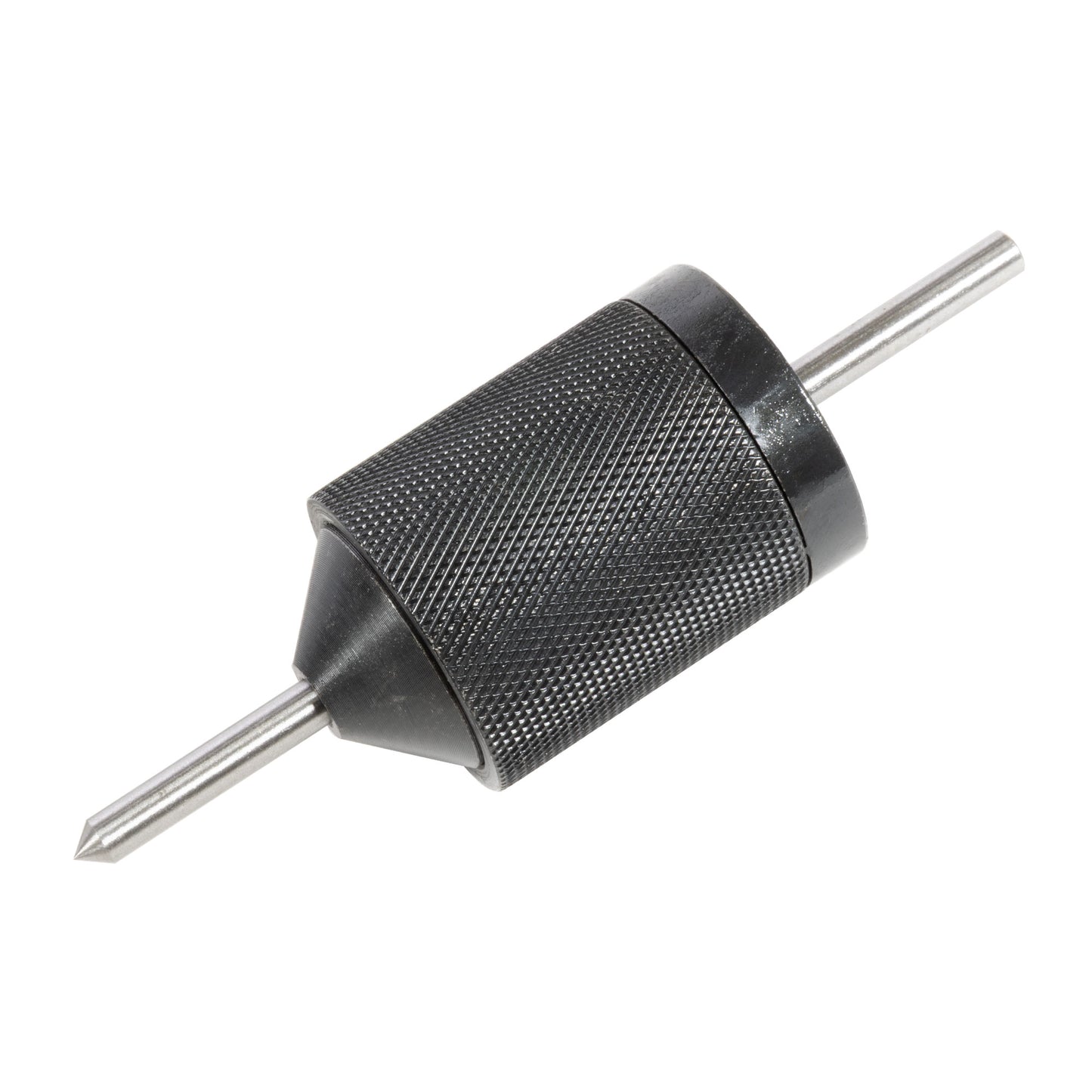

- Spring loaded
- Outer cup squares assembly
- Good for transferring centers using a template
Good for transferring hole centers using a template with varying hole sizes.

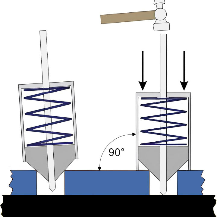

The alignment cone is spring loaded and slides in an outer cup which squares the whole assembly to the workpiece when pressed down on the template. The sliding center punch may then be struck to mark the workpiece.
- Punch diameter 4.75 mm
- Minimum hole size 10 mm
- Maximum hole size 26 mm
