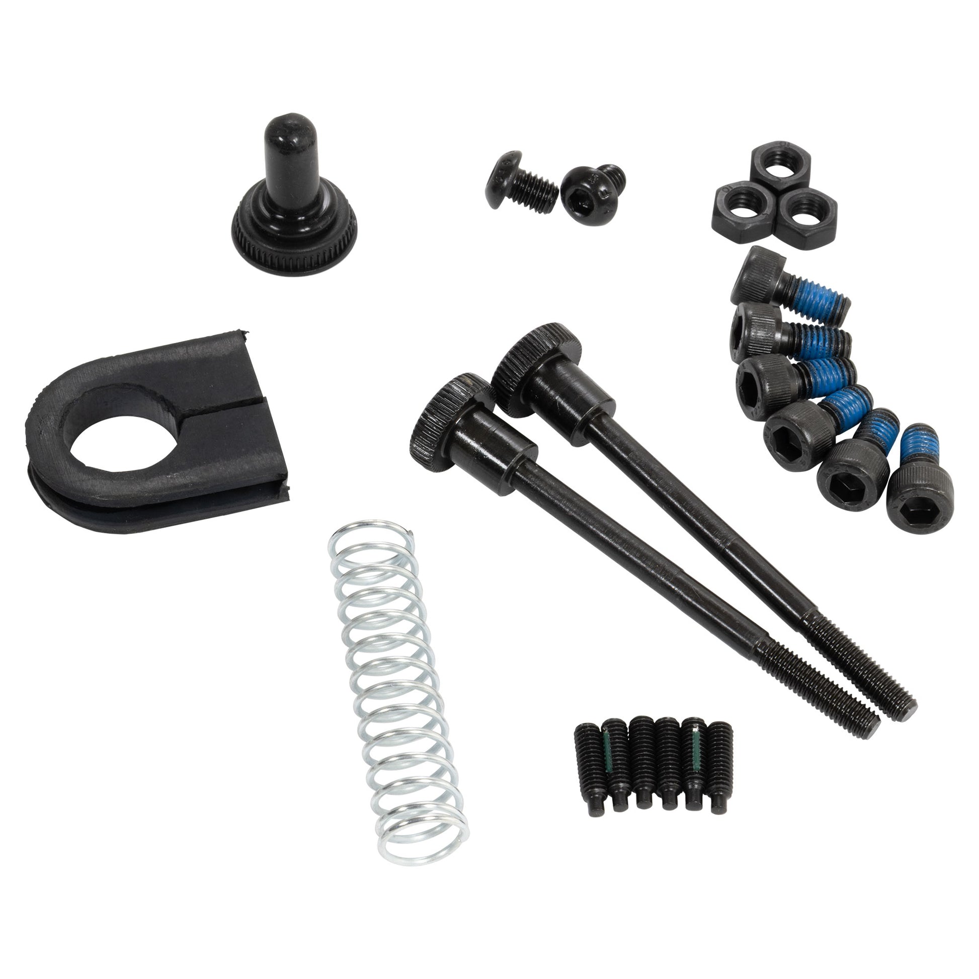

The Mini Lathe Tweaks & Enhancements Kit™ can make a big difference in the operation of your mini lathe.
The kit includes the following:
-Hardened lathe chuck mounting nuts for long life.
-Self locking set screws for the cross slide and compound rest gibs
-Self locking cap screws for the carriage retainers
-Button-head cap screws for the cross slide and compound rest crank handles.
-Thumbscrews for the change gear cover.
-A spring for the tailstock clamp.
-A rubber boot to protect the F/O/R switch on 7x10 and 7x12 mini lathes.
-A rubber guard to prevent chips from getting into the motor speed control enclosure.
-Complete instructions
