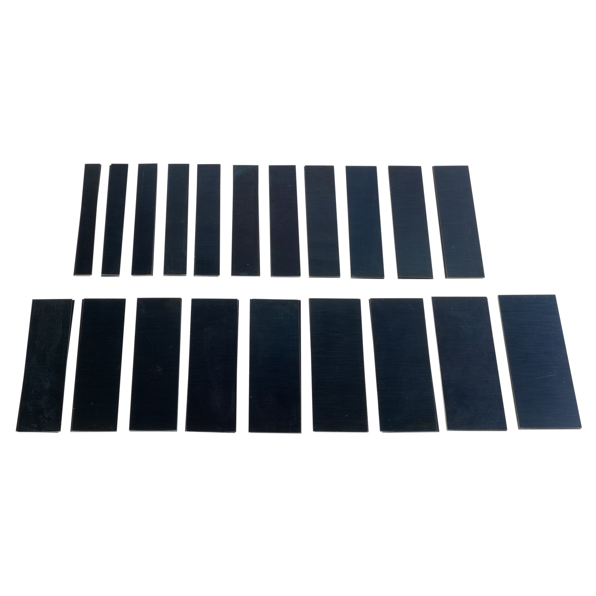

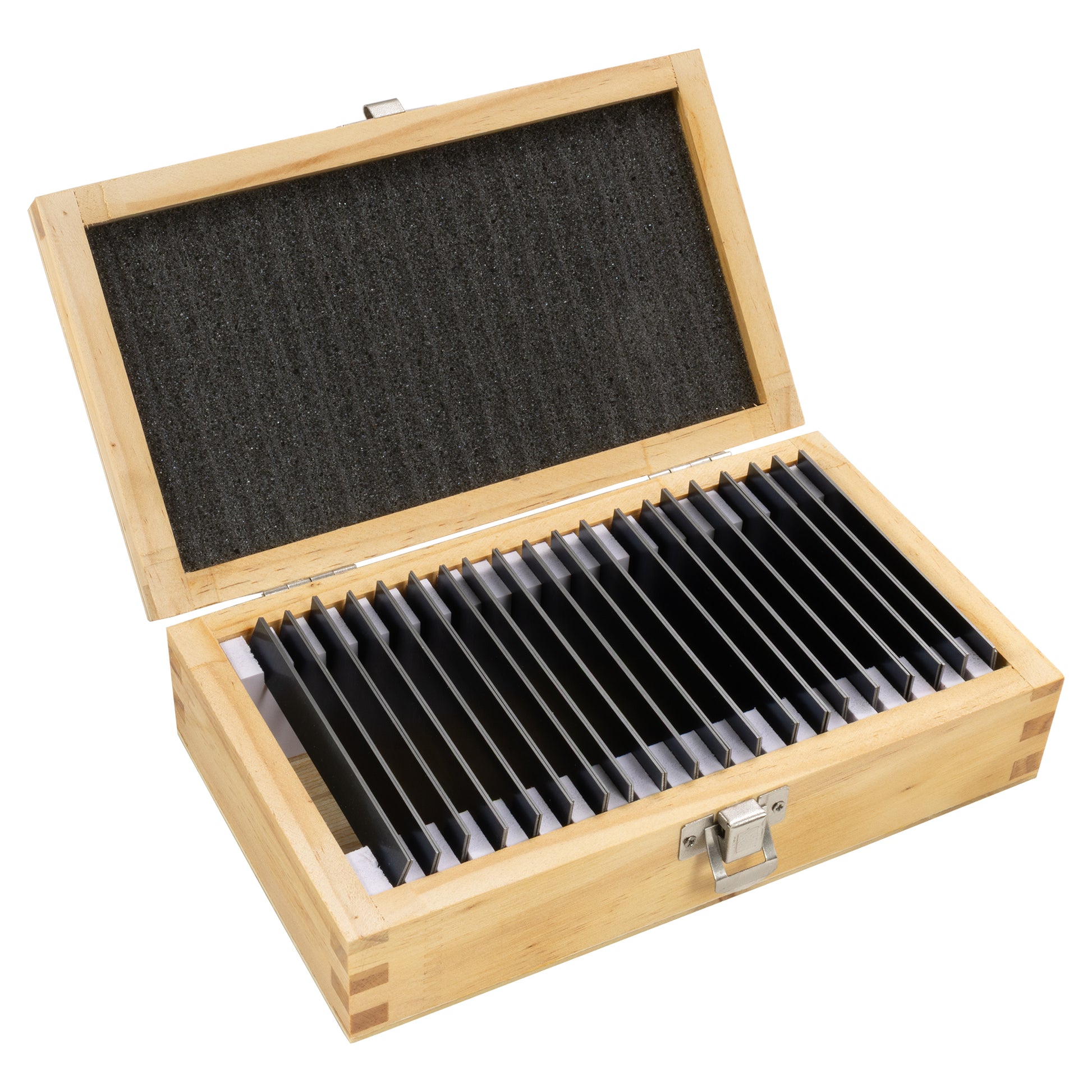

  • Set of 20 pairs of ultra thin parallels in a fitted case
  • Machinist parallels are 1/32" thick and 4" long
  • Heights are 1/2" to 1-11/16" in 1/16" steps
  • Made of high grade steel hardened to 50-55HRc
  • Accuracy: Height ±0.0001", Thickness ±0.0001"
  • Used in pairs: ±0.0001" (height/thickness)
20 Pairs Ultra-Thin Parallels. These parallels are 1/32" x 4" which makes them ideal for precision setup and work holding when standard parallels are too thick.
Made of high-quality steel, stress relieved to prevent distortion and hardened to RC 50-55.
Parallels are precision ground for accuracy to parallelism of +/-0.0001".
The heights of the parallels are: 1/2", 9/16", 5/8", 11/16", 3/4", 13/16", 7/8", 15/16", 1", 1-1/16", 1-1/8", 1-3/16", 1-1/4", 1-5/16", 1-3/8", 1-7/16", 1-1/2", 1-9/16", 1-5/8", and 1-11/16".
These ultra thin parallels are great when you need to drill holes near the edge of your workpiece because they are only 1/32" thick.
