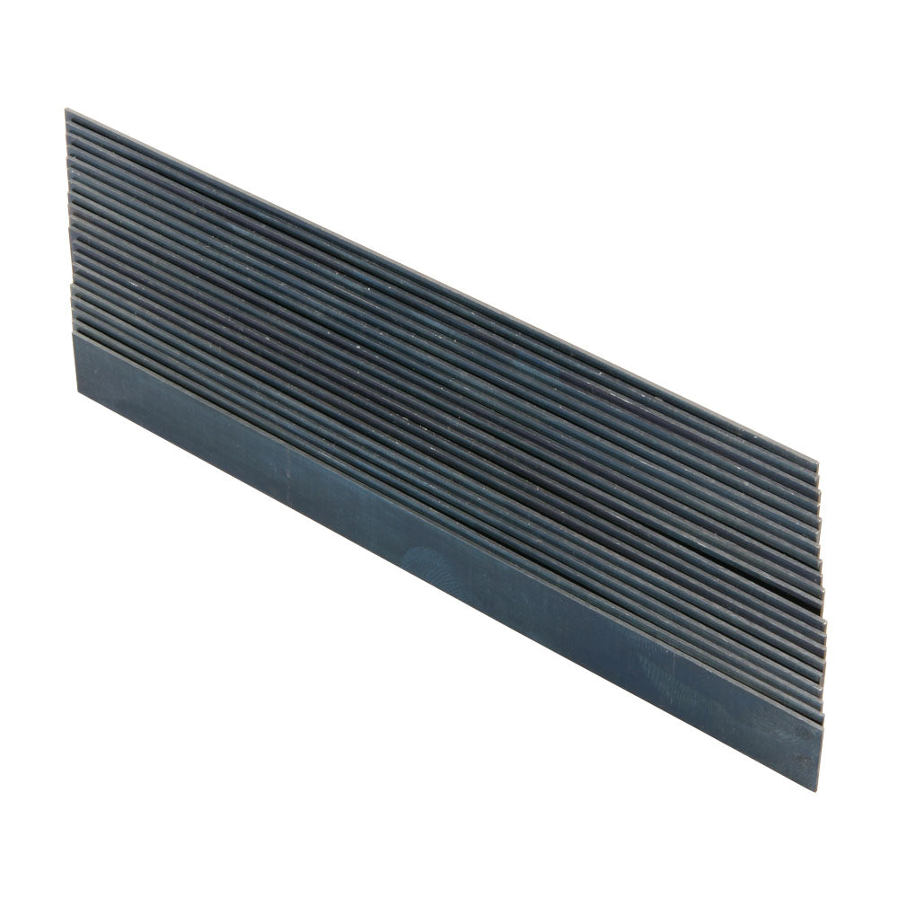

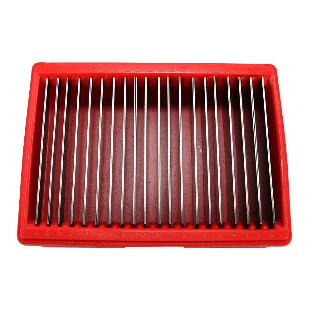

  • Set of 20 pairs of ultra thin parallels in a fitted case
  • Machinist parallels are 1/32" thick and 6" long
  • Heights are 1/2" to 1-11/16" in 1/16" steps
  • Made of high grade alloy steel hardened to 50 Rc
  • Parallel within 0.0001" on the top and bottom. The pairs are matched in height within 0.0001"
The heights of the parallels are 1/2", 9/16", 5/8", 11/16", 3/4", 13/16", 7/8", 15/16", 1", 1-1/16", 1-1/8", 1-3/16", 1-1/4", 1-5/16", 1-3/8", 1-7/16", 1-1/2", 1-9/16", 1-5/8", and 1-11/16".
These ultra thin parallels are great when you need to drill holes near the edge of your workpiece because they are only 1/32" thick.
The 1/16" steps give you lots of options when working on thin pieces.
