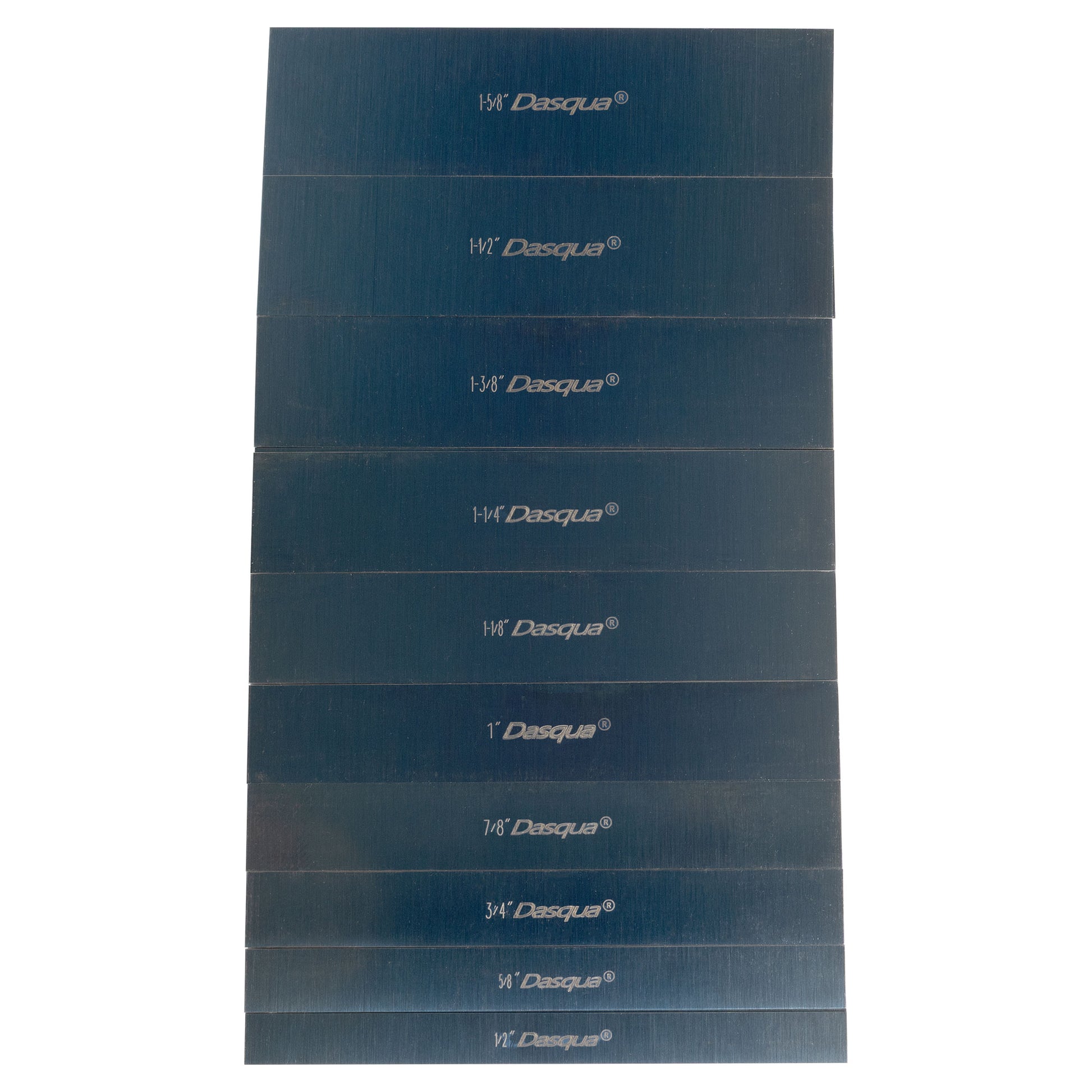

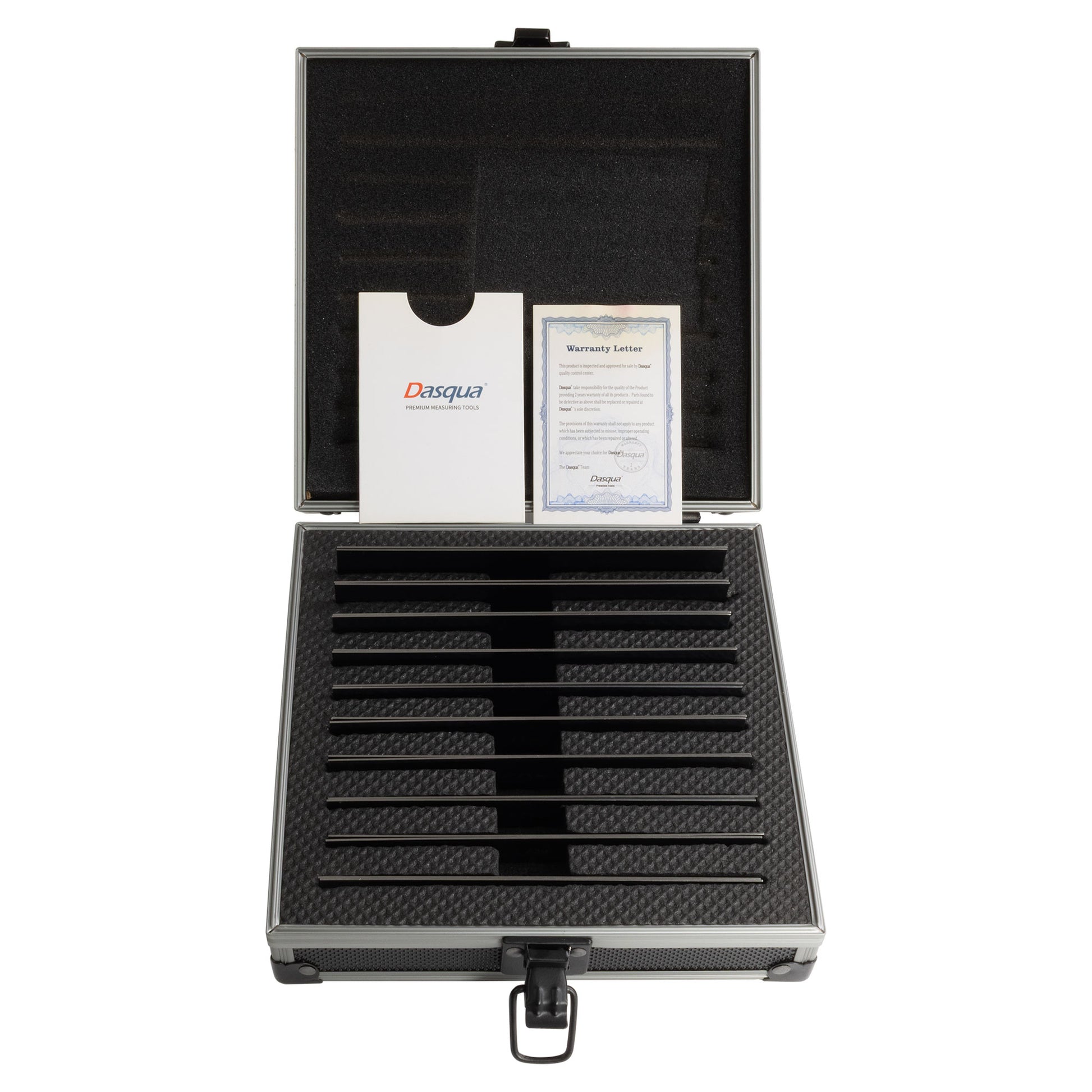

  • Set of 10 pairs of ultra thin parallels in a fitted case
  • Machinist parallels are 1/32" thick and 6" long
  • Heights are 1/2" to 1-5/8" in 1/8" steps
  • Made of high grade alloy steel hardened to 56-61 HRc
  • Accuracy: Height ±0.01mm, Thickness ±0.01mm
  • Used in pairs: ±0.01mm (height/thickness)

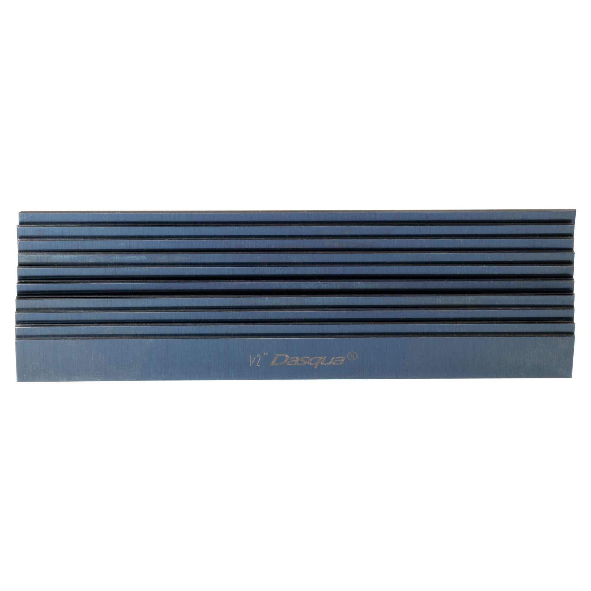

10 Pairs Precision Ultra-Thin Parallels made of premium alloy steel, hardened, stress-relieved, and precision ground. Superior surface finish: Ra0.4um, high hardness: 56–61HRC, long service life. Edges are slightly beveled.
High perpendicularity, parallelism, dimension accuracy.
  • Height ±0.01mm
  • Thickness ±0.01mm

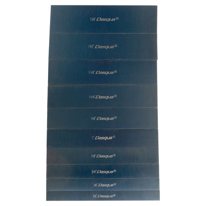

The heights of the parallels are: 1/2", 5/8", 3/4", 7/8", 1", 1-1/8", 1-1/4", 1-3/8", 1-1/2", and 1-5/8".
Convenient to use and maintain during the drilling, milling, assembling work, convenient to clamp workpiece, and provide the reliable and accurate position for workpiece
These ultra thin parallels are great when you need to drill holes near the edge of your workpiece because they are only 1/32" thick.
The 1/16" steps give you lots of options when working on thin pieces.
